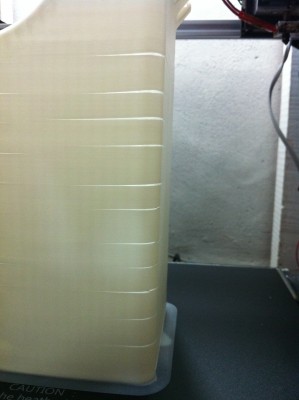

The layers are splitting when I print ABS with a z height of more than about 10mm, see photo.
I have a Folger FT5 and am printing with a heated bed at 100°C and a 0.4mm nozzle at 240°C (up from 230°C) and layers at 0.25mm
Print speed is 60mm/sec. with the initial layer at 30mm/sec.
I use a brim of 8mm.
I have tried 2 different makes of ABS, both with the same result.
It is in an enclosure, although a bit crude, so it is not affected by drafts etc.
Does anybody have any suggestions, it's driving me mad having to repair every print.
Thanks
Splitting!
Splitting!

I'd be curious how well that enclosure is maintaining the temp needed to print ABS Maybe a thermometer inside?
Posts: 457
Location: Spain
Re: Layer splitting with ABS
Post by Lez0 »
I have put a thermometer inside and it get's up to the high 30's, perhaps I need to plug the small gaps.

IMHO, 240C is on the lower edge for ABS. Try to up it to 260C and make thicker walls if possible.
Lower the speed to see if it makes an impact.

Square boxes are fundamentally very difficult or often even impossible with ABS when you don't have an actively heated chamber, just as the picture you posted shows.
I had this result too a few times and it is simply about that the stress from the relatively large shrinking when ABS cools will be concentrated in the corners of a square object.
Cylindrical objects of the same size generally prints fine, so if I for some reason want to print a large box with sharp corners I simply don't use ABS, while for cylindrical objects ABS is just fine.

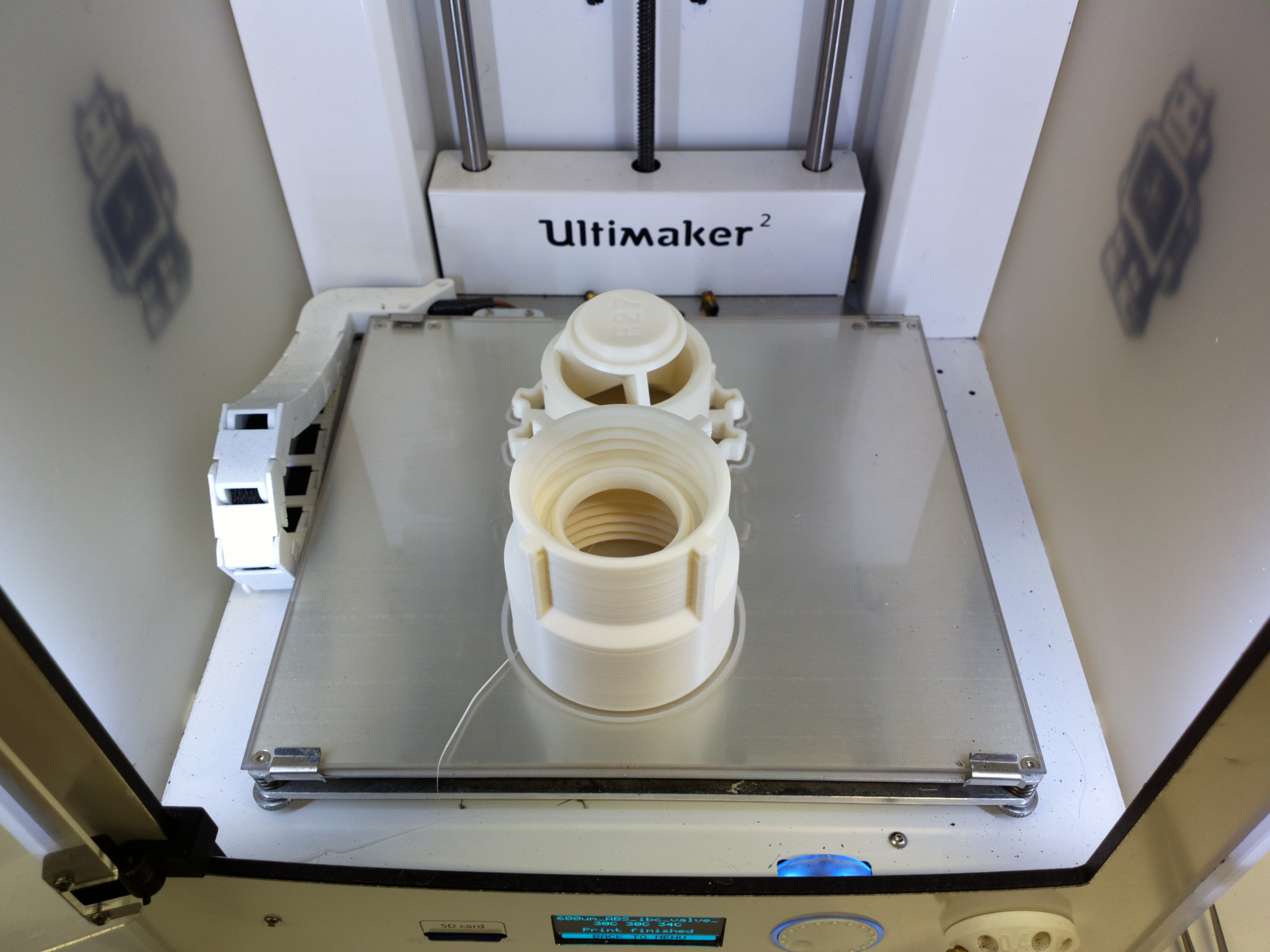

Here is an example of an object I made recently that prints excellent in some dirt cheap ABS (at 50 mm/s, 0.25 mm layer height, 255 C / 90 C with 0.6 mm nozzle)
Here is another one, even larger, printed with 0.8 mm nozzle and 0.3 mm layer height if I remember correctly.
As you can see the objects above have in common that they are cylindrical which gives an even distribution of the stress from the shrinking.

What you say makes sense. I have bought another make of ABS and it prints a lot better at the same settings 100°C bed 240°C nozzle.
I have no problem with the ABS sticking to the bed as I have a plastic type mat that works, sometimes too well as I can have great difficulty getting the parts off the bed.
So as you say some makes are better than others. One problem with the better printing ABS is it's not pure black it has a slight blue tint to it. I can live with this tint if the prints are strong and good.
