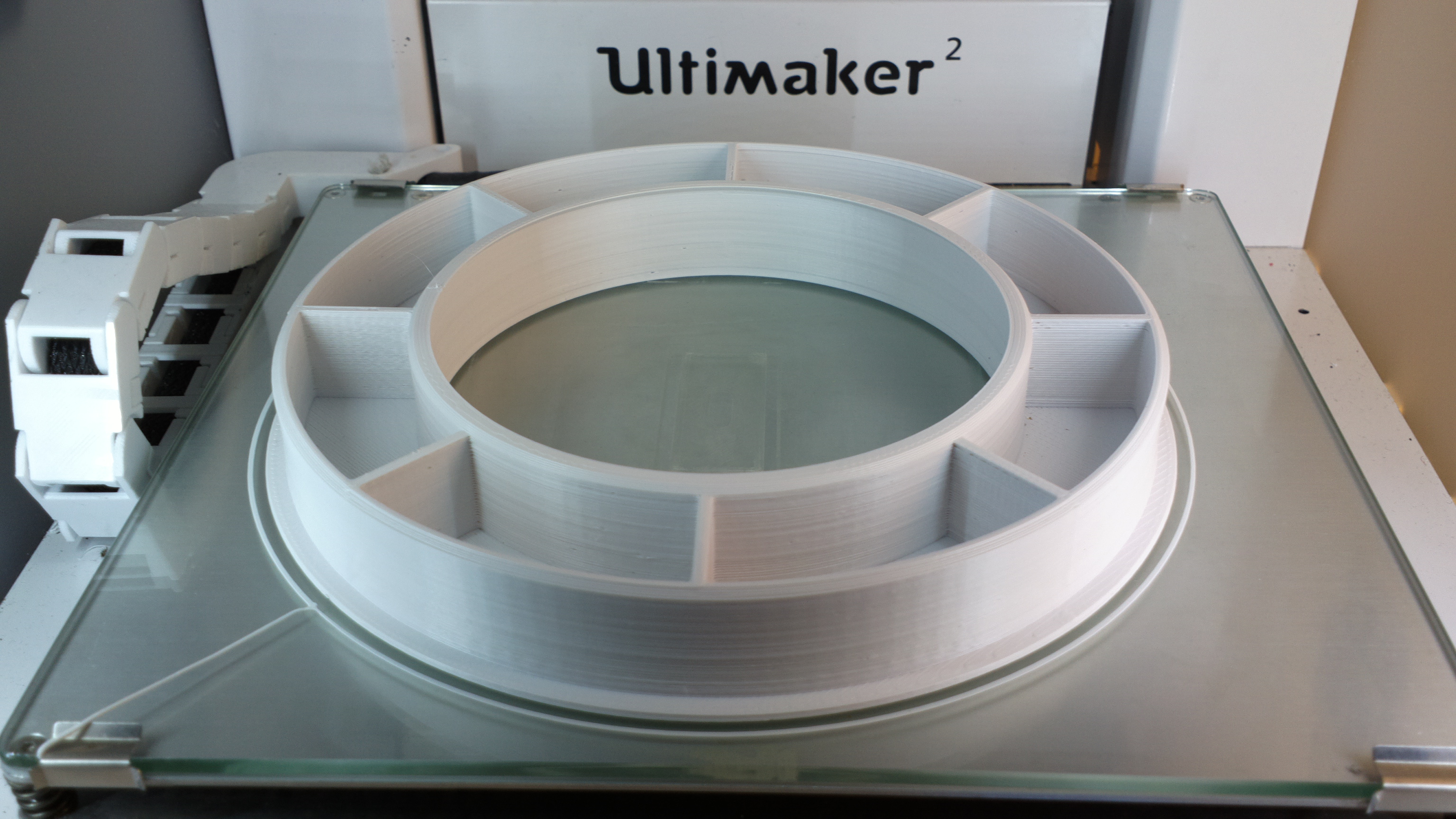

Square boxes are fundamentally very difficult or often even impossible with ABS when you don't have an actively heated chamber, just as the picture you posted shows.
I had this result too a few times and it is simply about that the stress from the relatively large shrinking when ABS cools will be concentrated in the corners of a square object.
Cylindrical objects of the same size generally prints fine, so if I for some reason want to print a large box with sharp corners I simply don't use ABS, while for cylindrical objects ABS is just fine.
Here is an example of an object I made recently that prints excellent in some dirt cheap ABS (at 50 mm/s, 0.25 mm layer height, 255 C / 90 C with 0.6 mm nozzle) Here is another one, even larger, printed with 0.8 mm nozzle and 0.3 mm layer height if I remember correctly. As you can see the objects above have in common that they are cylindrical which gives an even distribution of the stress from the shrinking.

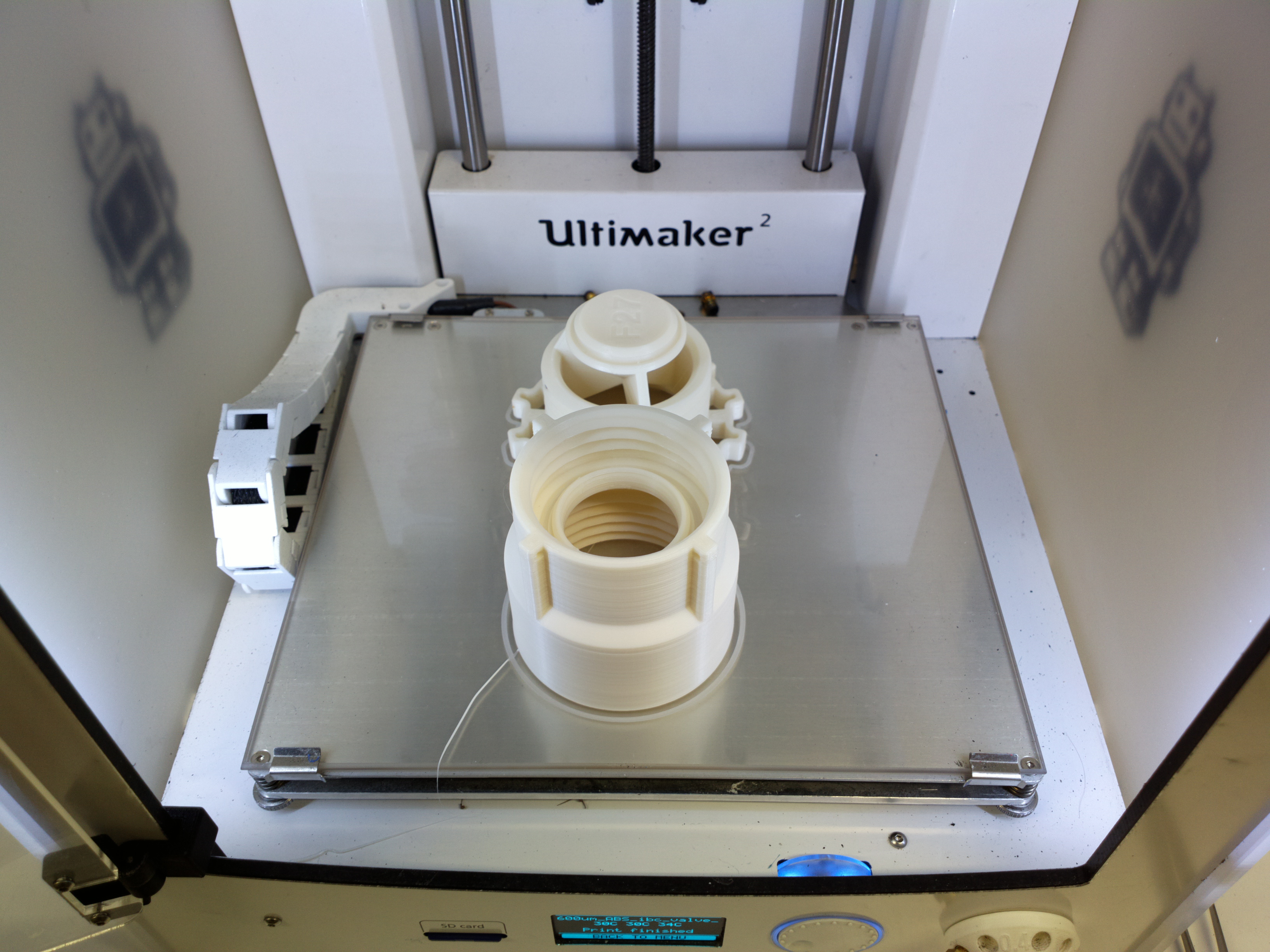

Well I have done a few parts in PETG, some aren't perfect but better than ABS.
This part below is 180mm tall. As you can see at the top it started to print better for some reason. I'll have to play with the settings to get a better part but the first results look good, at 240 nozzle 80 bed 0.25 layers at 60mm/sec, no supports, retraction 6.5.
