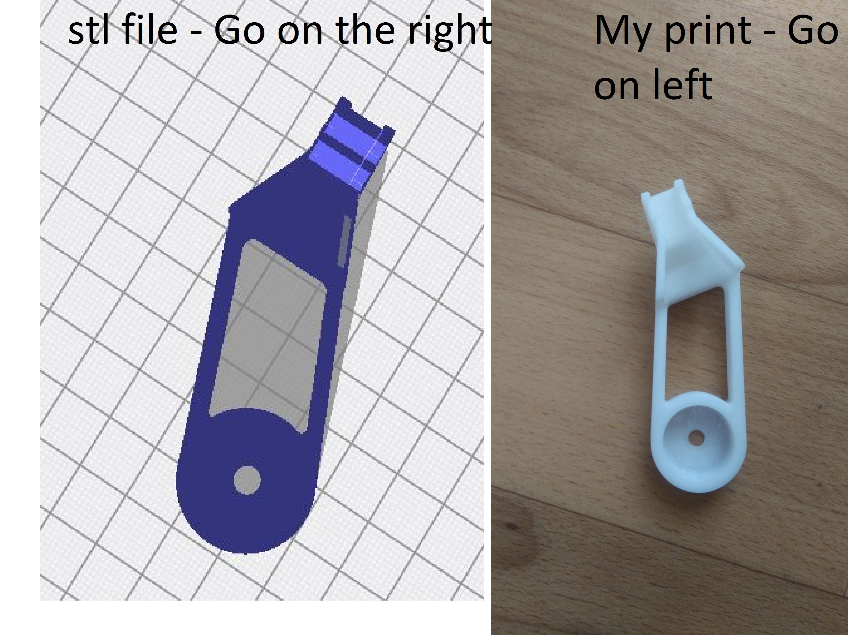

Hi everybody,
I have a Creality Cr-10 and i'm using Cura 3.4.
Each print i'v done is printing with a "mirror effect" , my print doesn't look like my orginal STL File.
It's like the left side is print like the right side. See attached my stl file and my print.
Do you know what happened?
Tanks

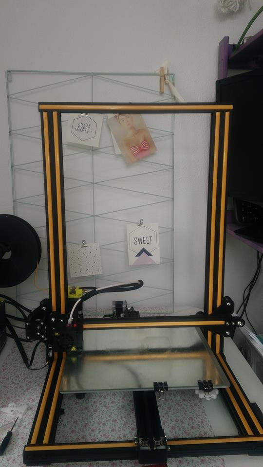

Can you post a picture of your assembled 3D Printer.
Creality Cr-10 Printers come programmed. The only way I know to mirror the print. Would be to invert the X-Z-Axis assembly structure.
should look like this

Re: Creality is printing with mirror effect
Post by hippolyte50 »
It's look like your picture.

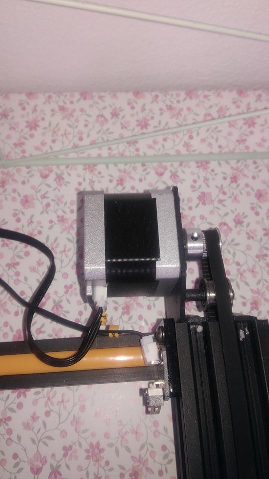

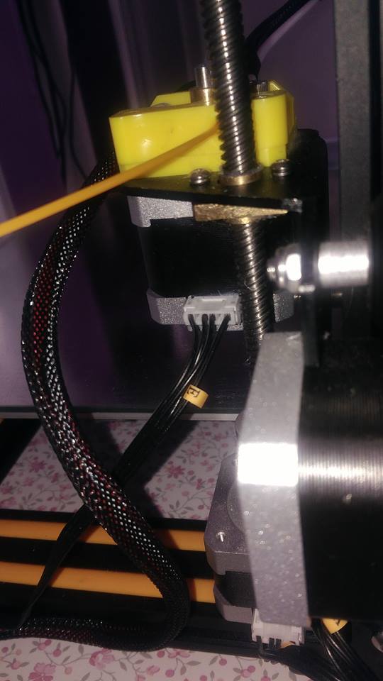

Looking at the Bottom picture it appears that you have the Y-Axis connectors connected to the X-Axis.
The next picture up from the bottom shows that the Y-Axis connector has the X-Axis connectors attached.
Unless somehow they have been mislabeled
You are so right. I did a big mistake.
Now everything is working well, thank you very much for your answer and for your time.
