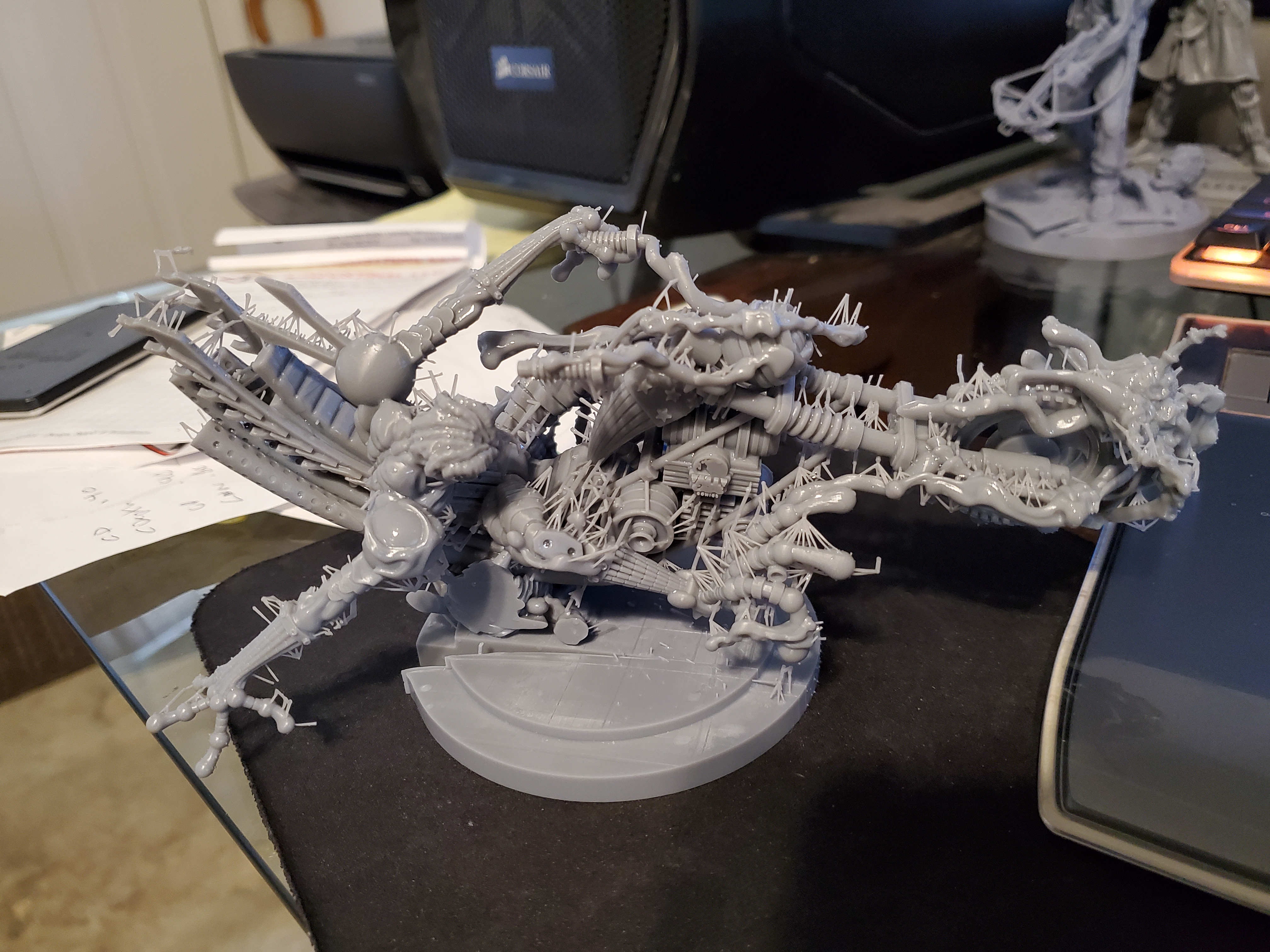

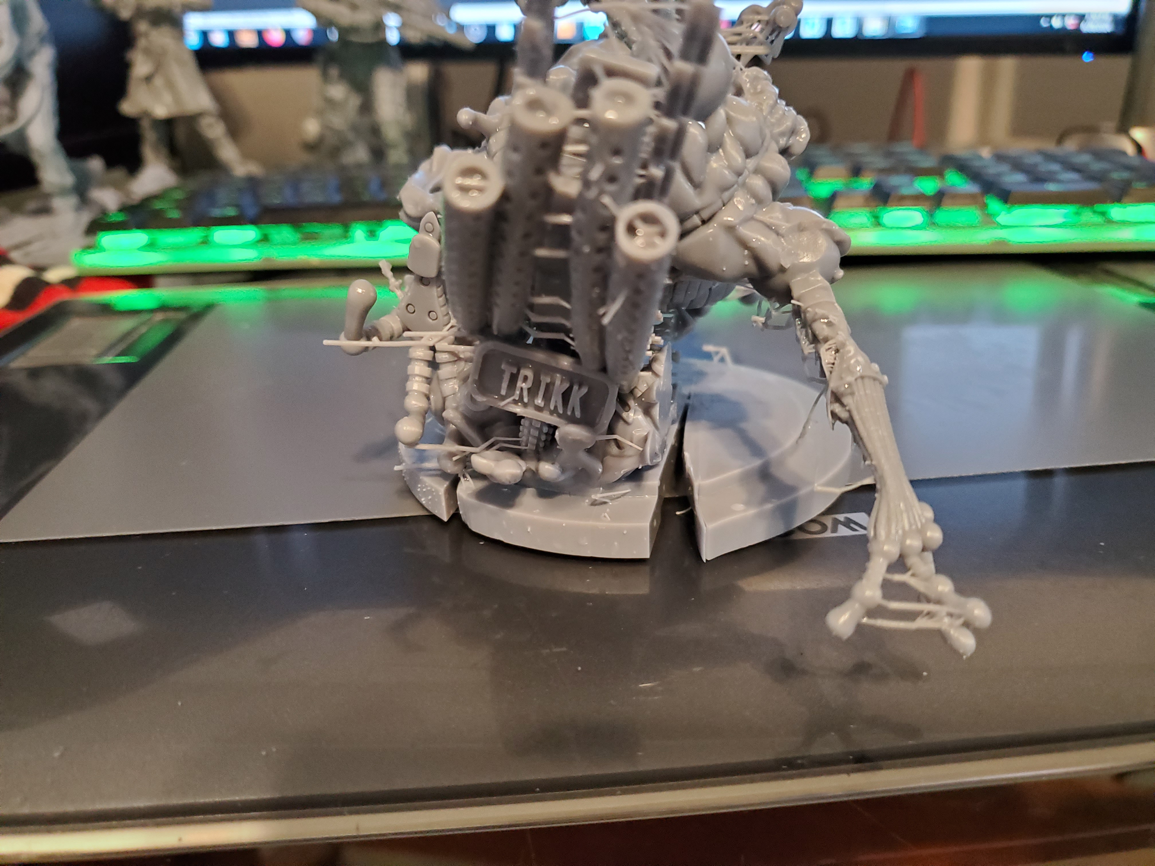

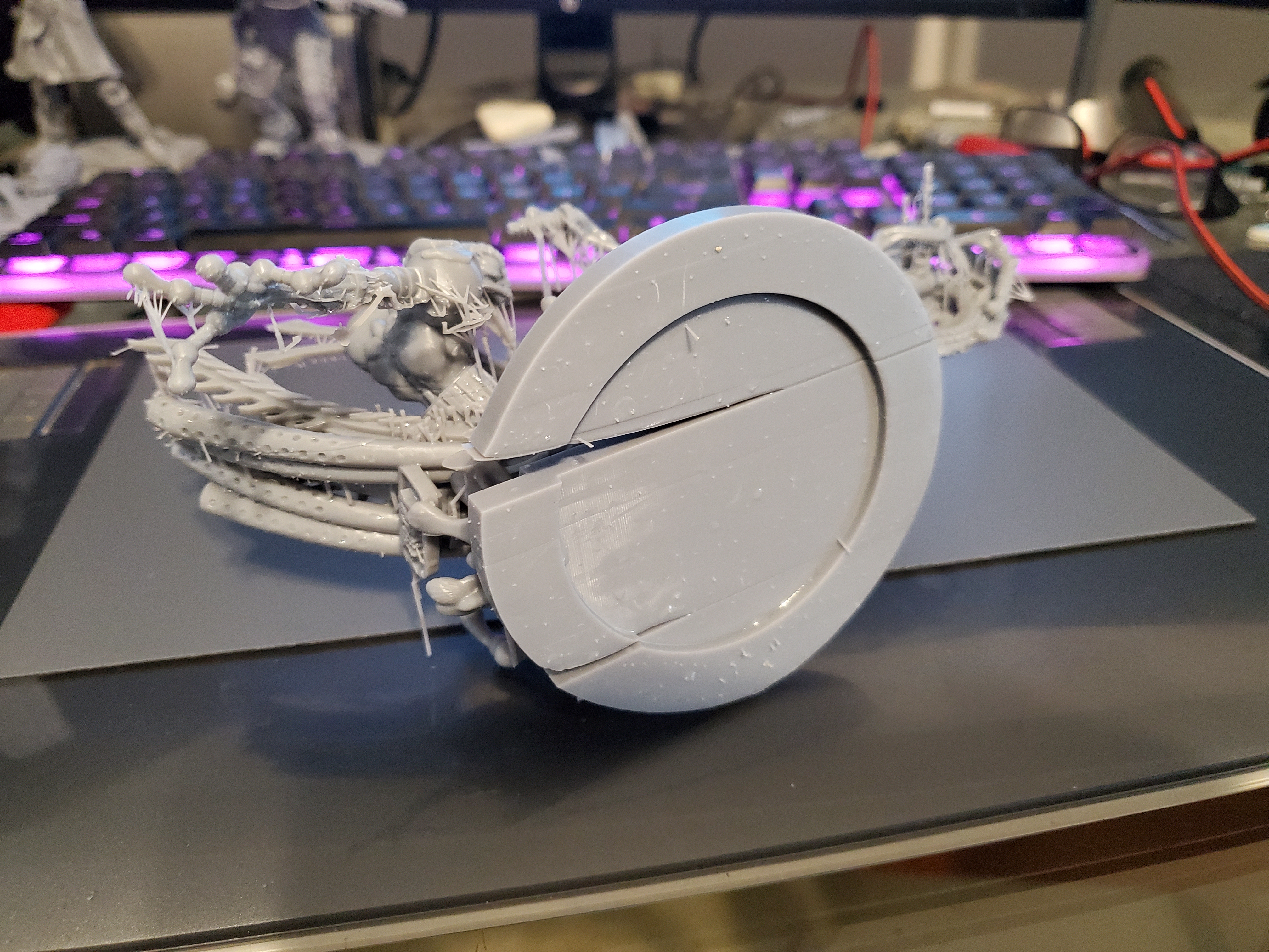

I'm getting a huge Crack thru the base of the Print
any insights or advice is appreciated.

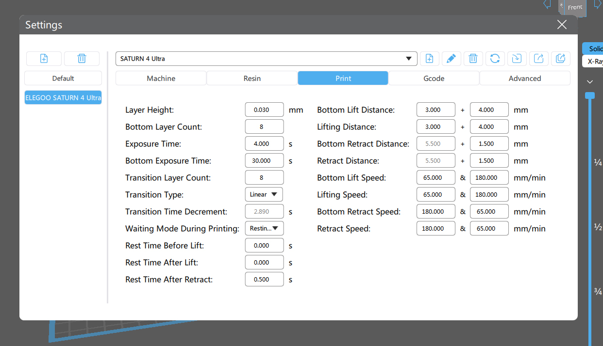

i ended up increasing the lift distance a bit.. the next print was flawless.

so far i've found that speed wise there is a def difference. tho the lift speed is too fast for my supports and they get pulled apart
