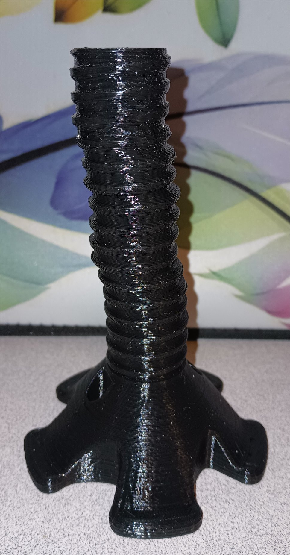

Massive layer shift have not seen layer shift like this sense I started 3D Printing 7 years ago.
Below is a photo of the result.
Well I started a well needed complete maintenance and every thing works fine now.
And my printers, filament were in a drafty old garage, thought it appears all still works.
I started back decided not to do a full maintenance just added a little lube and started printing.
Well it went well for about half a dozen large models then it happened.
