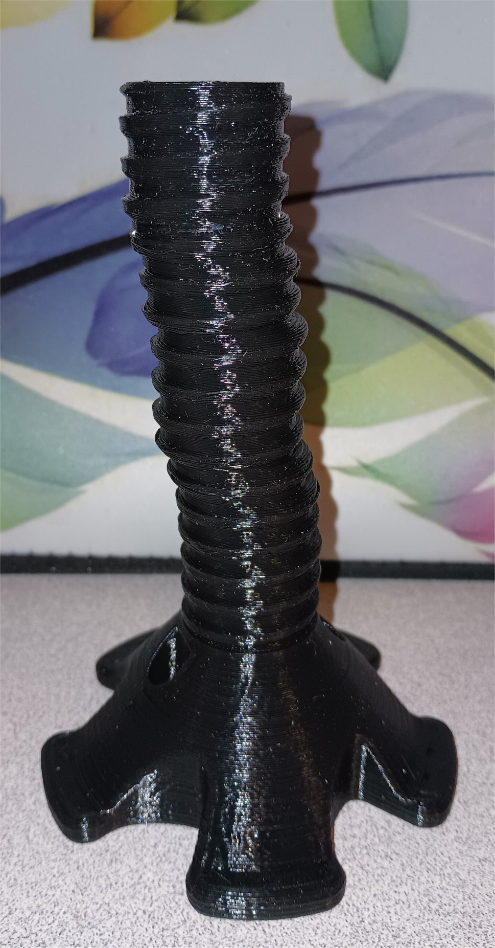

Massive layer shift have not seen layer shift like this sense I started 3D Printing 7 years ago.
Below is a photo of the result.
Well I started a well needed complete maintenance and every thing works fine now.
And my printers, filament were in a drafty old garage, thought it appears all still works.
I started back decided not to do a full maintenance just added a little lube and started printing.
Well it went well for about half a dozen large models then it happened.

Just looking at that photo, it could be a few things, db.
If the first layers went down well, then failed a few up, it could be...
1) Filament tangle
2) Partial clog
3) Acts of God =)
220C for PLA is on the very high end. Having the fan off is pretty unusual to me. I have fan off at layer 1, 50% at layer 2 then 100% throughout the print. If you are using a 0.4 nozzle, I'd be pretty surprised you are at 220C - but - if you did some basic calibrations and a temperature tower that shows that is the ideal temp, so be it! (I usually only have to go that high for larger nozzles)
To take some guess work out of this, I'd suggest two things. Same to Robert. Calibrate!
Check this link to great tutorials and explanations of what each process will do.
https://teachingtechyt.github.io/calibration.html
Also, I would suggest drying your filament before use and storing in air tight containers. PLA generally isn't very hygroscopic (pulls in moisture) but the additives each makers uses can be. It's just one more thing to rule out. (I also find less failures if you dry before use. Filament isn't cheap, do what you can to maximize what you have!)
