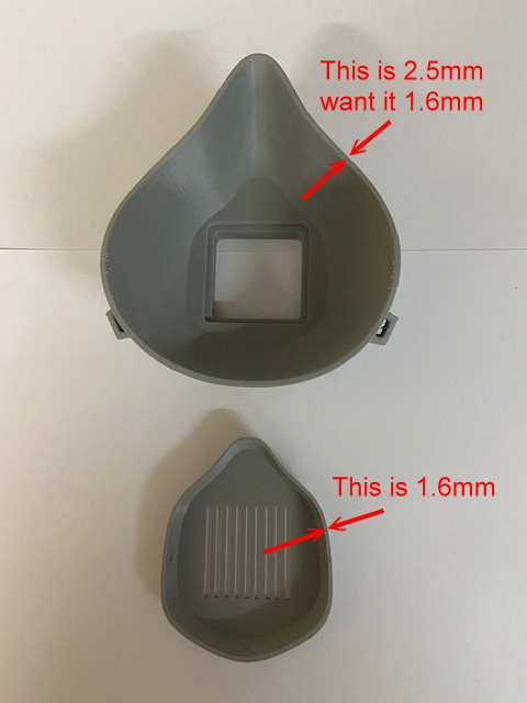

I have been trying to get the walls thin on items for quite a while. If I print the vase that comes with the Coocon Creater / Wanhoa Duplicator i3 V2 3D printer they are paper thin as they are suppose to be.

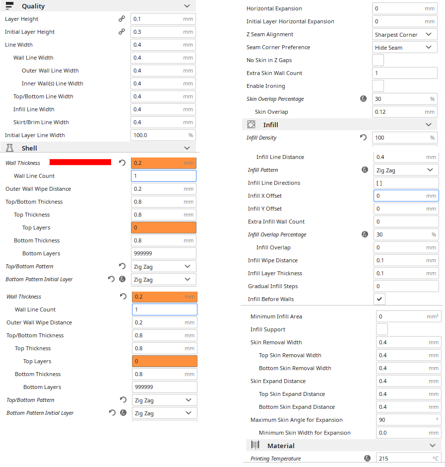

I have just printed a Virus mask and the small cover to attach the filter material. The cover is about 1.5mm wide and the mask is 2.5mm wide. I like to make the mask walls thinner, as it is a bit heavy. I have made the Wall Thickness as shown in red very low at .2 but that does not change anything. I also tried it at .4mm amd .8mm.
There may be a lot of serttings wrong in the attachment and any comments would be appreciated.
As with the vase that is very thin there must be settings in the .STL file I down loaded that need changing.
Wondered how I access those files?
Thanks
Thanks

There may be a reason to keep the mask thickness as it is. It helps reduce potential layer gaps, and improves strength where it is needed. Do you have a link to the STL?

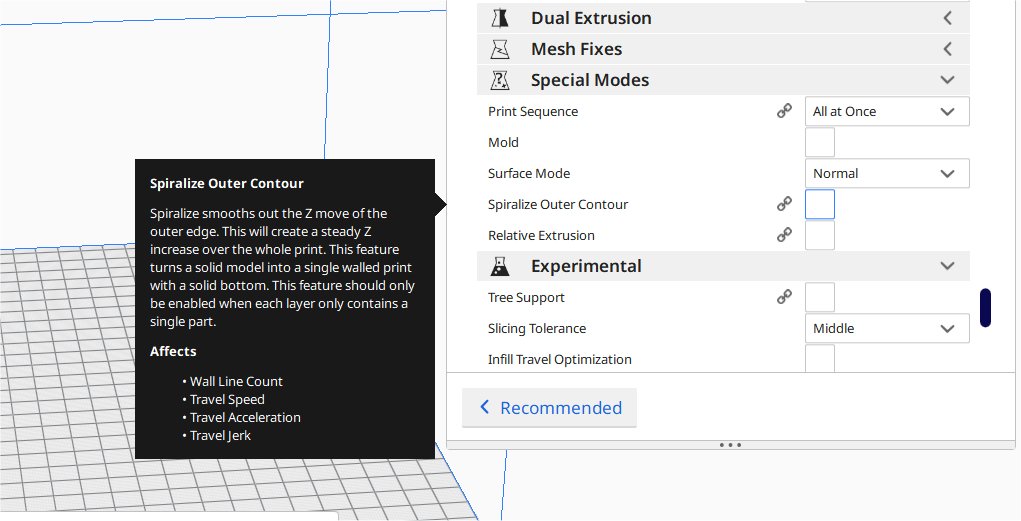

Cura does have a option Spiralize
Re: How to Reduce Wall thickness
Thanks. I'll have a look at that.
If you want to start the spiralize settings look thru this article Combine spiralize and normal printing
Thanks I got it to print with very thin walls by clicking on Spiralized in Cura. I used PLA and it delaminated badly in three places but I guess I just need to get the nozzle temperature right and I'll also try PLA+.
In the last four years I had never heard of Spiralization I am not using it for the mask as reducing the Infill to 40% it is light enough. I am making a canopy for a small quadcopter and Spiralization makes it very light.
Thanks again.
