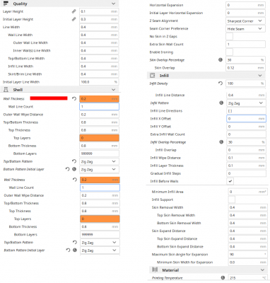

NOTE: No need to read the text. My problem is in the first photo.
I have been trying to get the walls thin on items for quite a while. If I print the vase that comes with the Coocon Creater / Wanhoa Duplicator i3 V2 3D printer they are paper thin as they are suppose to be.
I have just printed a Virus mask and the small cover to attach the filter material. The cover is about 1.5mm wide and the mask is 2.5mm wide. I like to make the mask walls thinner, as it is a bit heavy. I have made the Wall Thickness as shown in red very low at .2 but that does not change anything. I also tried it at .4mm amd .8mm.
There may be a lot of serttings wrong in the attachment and any comments would be appreciated.

There may be a reason to keep the mask thickness as it is. It helps reduce potential layer gaps, and improves strength where it is needed. Do you have a link to the STL?

So it looks like Cura will not make the walls of the print thinner but I have to use Fusion 360?
Even though Cura has a setting to reduce wall thickness.

Cura does have a option Spiralize

Thanks I got it to print with very thin walls by clicking on Spiralized in Cura. I used PLA and it delaminated badly in three places but I guess I just need to get the nozzle temperature right and I'll also try PLA+.
In the last four years I had never heard of Spiralization I am not using it for the mask as reducing the Infill to 40% it is light enough. I am making a canopy for a small quadcopter and Spiralization makes it very light.

Layer height will have a big play here, along with hot end temp. Go with a finer layer height and a higher temp (+10C) and you should see better results. You may also have to figure out a way to do some annealing. You can usually find a cheap toaster oven at a thrift store that works perfect for smaller prints. Otherwise, you can use your kitchen oven. Just hide the frying pans from the wife beforehand.

Doing the finer layer height as you said and working good now.
