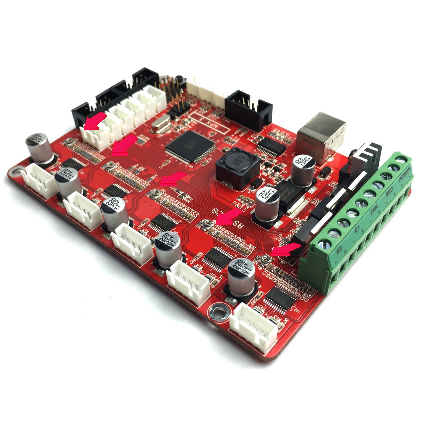

The voltage is measured from the trim-pots metal top adjustment.
I have placed a red arrow pointing at the pot adjustments below.
They are labeled R1, R2, R3, R5 and R6 on Base V1.3, MPK_V1 and MPX.3.
R1 is X
R2 is Y
R3 is Z : Double stepper higher V-Ref
R5 is E0
R6 is E1
R1 is X
R2 is Y
R5 is E0
R6 is E1

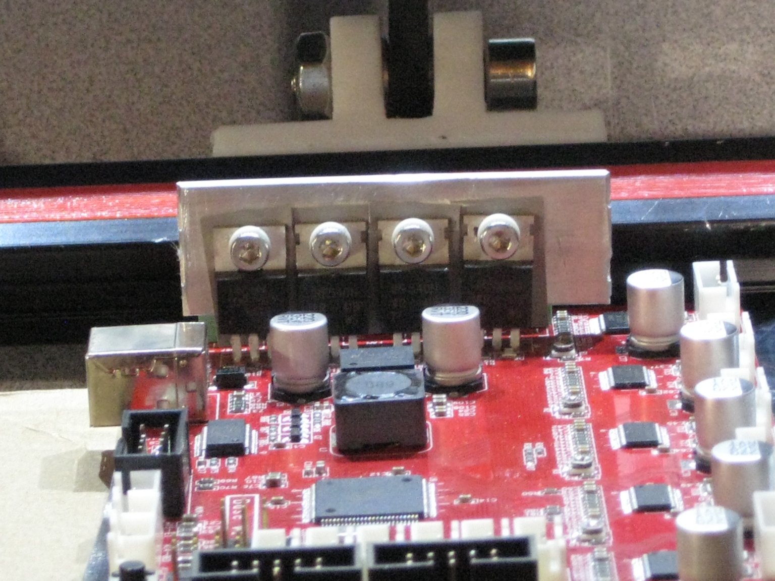

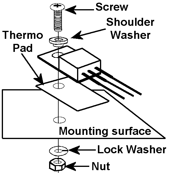

I have found that a Heat-sink is desirable on these controllers as the mosfets get hot.
I added a TO220 Transistor mounting kit and added an aluminum bar, along with a controller cooling fan.
Re: Extruder wont extrude Hitop 3DP12
Ok, measuring across these pins on the POT
I get 0.65 to 0.68 on all of the pots???

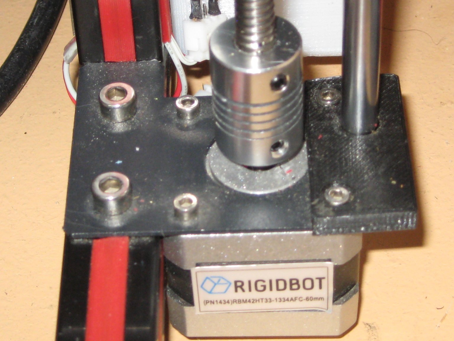

The Blobs could be caused by the Smooth rod holders.
The metal brackets that hold the Z steppers are too thin and allow movement in the smooth rods.
The X and Y belts could be loose and allow play causing the blobs.
These will also leave wavy lines on the X and Y edges.
Post a picture of your first print. Will look see if you can determine thew cause.
