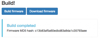

Neotko wrote:Btw can someone save that hash yo 'save' the settings?
It has always been there -- here is the story behind the hash:
When you build a firmware the MD5 hash is computed on the host which builds it. It is then displayed in your browser:
MD5 from the server
As we have a secure connection (https), there is a guarantee that the hash you see in your browser is the one generated by the builder.
Then once you have downloaded the file you can check on your local system that the file has not been damaged in the transfer by running md5 on your computer. As the whole session with the builder is encrypted, it is very unlikely that something happens, but you never know: you may have an incomplete transfer or whatever.

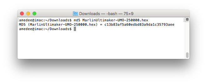

On Linux or Mac you can run md5sum / md5 on the command line:
Local MD5
I am not a Windows person, so I can't advise but there are various utilities for performing MD5 checks (fciv, certutil from the command line as well as some GUI tools)
Now this 128 bits checksum also uniquely identifies a firmware, as the probability to have the same checksum is close to 2^128 so about zero for this purpose. This is why I am logging the build MD5, that way from a firmware file I can go back and find the build properties.
That's the all story!
