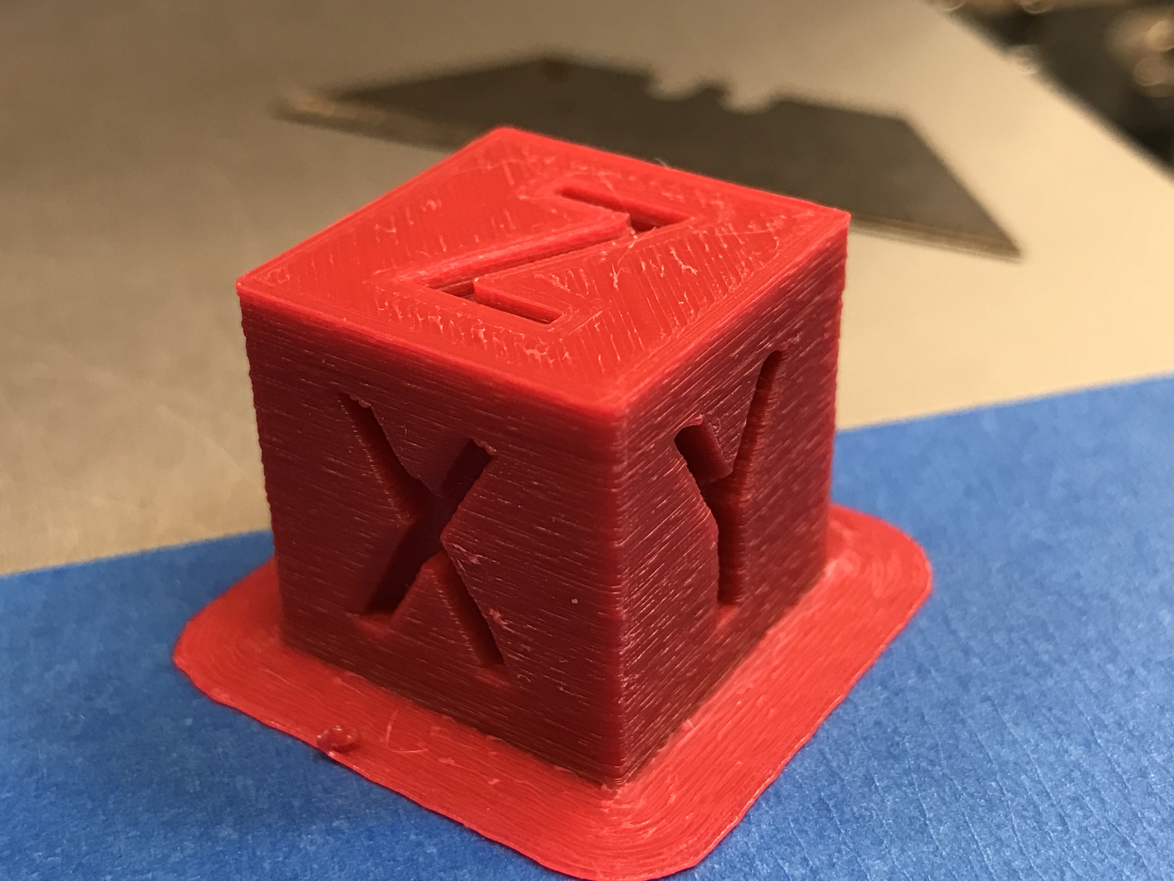

This is curious to me. Is there a file for a part to replace these? What are some of the symptoms of this condition?Roberts_Clif wrote: ↑December 30th, 2018, 10:00 pm The metal brackets that hold the Z steppers are too thin and allow movement in the smooth rods.
Even after bearing change and anti-backlash nuts installed, I am getting very fine variations is the layers. Almost like I am using Curas Fuzzy Skin on a VERY low setting. I will try and take a picture of the result of my latest calibration cube printed in ABS.
- Posts: 1494
Re: Extruder wont extrude Hitop 3DP12
When the Smooth rods wobble you will have Z striping on all sides of the Model less top and bottom

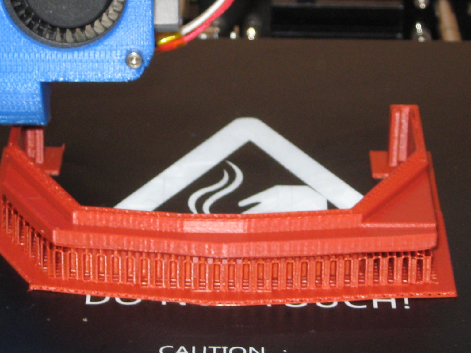

ABS Gutter clamp designed by myself Printed at Nozzle 228C - Bed 96C at 72% print Speed

Holy cow....are we printing in the same color?Roberts_Clif wrote: ↑March 18th, 2019, 9:07 pm ABS Gutter clamp designed by myself Printed at Nozzle 228C - Bed 96C at 72% print Speed

It would appear that we are, did not take time to note this at the time of my Post.
Though it does print quite well, you can see even with all my 3D Printing that this model was attempting to warp from the bed.
I was not using any ABS juice and choice to print on This cheap 3D Printer Bed Surface.

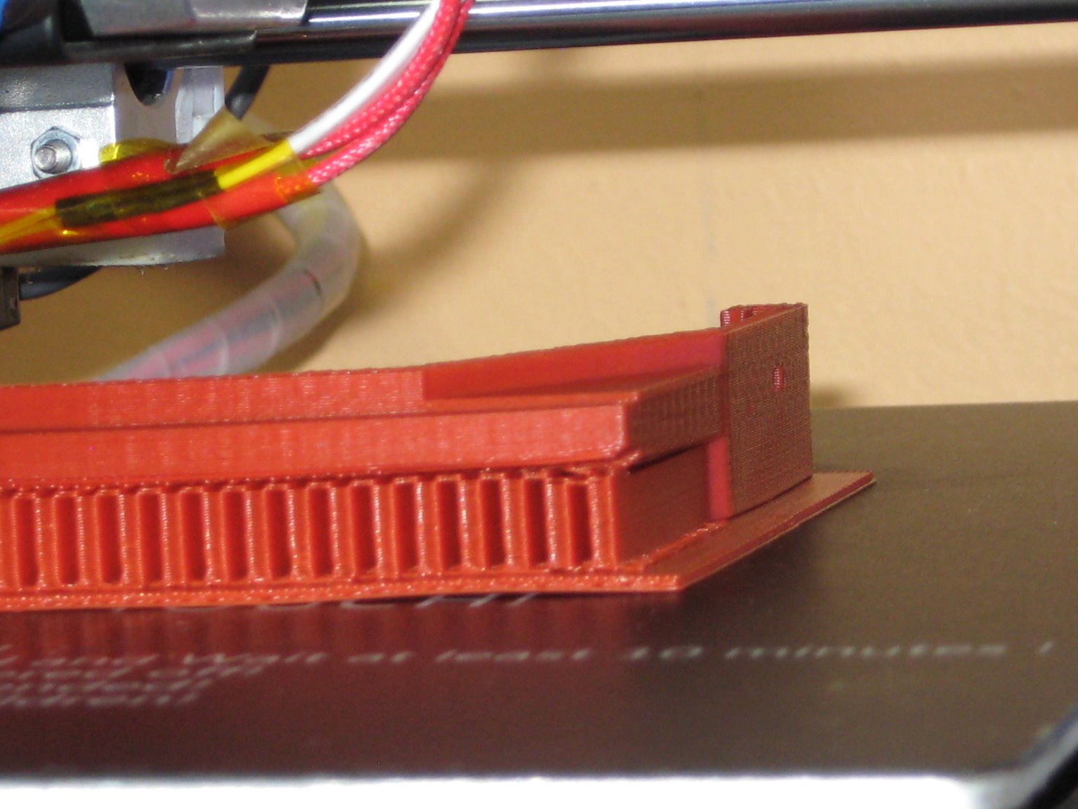

They are simple to install.
They have a tapered hole that allow you to loosen the two outside Z-Axis stepper screws place the mount and reapply the screws.
This will hold the Smooth rod with a lot better support. Seen in the attached photo
Looks Like I also Need to start Cleaning my 3D Printer seem to be collecting a lot of dust.
Should have mentioned too that I had to 3D Print the Z-Axis Smooth rod supports twice. Why because the first time they were wobbly.
Wobbly " Z-Axis was wondering all over the place " The 2nd print had the Z-Axis support to maintain the smooth rods and print a descent model.
