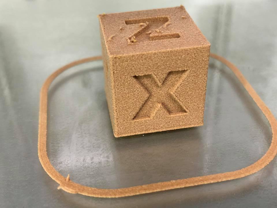

Well I am trying to dial this stuff in to print a bit nicer on my Ultimaker 2+
The instructions indicate it wants hotter...I printed at 210 and I probably should do 220.
It's the top of the print that makes me think hotter would not be ideal tho?
Polymaker Polywood filament

I think it's OK. The side walls are good, the leftovers at the top can be wiped off with a finger.

We got a good result...a few stringies here and there but perfect for a wooden Groot

Okay so I was meaning to come back here and give some information that might help others.
This stuff, which like a lot of wood filaments, is very stringy. I found I had to increase the retraction distance 2 mm more than my usual stock settings (6.5 mm on the UM2+)
Temps, well they advise some high temps but in my testing, 192-197 seemed to work best.
I still had a few whispy hairs and I suppose a bit more retraction distance (or even speed) might have solved that.

The one added detail I will add, while it is fresh in my mind...this filament could look under extruded in areas if the temp was too low. I found on one print, 197 was a tiny bit too low as I started to see tiny gaps. But nudge the temp to 200 and things looked better.
This is one of those filaments where I would really suggest some retraction test prints from Thingiverse and others. I know I am tempted to just do a calibration cube and see how that appears, then try a large print. That bit me in the rear end
