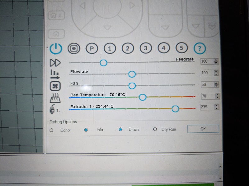

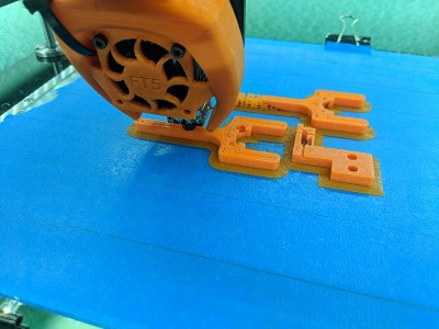

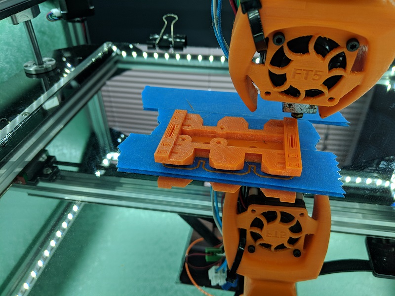

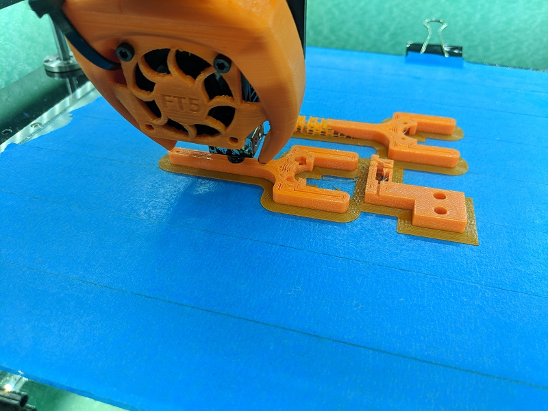

I know this thread is a little long in the tooth, but I've been getting decent prints with Hatchbox PETG at 235C and 70C on the bed. Glue stick on blue tape on mirror...Got those layers! Been using my FT-5 for a couple months and we're finally starting to understand each other a bit.
Wasn't going to post any pics until I got it dialed dead on, but I'm not convinced they're going to get a ton better with the stock extruder/hotend setup. They're definitely good enough I'm going to steer toward PETG for most of my everyday stuff I think.
