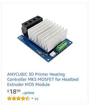

This Mosfet thing, is it easy to install, it doesn't look complicated.
Also which one did you use?
Re: Heating failed, Printer halted, Please reset.
I bought this one
Shane's video is pretty easy to follow on how to install. Mine's worked great
