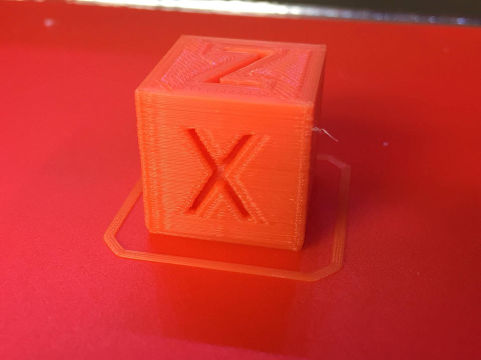

Slowed down acceleration and xy jerk....and it's still there
Still getting ringing....
- jonnybischof
- Posts: 310
Re: Still getting ringing....
Could be belt / pulley screw tension?
Maybe some other source of wiggle in the gantry?
- Posts: 4062
It was actually the S3D profile! Made a new print profile and all the ringing went away
