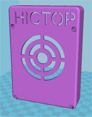

Just now finished the Remake - Hictop Controller CoverGrueMaster wrote: ↑June 22nd, 2017, 9:49 amBad link. Would love to see the finished project though.Roberts_Clif wrote: ↑June 19th, 2017, 8:11 pm I can redesign my Hictop Controller Cover, looks nice now but will look professional when finished.
https://www.tinkercad.com/things/h0AXk5 ... r-cover-v4
If you downloaded this New Cover don't Print It, after a few days discovered I made the skirt too short on the Stepper side and it fails EFI tests.
Hictop Cover v2.stl
New with Longer Skirt
This STL is from The Designer to all for Free for "NONCOMMERCIAL USE ONLY | NOT FOR SALES".
