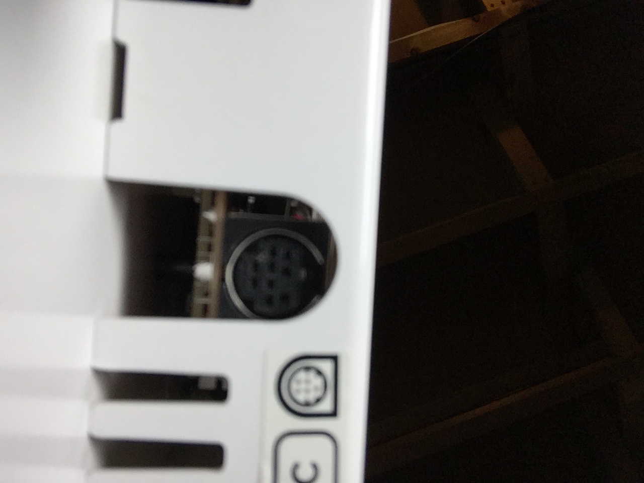

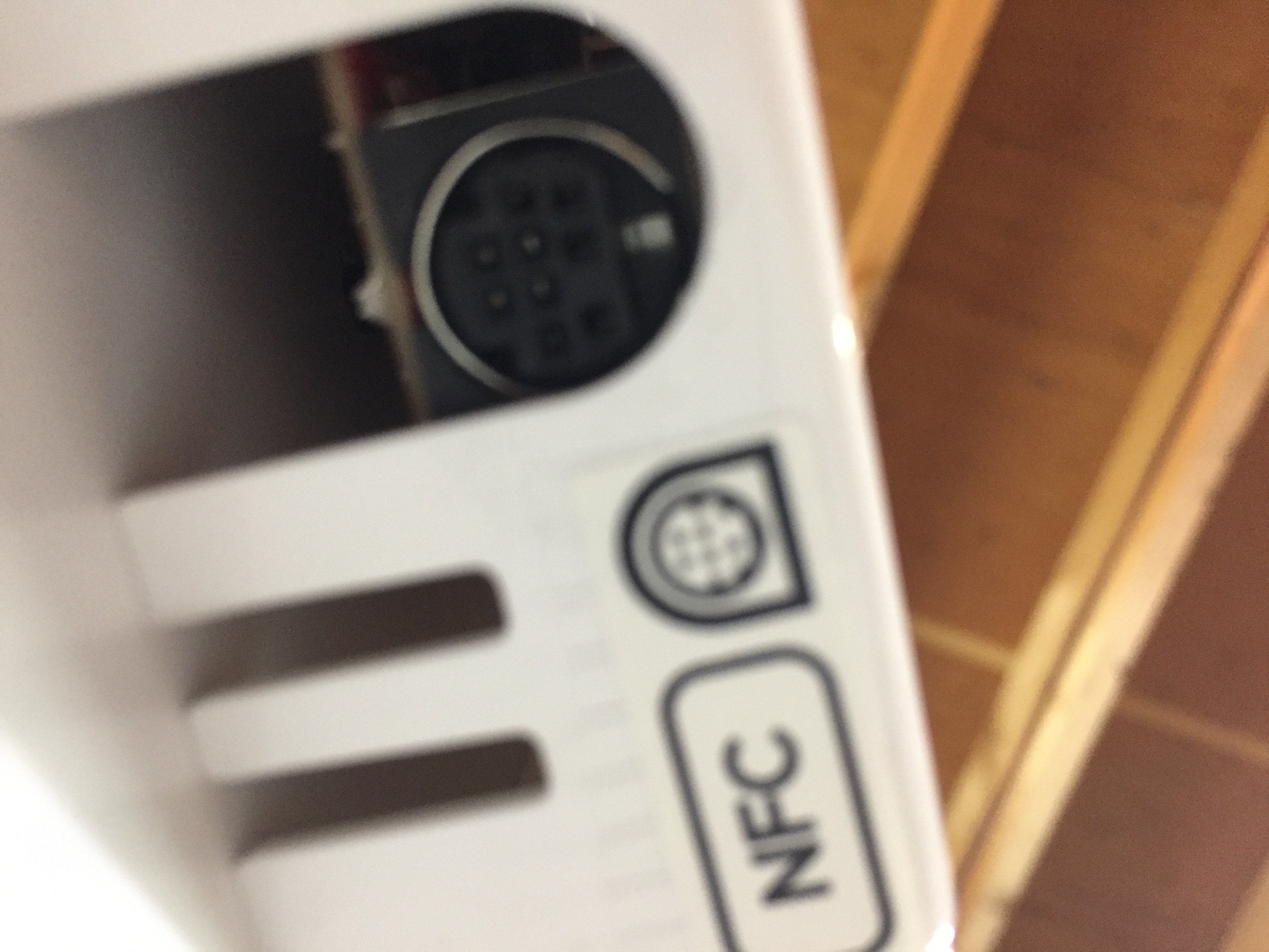

I unboxed one of the Ultimaker 3 printers and upon trying to plug the NFC cable into the plug, it won't go.
The plug in the printer is mis-aligned and the cable has that wide plastic shroud around it. There's no way, without risking breaking it, that cable can see to go in. I've asked Sander about it and hope he has some ideas.....have any of you guys run into this issue?

I don't have an UM3, but isn't that just a remove the cover, loosen the mainboard and push it a little in the right direction and fasten it again job? Normally these screws have a little bit of slag and if the cover is moved to the lower end of that and the board to the upper end of that slag for example, you could end up in such a situation.

Erin and Sander sent me some pictures and documentation on how to repair this
No cats/static inducing mammals will be allowed in the room
Apparently these can come out alignment in shipping, I just hadn't seen any posts where this has happened to anyone other than me (big surprise, right?)
