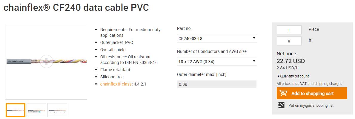

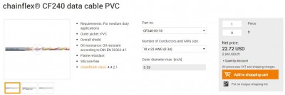

One of the builders reported really good results with CF240-03-18
