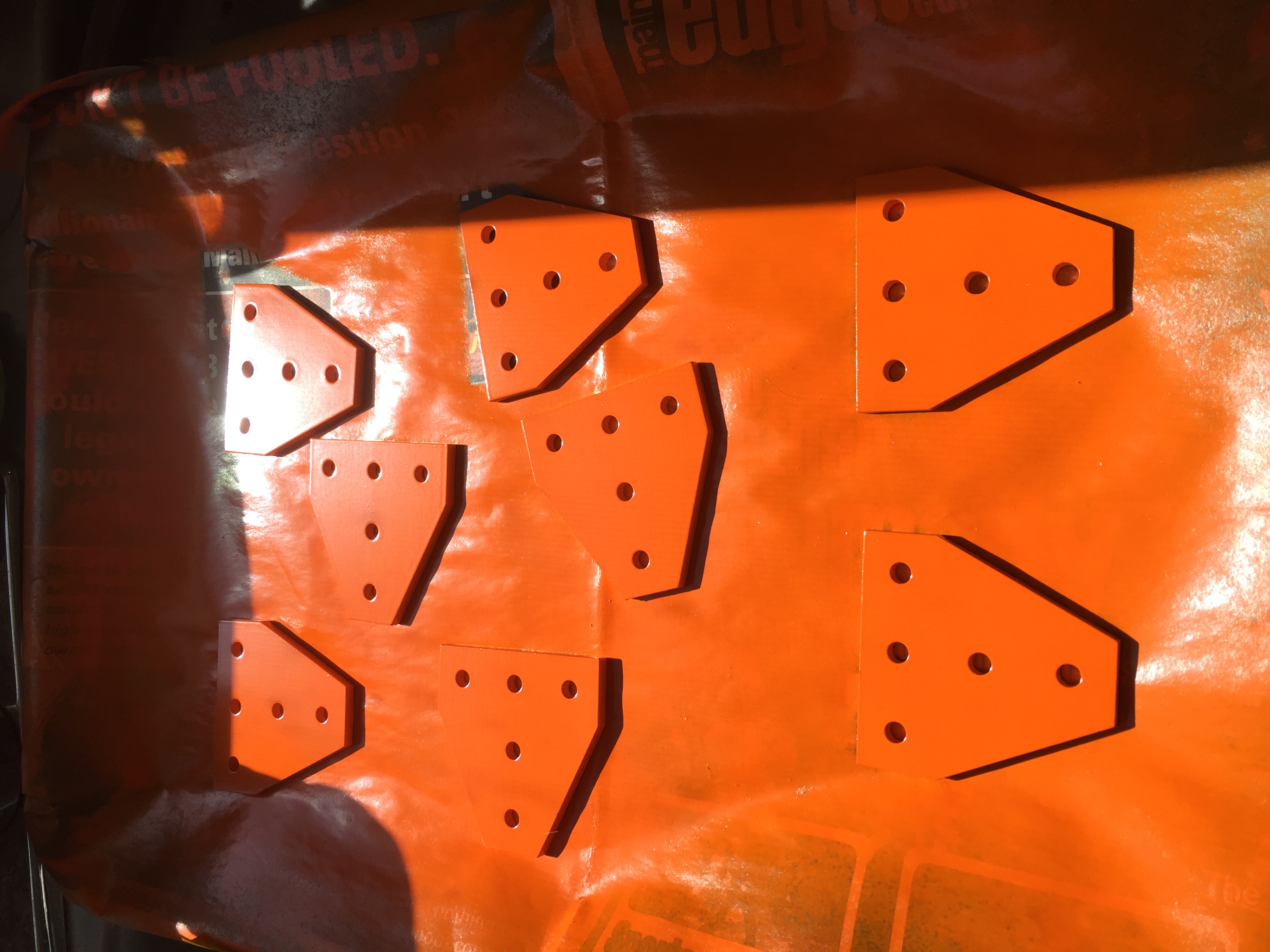

The 2020 pieces that make up the outer brackets (FT1 and FT2) have been replaced with aluminum versions I bought at Adafruit. I'm sure I could've paid even less via China shops, but I needed a few other thinks from Adafruit anyways.
I bought some Rustoleum Orange paint and started painting the parts. I figure if this will print the big pieces of BB-8, why not have some nice BB-8 coloring! (Plus my Ultimaker Original looks great in Custard Orange!)

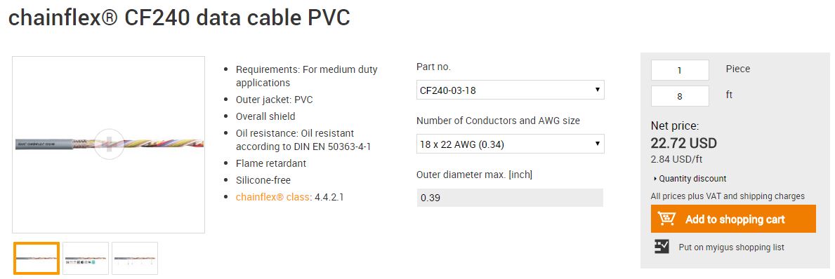

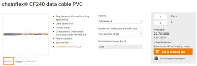

Igus chainflex wire
Decided to order 8 feet of it.
The kit has nice silicone wire but from what others mention, it can still look like a crazy nest of wires when completed.
This will handle everything minus the heater block

Meduza
Posts: 287
Location: Stockholm, Sweden
Re: Paul's FT-5 Build
Post by Meduza » March 8th, 2017, 4:56 pm
Igus Chainflex cable is good stuff, i have used it a lot on my cnc builds.

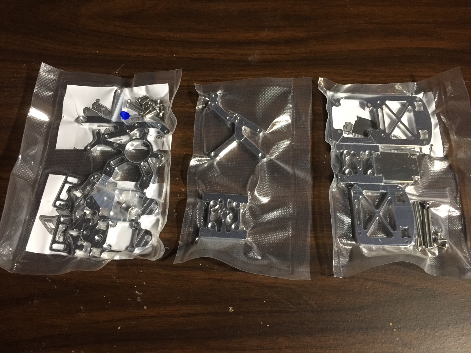

Post by LePaul » March 8th, 2017, 8:28 pm
713Maker.com Gantry and Ultralight Extruder Mount
I have two parts that were re-done...I just need to open the vacuum sealed bag and remove them
Shiny!

Well despite the bitter cold weather here (28F), I am trying to prime and paint my 2020 aluminum bracket pieces.
With the garage door closed but sunlight streaming in, applying the primer, let sit in sun for an hour...then in the house for two more....then back outside for a coat of Orange paint.
