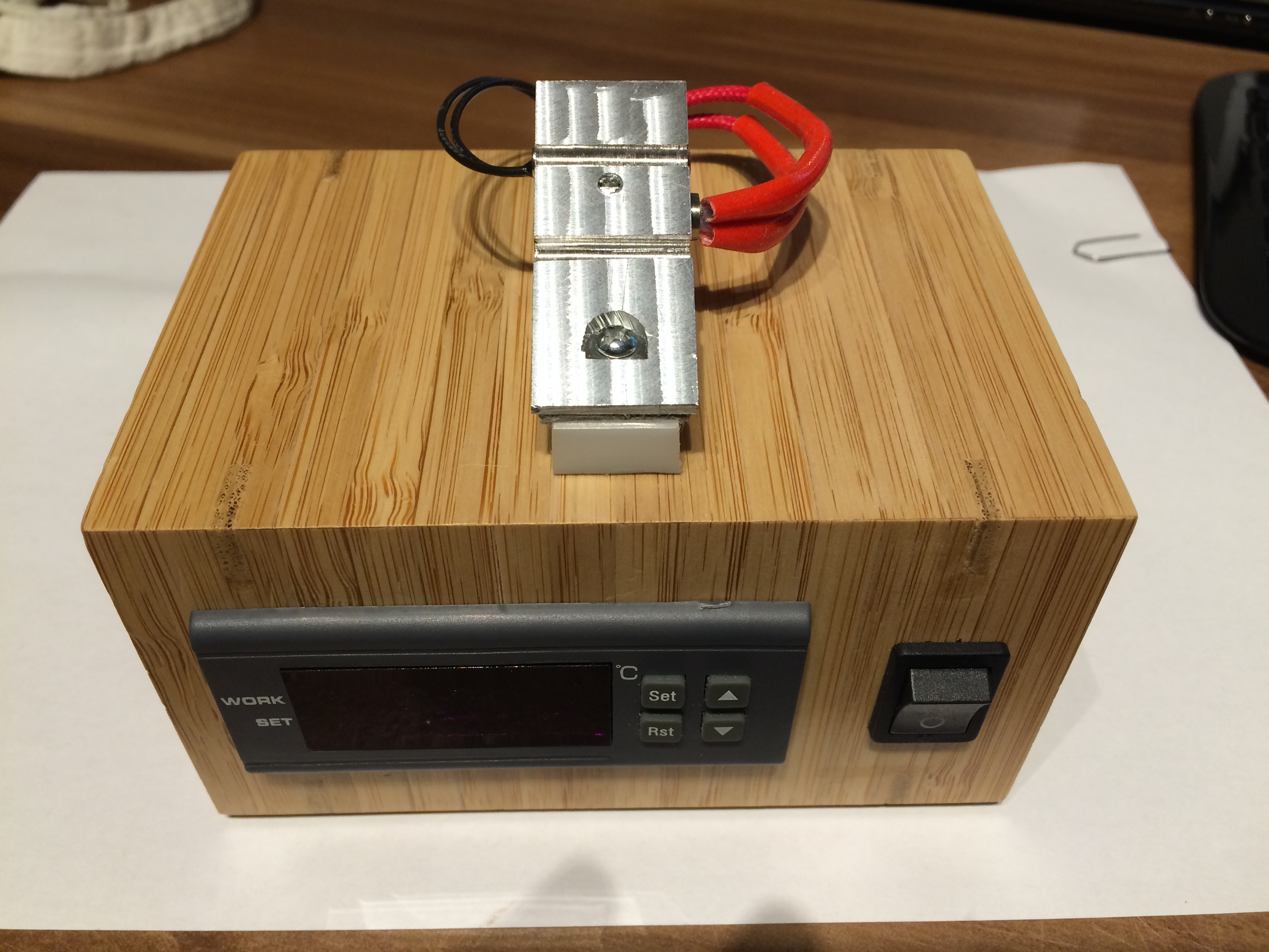

don´t know if this is the right section, but... LOOK WHAT I MADE :-)
Found a filament joiner on Thingiverse and started to build my own version. Tests pending, but it took app. 6 hours to mll the block (ok. very small mill, 0.4mm passes with a 8mm mill and yes, the camfer has been milled too...)
As soon as the first tests are done, I´l post an update - if somebody is interested...

Tested... it works...
A bit of trial&error is necessary, the first few joints made a huge mess, but finally I managed to join my samples color by color sucessfully in no time.
As expected, cleaning/trimming the joint needs to be done as usually, but as the joint is much better than made with a lighter, it´s quite easy...

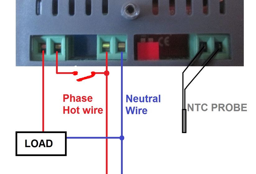

What did you use to control the temperature? I am currently working on the one from Thingiverse - I bought the hardware kit and printed the plastic parts - but do not want to use the printer as controller as this would mean too much messing around with the cables. I have an Arduino based temperature control already running but still have to work on the PID controller for the heater.

I took this one as example:
http://www.thingiverse.com/thing:281792
and bought the temperature controller at ebay.
If you take this one in 24V instead of 12V (http://www.ebay.at/itm/WH7016J-24V-Digi ... SwOVpXfLgS) you could reuse the UM2 PSU and a spare 24V heater
Control itself is simple. The hysteresis can be set as well as a temperatrue calibration factor. But what I learned from my trials, temperature stability is not critical as you just contact the filament with the heater block for a few seconds.
I modified the wiring a bit. The controller can be switched off by pressing RST for a few seconds and I feel more comfortable when setting the values before the heater is switched on instead it heats up immediately as the controller is switched on. Therefore I placed the switch between the power line and the relais input...
Posts: 467
Location: Stuttgart, Germany
Re: Filament joiner
Post by reibuehl » January 7th, 2017, 8:05 am
Reiner.

Huuu... from a Pro, I guess its much faster than me so I guess a tenth of my efforts (and it took a whole day with my mill to machine it) :-)
wooden box is from IKEA, cost ~7€
controller incl. sensor from ebay ~13€
heater from ebay ~3€
switch from my parts box, would estimate ~1€
alu block 30x20x18 (from the companies trash bin -I´ll post the drawing later)
balsa block as insulator (from my parts box)
Does this help?
