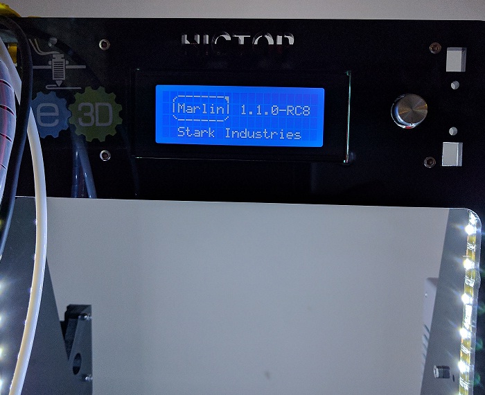

Up and running 1.1.0 RC8
Was a pain to get some of the features working due to me knowing almost nothing about Arduino prior to this printer.
So-far it has been fun but sure eating a lot of my spare time!!!
