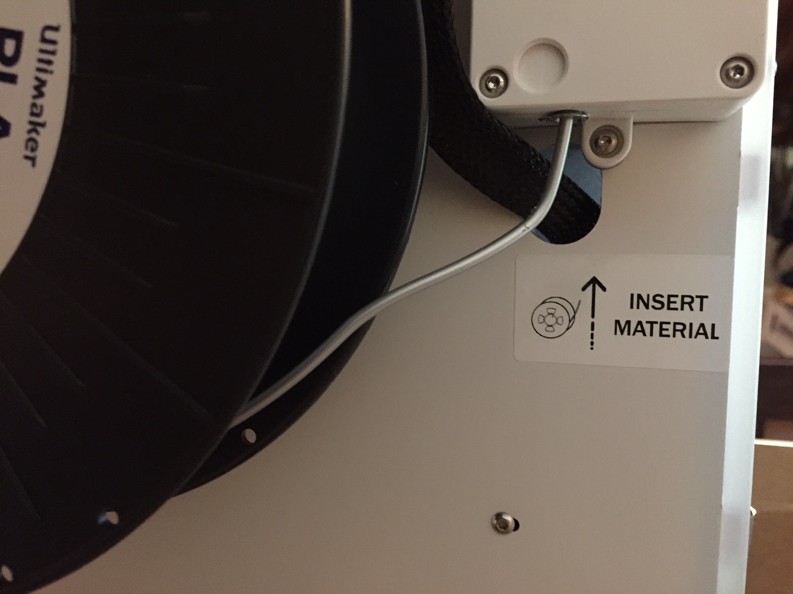

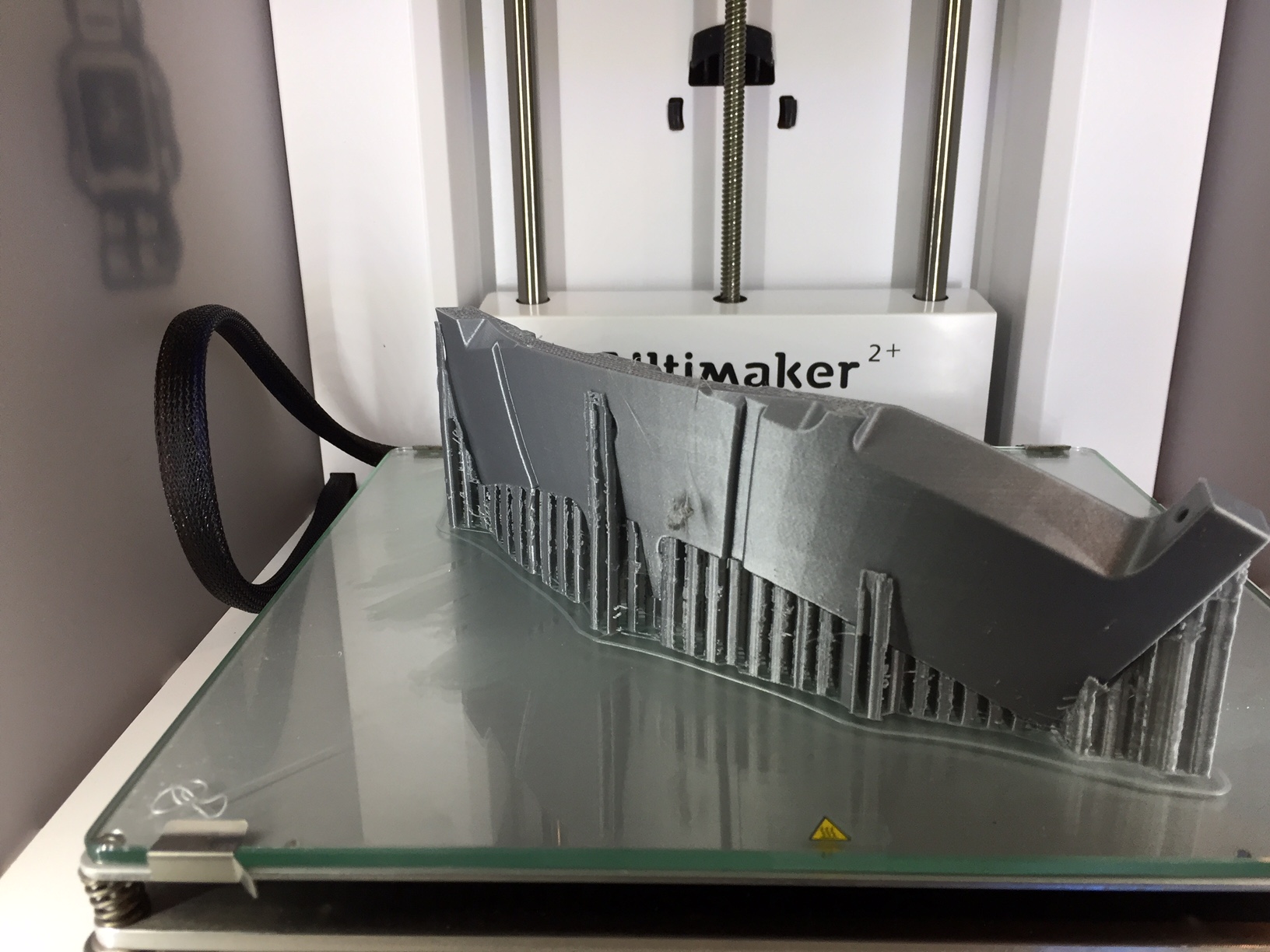

Looks like about 10 hours into this 14 hour print, the filament kinked.
This surprises me since it had a pretty smooth flow directly into the extruder.
I didn't have time to sort it out, just enough time to snap a photo so I can ask about this on the Ultimaker forum I see filament in the Bowden and I am hoping if I use the control panel to remove the material, out it will come.
My question now is...do I have an extruder setting problem or just a weird filament tangle that happened? I need to make a LOT of parts for my BB-8 and would like to think my feeder is reliable!
And the real sad thing is, there's no sensor to show when the filament isn't feeding. So the Ultimaker just kept on swirling around for hours. No way to save this print :(

Did you feed the filament directly into the feeder like this?
It should normally go over the black plastic part that you can see bottom right on this picture:

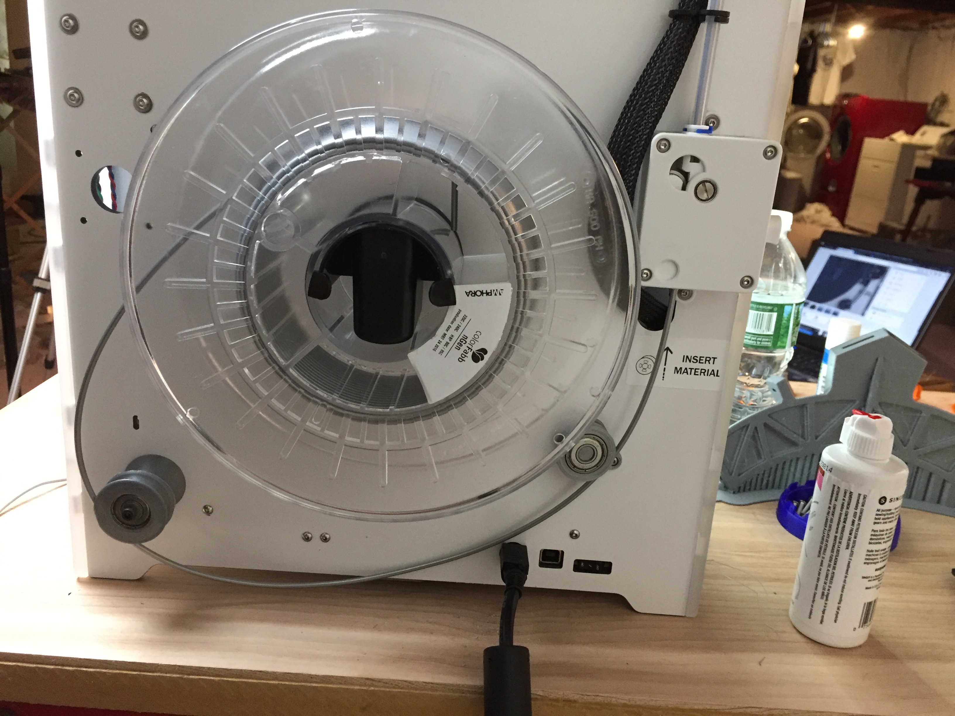

Take a look at https://www.thingiverse.com/thing:436528 and https://www.thingiverse.com/thing:858734 (or any of the other similar solutions - I have a number of them in my Ultimaker 2 collections at Thingiverse and Youmagine).
Posts: 4060
So I am not the first to be bit by the ghouls of filament binding....
It looks like the bearings mount to existing holes used to hold the shrouds in place?
I just need to source some of the metric parts here in the USA

Yes, most if not all of the solutions use existing mounting holes. Sometimes you need a longer screw or so.
That kind of shape looks like a partial entanglement of the filament.

reibuehl wrote:Take a look at https://www.thingiverse.com/thing:436528 and https://www.thingiverse.com/thing:858734 (or any of the other similar solutions - I have a number of them in my Ultimaker 2 collections at Thingiverse and Youmagine).
Just ordered some 608zz bearings on Amazon, I think both or those should make a big difference.
I was asking Erin over to Fabrc8 if they've seen that happen before. I've had weird things happen when near the end of a spool, but this was 1/3 of the way into the Ultimaker Silver one
I printed Roberts bearing spool holder and produced some bearing filament guides to minimise friction when using flexable filaments, Roberts holder is great well worth printing.

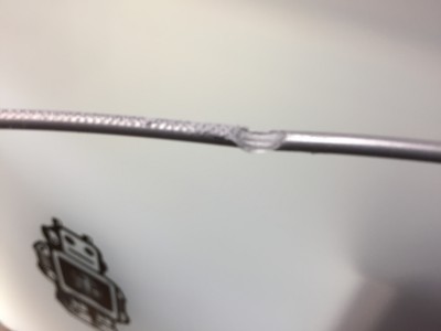

Well here's how the filament looks after ejecting
