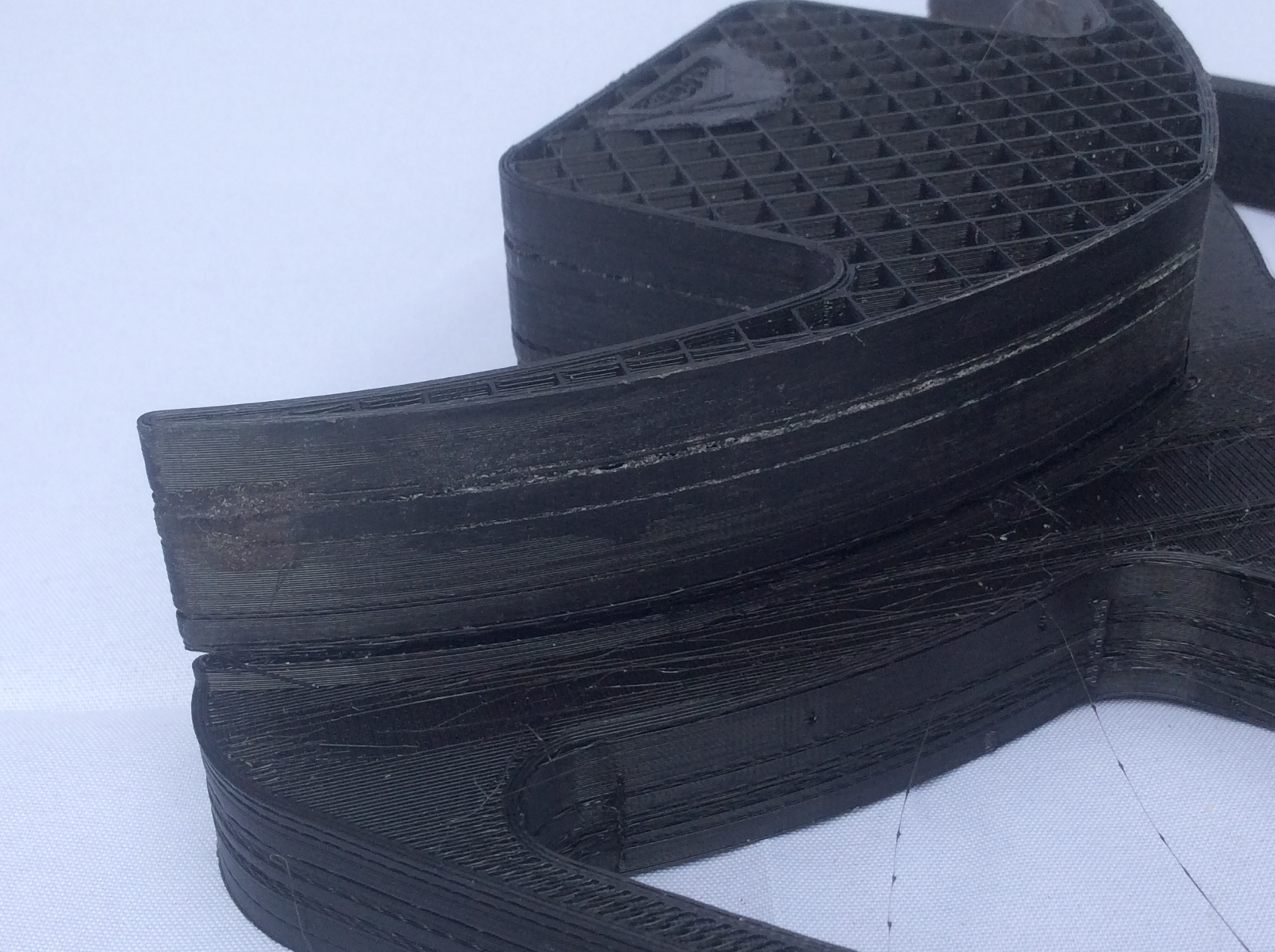

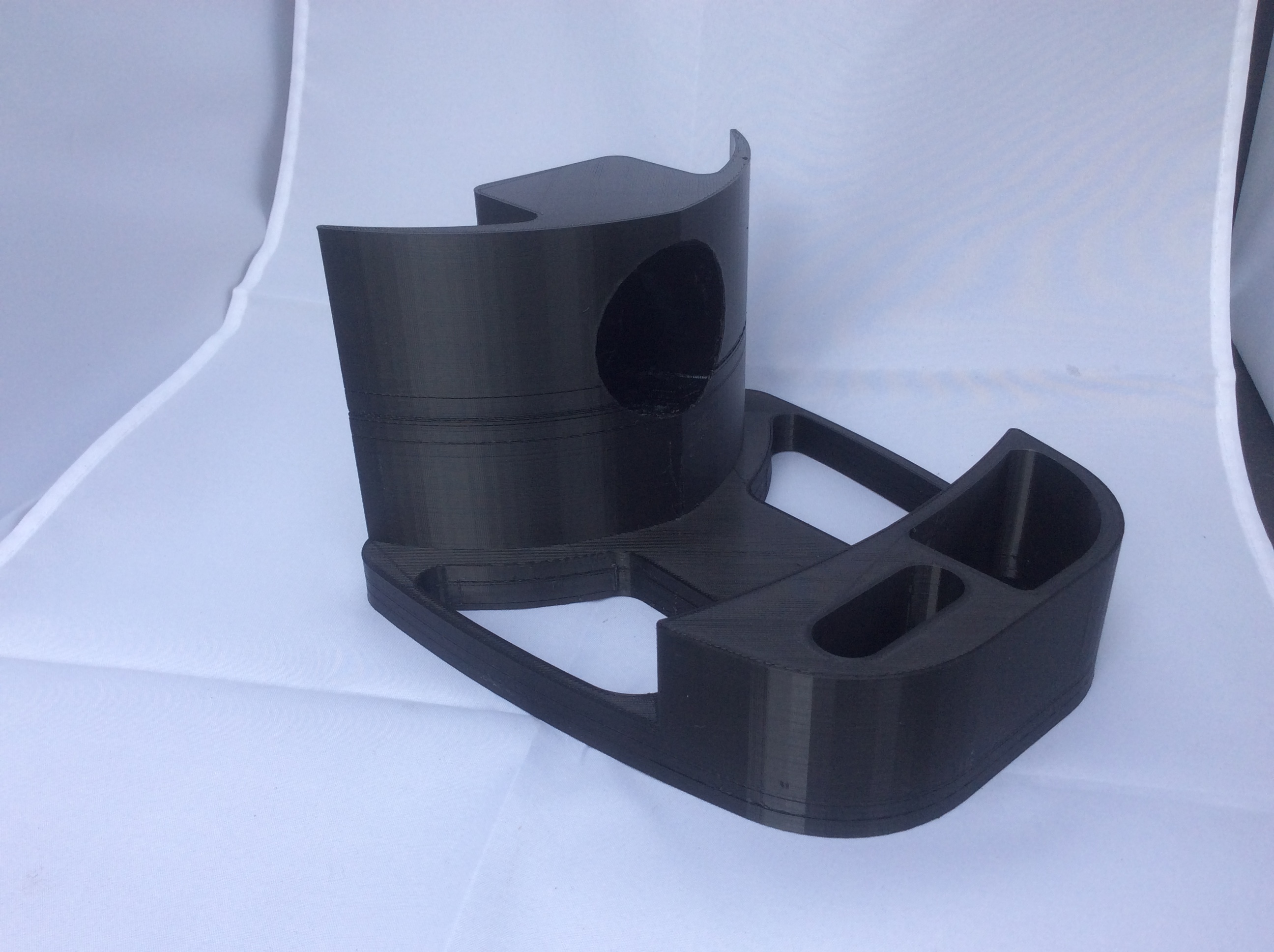

I occasionally get errors with good quality material I just had some intermittent underextrusion with ColorFabb black PLA on a 30hour print and about 40m lost, I thought it might have been feeder issues etc but I've just run another job with several parts with ColorFabb Standart White and not a problem with any of the prints so perhaps I have a duff reel, it can happen to the best of them.

I have currently also problems with Black ColorFabb PLA - maybe they had some quality issues on that one? I need to start my prints with 220-230°C to avoid a blocked nozzle. After the print is running, I can tune back to the 210°C that I usually use for PLA.Izzy wrote:I just had some intermittent underextrusion with ColorFabb black PLA on a 30hour print and about 40m lost, I thought it might have been feeder issues etc but I've just run another job with several parts with ColorFabb Standart White and not a problem with any of the prints so perhaps I have a duff reel, it can happen to the best of them.
Does yours have a batch number, Izzy? Mine is production date FEB 15 2016.
Re: Preferred PLA filament in the UK
Hi Reibuehl, mine has MRT 2 2016.
I as printing at 218'C with a ruby nozzle, at 42mm/s
As you can see from the photos it would be fine for 10 hours or so and then...

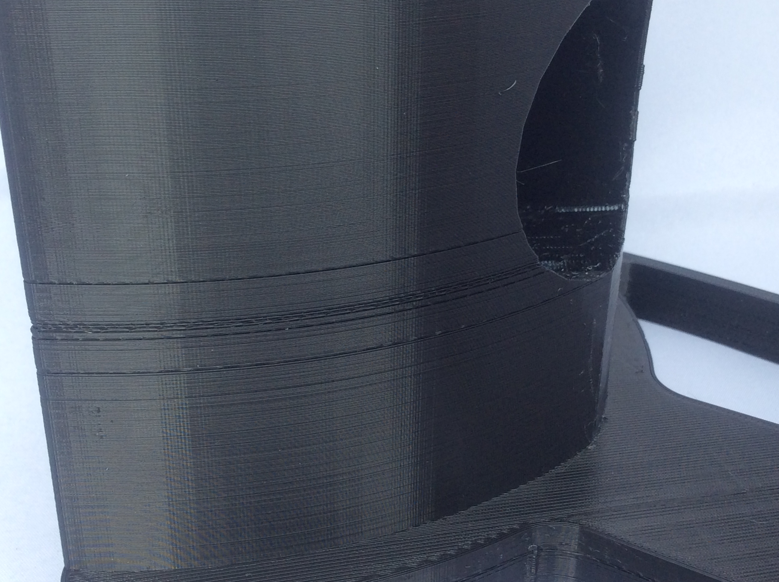

This was a 30hour print, I aborted the 1st one after 12 hours with the same problems but power down, I had set it going at 9pm and when I checked it in the morning it was not worth finishing as you can see in the 3rd photo. The White stripe was were I tried som glue to see if it could take bonding, filling and then painting,
