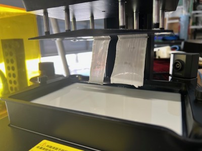

Issue: Models are not printing. All I get is a rectangle(s) with one of the short ends adherring to plate. Nothing is stuck to FEP the model just comes out like a flat, skinny rectangle (See image).

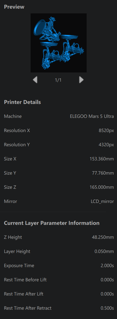

Settings: See image 2

at first glance it looks like you have a few issues.
2 exposure is way too low. 4 is my minimum
your supports may be too thin, thus tearing off early on
your bottom layer exposure should be 30-40 sec. (with my elegoo standard resin it's about 30 on my Ultra 4)

Post by BansheeVT »
This might be stupid, but I did it, so I'm not above mentioning that the build plate has a sheet of plastic on it - the ones on the FEP and LCD both were obvious, but I missed this one. :lol: Noticing that after a print failure didn't help, and it seems you're having slightly less trouble than I am - my FEP sheet holds the prints really, really well, and nothing has ever stuck to my build plate. So far only 50 grams of waste, but it's irritating. I'm going to keep trying, and I hope you have success!
