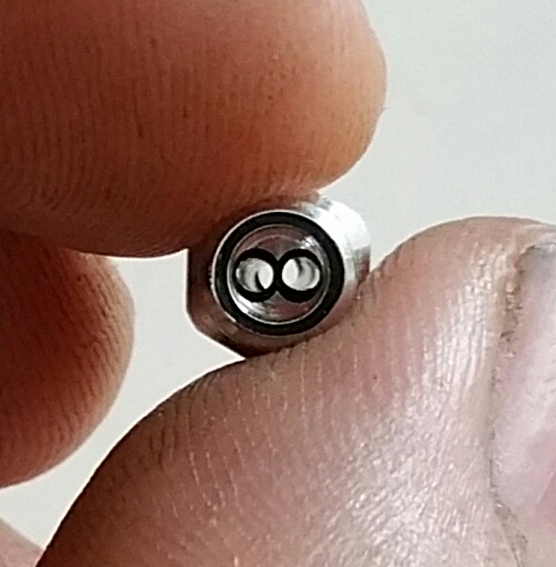

I dont know what part you find intresting about the read, to me that page is mostly just marketing talk with no real information...
About the difference... Well i took this picture to show you the difference (picture is of the 1.5mm nozzle, but the principle is the same): I have not had time to try them yet, so i cannot say anything about the performance, but the finish and quality seems pretty good.

Nah, i do not believe the block are measurably better than the regular olsson block at all honestly, so i do not see any point at all in upgrading a UM2+ or a UM2 that already got the Olsson block, especially since there is no push holes and that means that the heater and sensor might be impossible to get out in undamaged condition...
The nozzles, well i do not think that the chamfered edge that should contact the block would make much of a difference, but the longer thread might do a bit of a difference, and the inner two-hole shape is quite intresting and might make a measureable difference, especially in 0.8mm and larger where there is very real problems with the core not melting, i will probably test them against regular olsson block nozzles from the later batches and maybe even against a nozzle from e3d when i find some time

I'm trying to figure out the two hole part....

Whats benefits from this double hole design? Just cant understand it....Meduza wrote:I dont know what part you find intresting about the read, to me that page is mostly just marketing talk with no real information...

A more homogeneous melt-up of the filament which results in apparent lower printing temperature. It's because the surface of the heat transfer section is changed. That's the idea.ivan.akapulko wrote: Whats benefits from this double hole design? Just cant understand it....

The idea with the two holes is actually not to have two holes but rather some metal in the middle of the plastic stream that helps heating up the filament from the inside - more heated surface in contact with the filament.

when changing the filament it does not create unnecessary problems?reibuehl wrote:The idea with the two holes is actually not to have two holes but rather some metal in the middle of the plastic stream that helps heating up the filament from the inside - more heated surface in contact with the filament.
