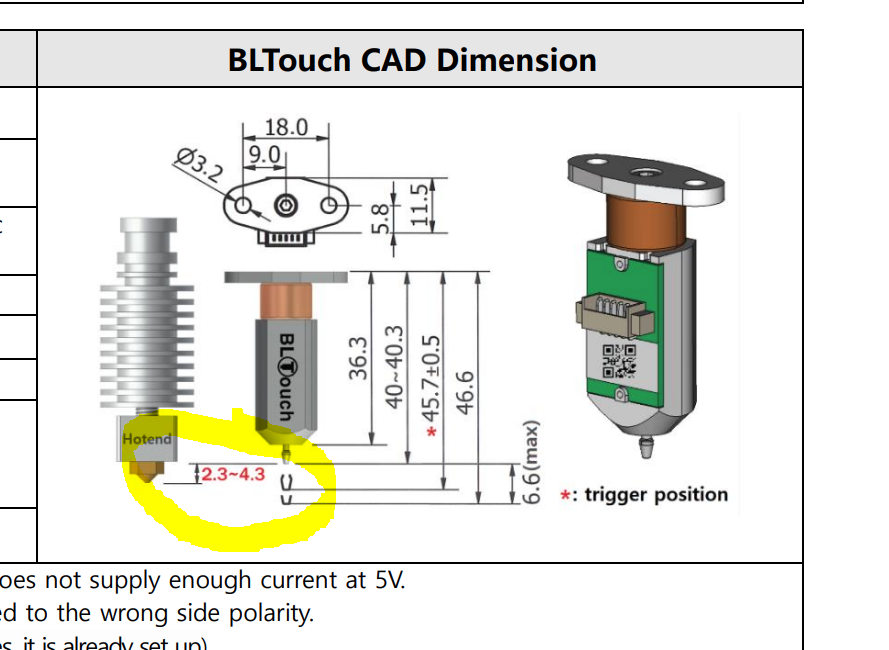

Your description of the problem makes me think of one possible thing to check.
If you look at the ANTCLABS BL touch website (https://www.antclabs.com/manual), what version do you have?
Now pay close attention to this part, look at the guidelines for the distance for the BL Touch tip in relation to the nozzle tip.
You need to be 2.3 to 4.3 mm above it
