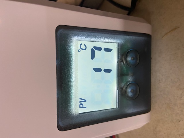

My first impressions of it is that the LCD was rather faint and you were pretty limited where you could place that spool.
I'm impressed you're getting good results already!

My LCD is not faint as it has a bright backlight.
Your backlight must not be working.
Re: SUNLU Filament Dryer S1
As I mentioned, I do not own one. That was the complaint from reviews I saw online
