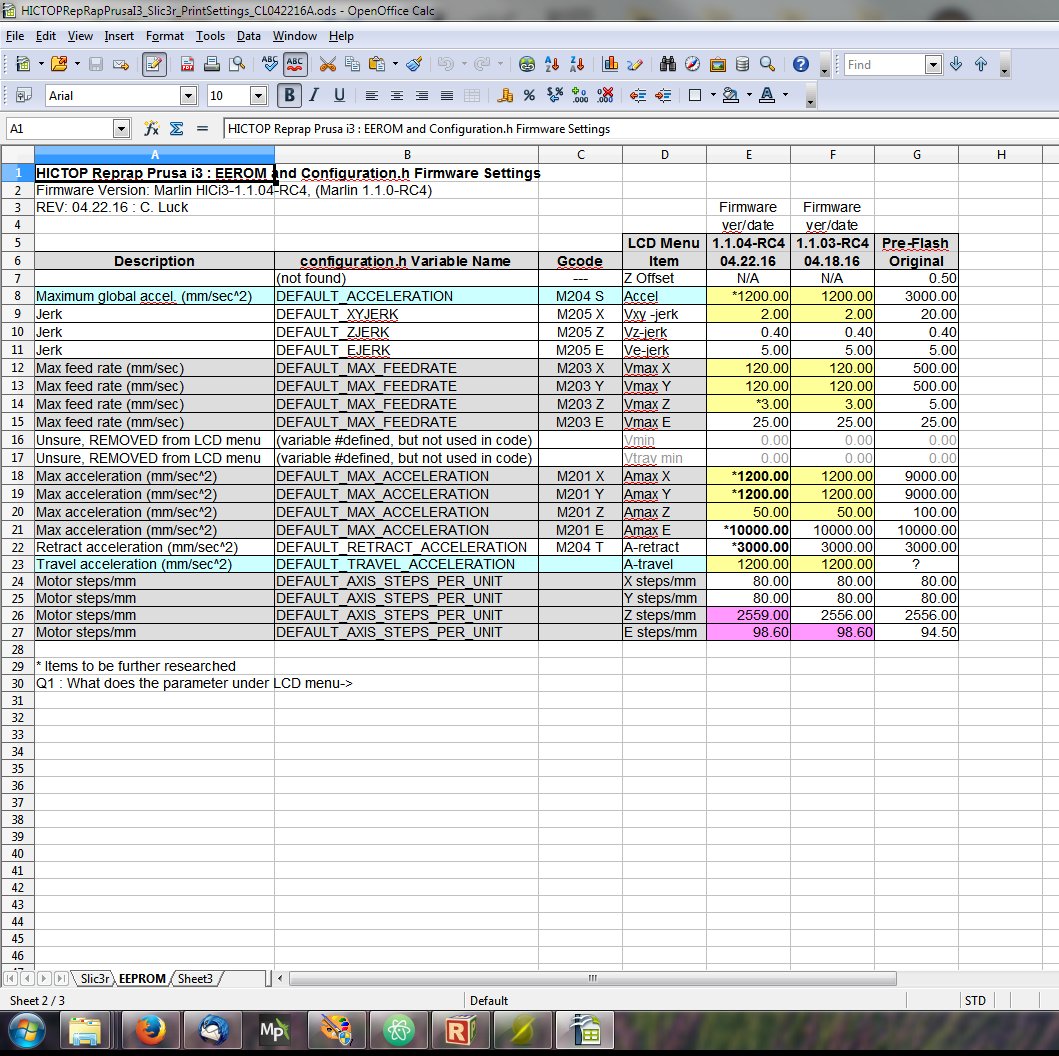

Slowly getting my machine tweaked from the 'China' EEPROM defaults. Have spent a lot of time and research and my HIC i3 is perfoming much better.
Question, what are the default Marlin EEPROM settings are others using, in particular relative to speed and accleration settings? I realize each printer will be different, but a Prusa i3 type setup, X/Y belt driven, Z-axis threaded rod, etc. it just might help to share your input or your own settings.
Here is my firmware default EEPROM settings and part of the (now heavily commented) <configuration.h> file from the source code. Currently I'm running a modified Marlin 1.1.0-RC4 version.

EEPROM settings:
Will work on table formatting later, have to learn phpBB again.
Format shown = DESCRIPTION VARIABLE GCODE LCDNAME VALUE
Jerk DEFAULT_XYJERK M205 X Vxy -jerk 2.00
Jerk DEFAULT_ZJERK M205 Z Vz-jerk 0.40
Jerk DEFAULT_EJERK M205 E Ve-jerk 5.00
Max feed rate (mm/sec) DEFAULT_MAX_FEEDRATE M203 X Vmax X 120.00
Max feed rate (mm/sec) DEFAULT_MAX_FEEDRATE M203 Y Vmax Y 120.00
Max feed rate (mm/sec) DEFAULT_MAX_FEEDRATE M203 Z Vmax Z *3.00
Max feed rate (mm/sec) DEFAULT_MAX_FEEDRATE M203 E Vmax E 25.00
Max acceleration (mm/sec^2) DEFAULT_MAX_ACCELERATION M201 X Amax X *1200.00
Max acceleration (mm/sec^2) DEFAULT_MAX_ACCELERATION M201 Y Amax Y *1200.00
Max acceleration (mm/sec^2) DEFAULT_MAX_ACCELERATION M201 Z Amax Z 50.00
Max acceleration (mm/sec^2) DEFAULT_MAX_ACCELERATION M201 E Amax E *10000.00
Retract acceleration (mm/sec^2) DEFAULT_RETRACT_ACCELERATION M204 T A-retract *3000.00
Travel acceleration (mm/sec^2) DEFAULT_TRAVEL_ACCELERATION A-travel 1200.00
Motor steps/mm DEFAULT_AXIS_STEPS_PER_UNIT X steps/mm 80.00
Motor steps/mm DEFAULT_AXIS_STEPS_PER_UNIT Y steps/mm 80.00
Motor steps/mm DEFAULT_AXIS_STEPS_PER_UNIT Z steps/mm 2559.00
Motor steps/mm DEFAULT_AXIS_STEPS_PER_UNIT E steps/mm 98.60
From this screen shot here:
EEPROM worksheet screenshot
Again, getting a feel for what does what. I'm telling you now, if you look at the default variables stored in EEPROM/firmware from the factory, you can see some of the values were off but quite a bit.
