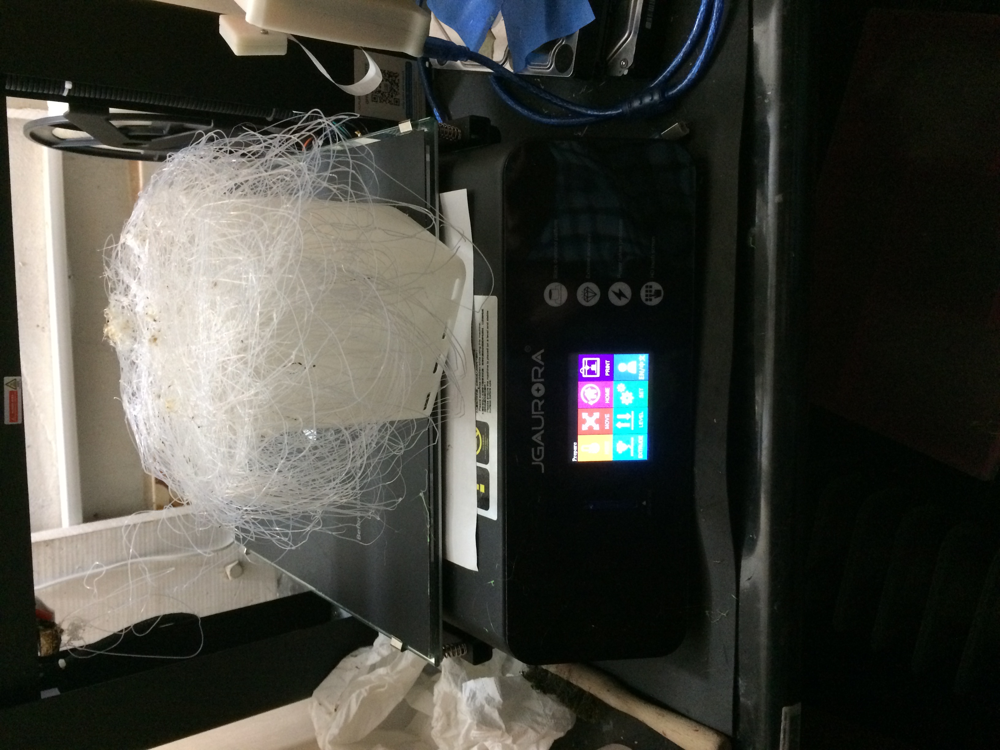

I think I may have solved the problem of parts sticking to the bed too much, somehow.
Over 12 hours into this print and the print went for a walk. It must have happened when I left the house..
I think I was pushing it a bit too much.

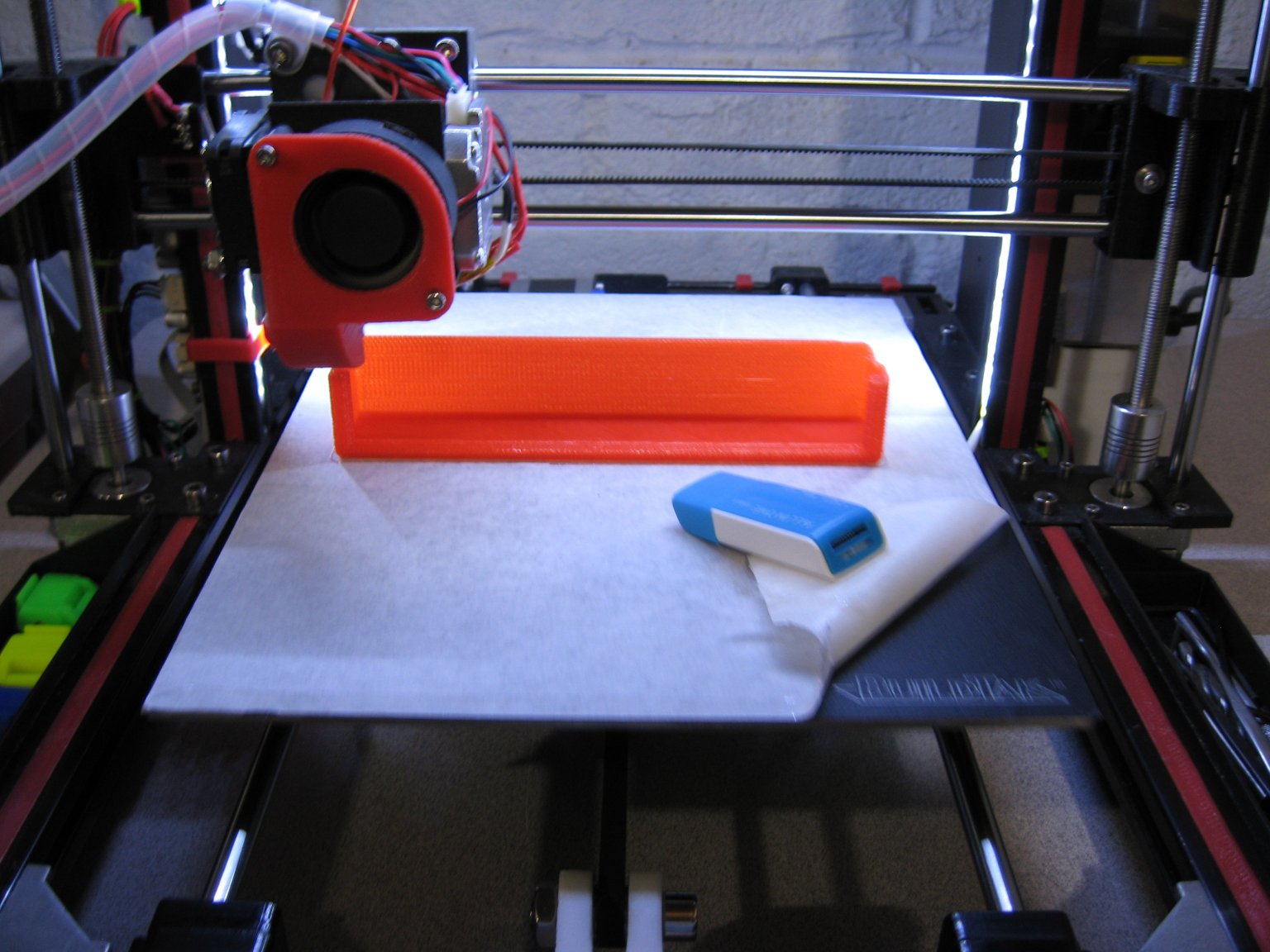

I have on many occasions found it sticks so tight that it hard to remove, or it is not quite there and breaks loose.
I have finally purchased a bed surface that will actually hold the print from beginning to end.
Before finding this surface I would print on tape on my First bed surface, as prints would not stick correctly.
The bed surface in the image above would not work for we at all, I finally ripped it from the bed and replaced with a cheap Chinese bed surface. You can find them on E-bay they are sold on lots of 3. Photo was taken in the middle of print, after failing to stick several times to the bed surface..
I have replaced this Chinese surface after 2 years of use, on each of my 3D Printers. An plan to continue using as it works so well.
Just because this particular Bed surface did not work for me does not mean it is a bad Bed surface.
I could not get it to hold the prints. and the tape method did until I again switched to a Chinese bed surface.
