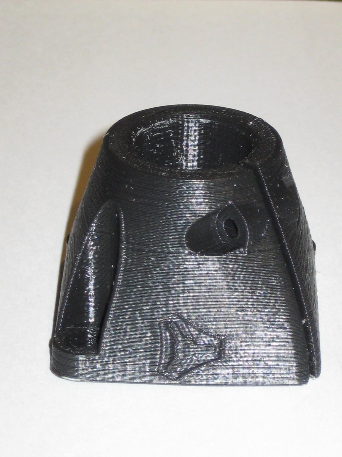

First C-Foot 3D Print in ABS looks promising, with ABS shrinkage the ID for the Feet is 23.37 the conduit measurement is 23.5.
This means that very little finish work will need to be done in order to assemble the Piper 3D Printer.
I setup the Printer nozzle to 228C with a bed temperature of 98C, first layer print speed 40 all remaining layers 76 percent.
This calculates to 8.5mm^3 per secound.
With a layer height of .28 an infill at 40% the First model for my new 3D Printer/CNC looks great unfinished.
Using the parts cooling fan at 40% full speed (102/256).
