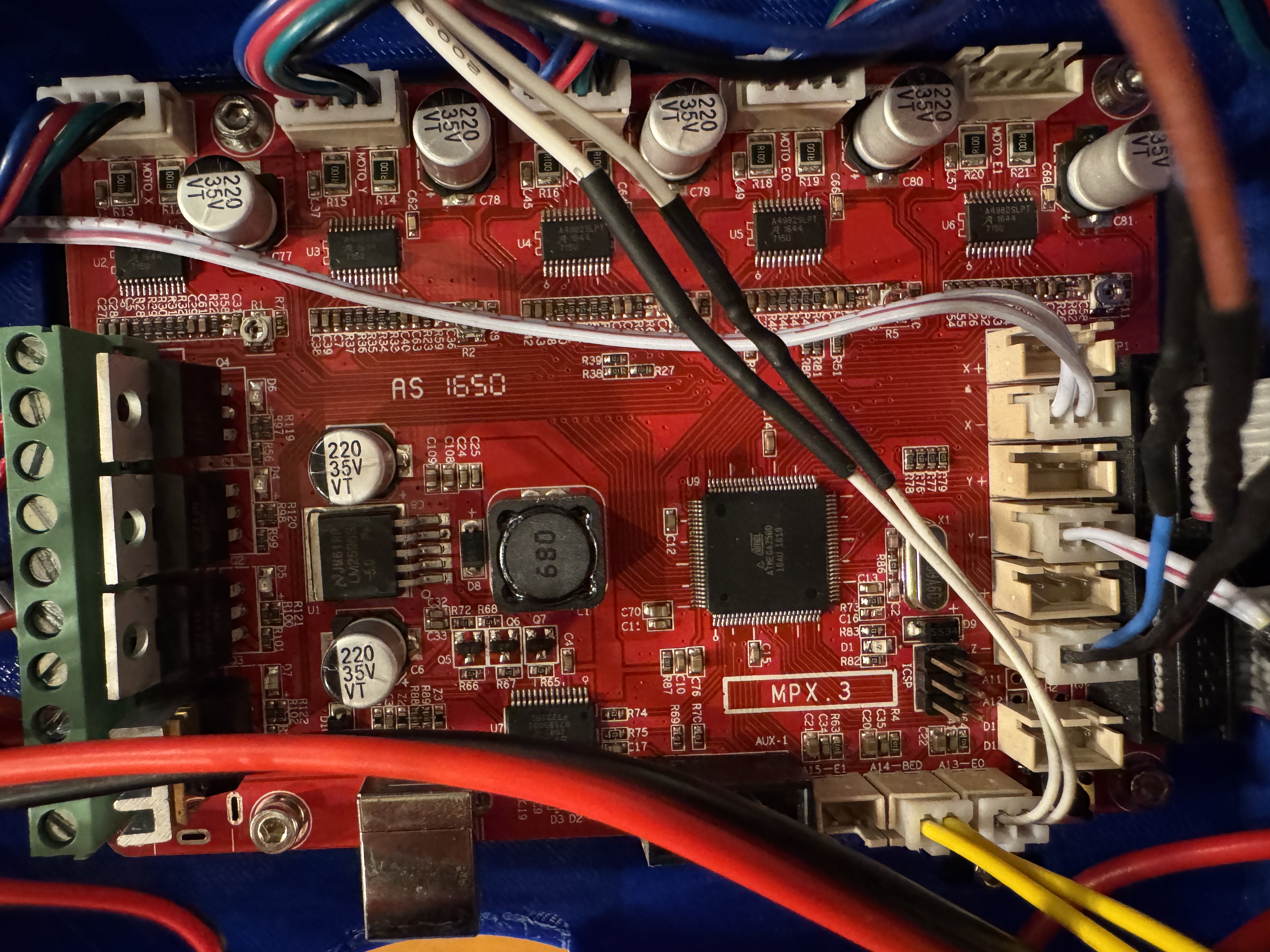

Thanks for your reply. Frustrating is a good word to start with. I think I ruined the controller board. I was trying things, unplugging and plugging in the stepper motors. Now the bed vibrates all over the place rather than moving smoothly like it used to. I consistently have issues with the prints sticking to the bed so I took it apart to reset it up and that was that. I hear people really like the Ender 3 Pro printer and am considering getting one of them to remove the frustration factor. I still want to learn more about the ins and outs of 3D Printing hardware though.
Is it possible to "talk" to the printer like using telnet or ssh or some other command line method? A way to query the device and look at settings, etc.
Posts: 1494
Re: Shout out to any new folks that may be here!!!
Lets start with checking the controller post a picture of your controller board.
It will require a simple Digital Volt Meter
Then we will check the V-Ref to see if the controller itself is correctly adjusted.
After we can determine test the stepper motors to see if they are in working order.
I have the picture of the controller board. If you want me to remove the wires I can.

Well that is a Hictop 3DP controller board.

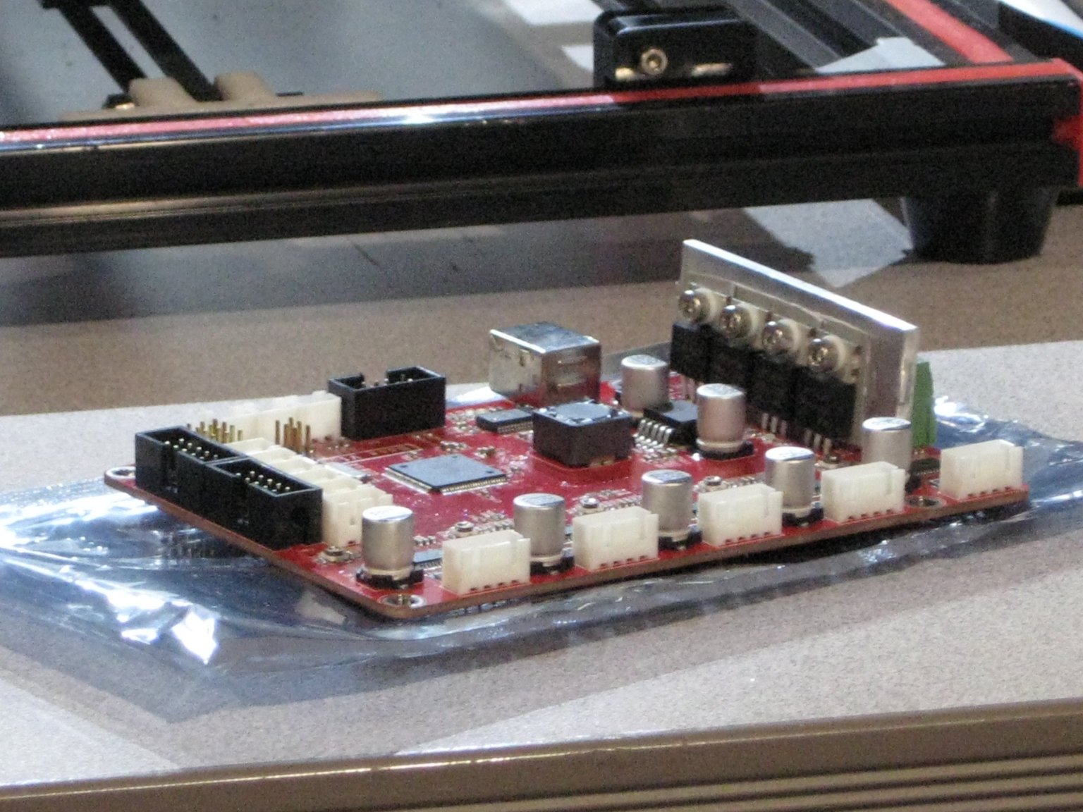

Below is my modified controller ("Added a strip heat sink")
I purchased at ACE Hardware store piece of 3/4 inch Aluminum Flat Bar. Drilled hole for Transistor mounting hardware
This controller can be replaced with a Arduino mega 2560 and Ramps 1.6 easily with no changes to firmware.

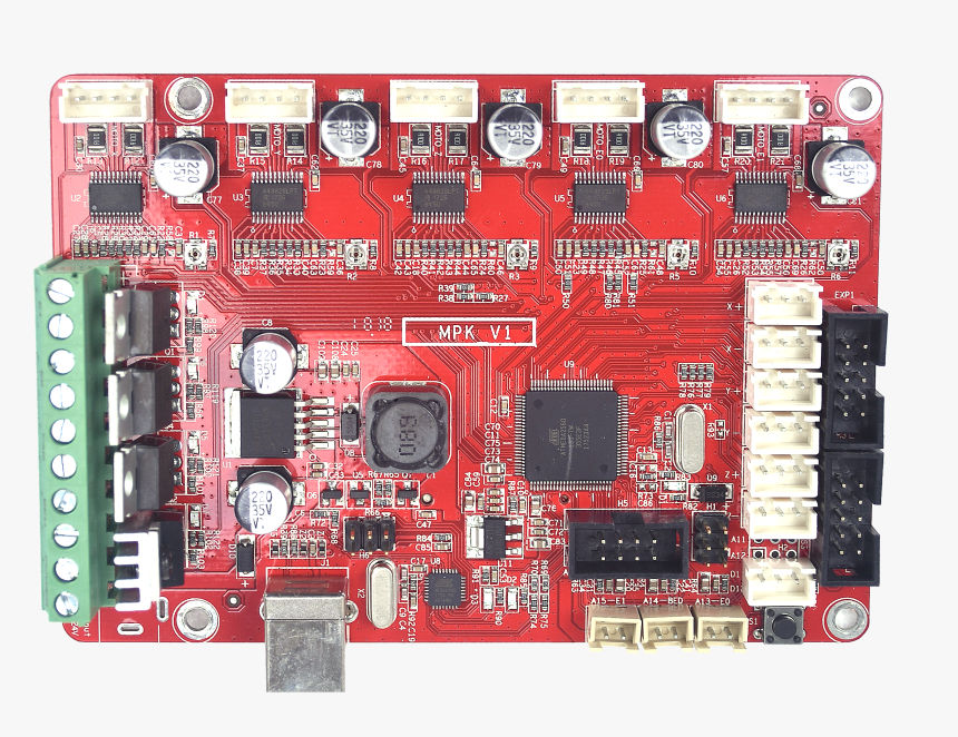

I covered this in the forum showing all three controllers Hictop used that I seen.
I have programed 50 + version of Marlin firmware for these controllers.

Oh cool!! Putting a heat sink on it is that easy? Is it necessary? Do those power devices get that hot where they would need a heat sink?

I felt it was necessary for me to add the heat sink to all three of my Hictops controller boards.

Actually they get quite hot though but why take a chance.
Hictop dose not list the board on its website anymore, though there are many controller boards that could be used to replace this controller.
I would assume that most boards could be used because once you select the Mother board in Marlin the new board pin-out is selected.
You still may have to tweak code a little to get to function correctly though this to should be easy enough.
I purchased a BIGTREETECH Octopus V1.1 Control Board as my next replacement though have not killed the Hictop controllers so never tested my configured Marlin code, Have tested the Arduino mega 2560 and Ramps 1.6 work great
