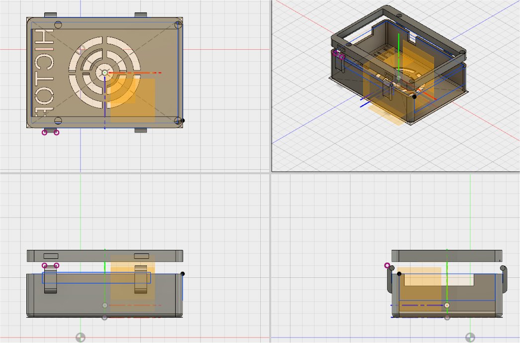

I Posted this design for the Hictop Controller board.
