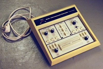

The Heath-kit ET 3100 I have has been around thru many circuits that have been designed over the years.

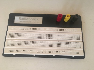

Radio Shack used to have a PCB that look exactly like the Breadboard. This is what I used for my first TTL discrete circuit digital Clock.
