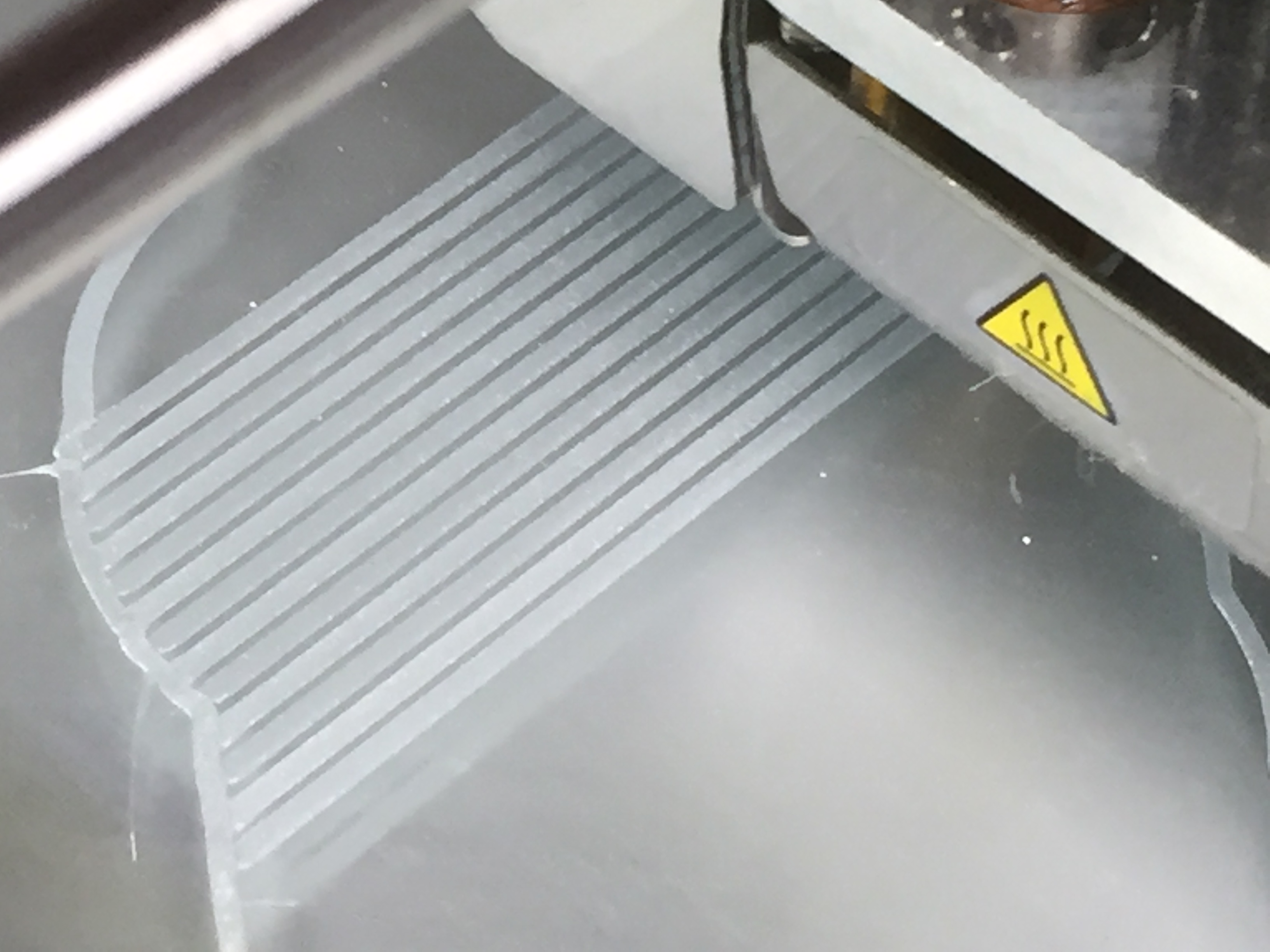

Raft with air option was suggested by tinkergnome
Here we go.
First portion of first layer. 232C bed 80C. Will lower to 230.
Posts: 4077
Setting changes from last time....I just lowered print head temp to 230 and bed to 77
Boy the print time went from 15 hours to 24 according to the machine!

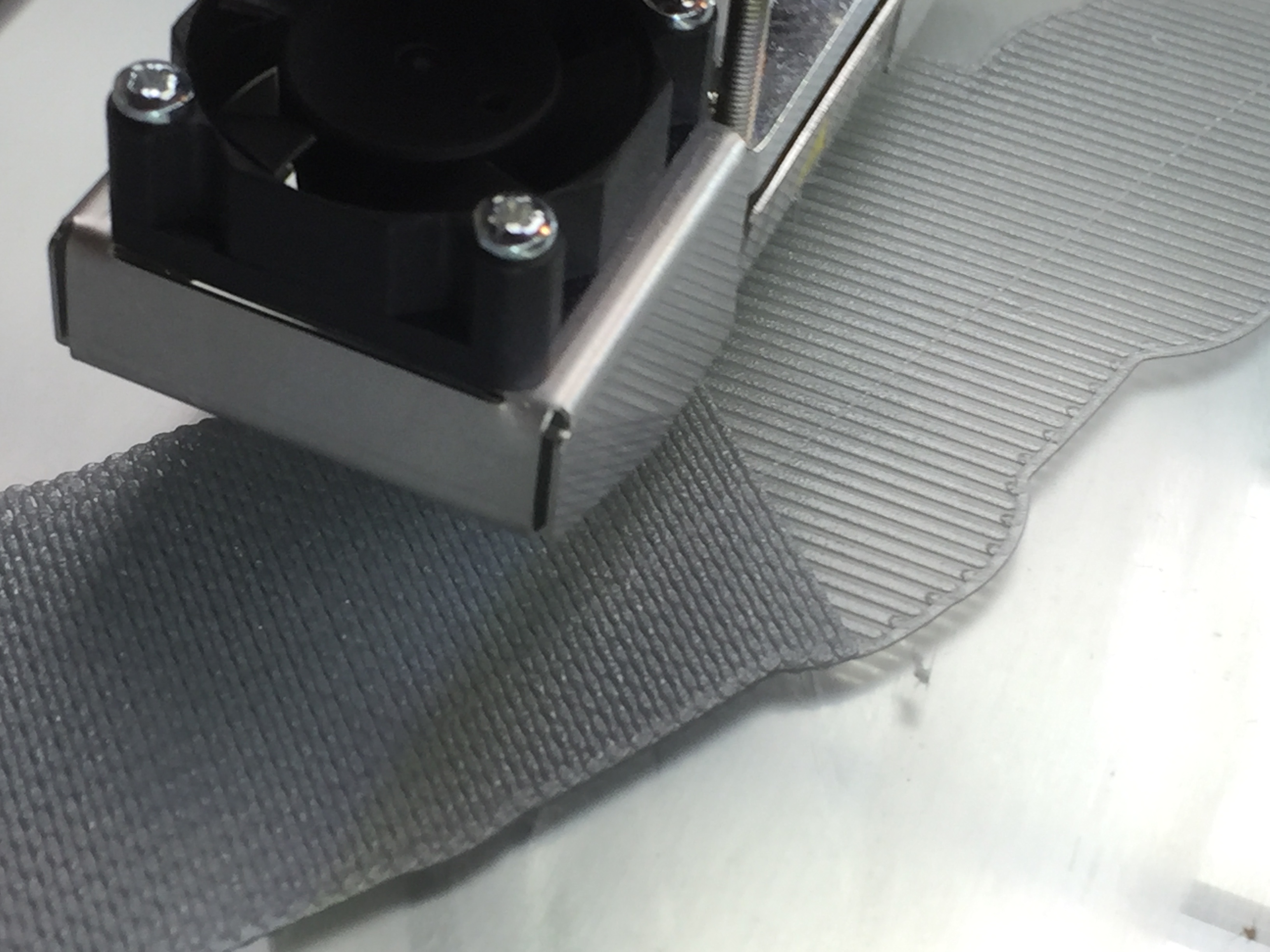

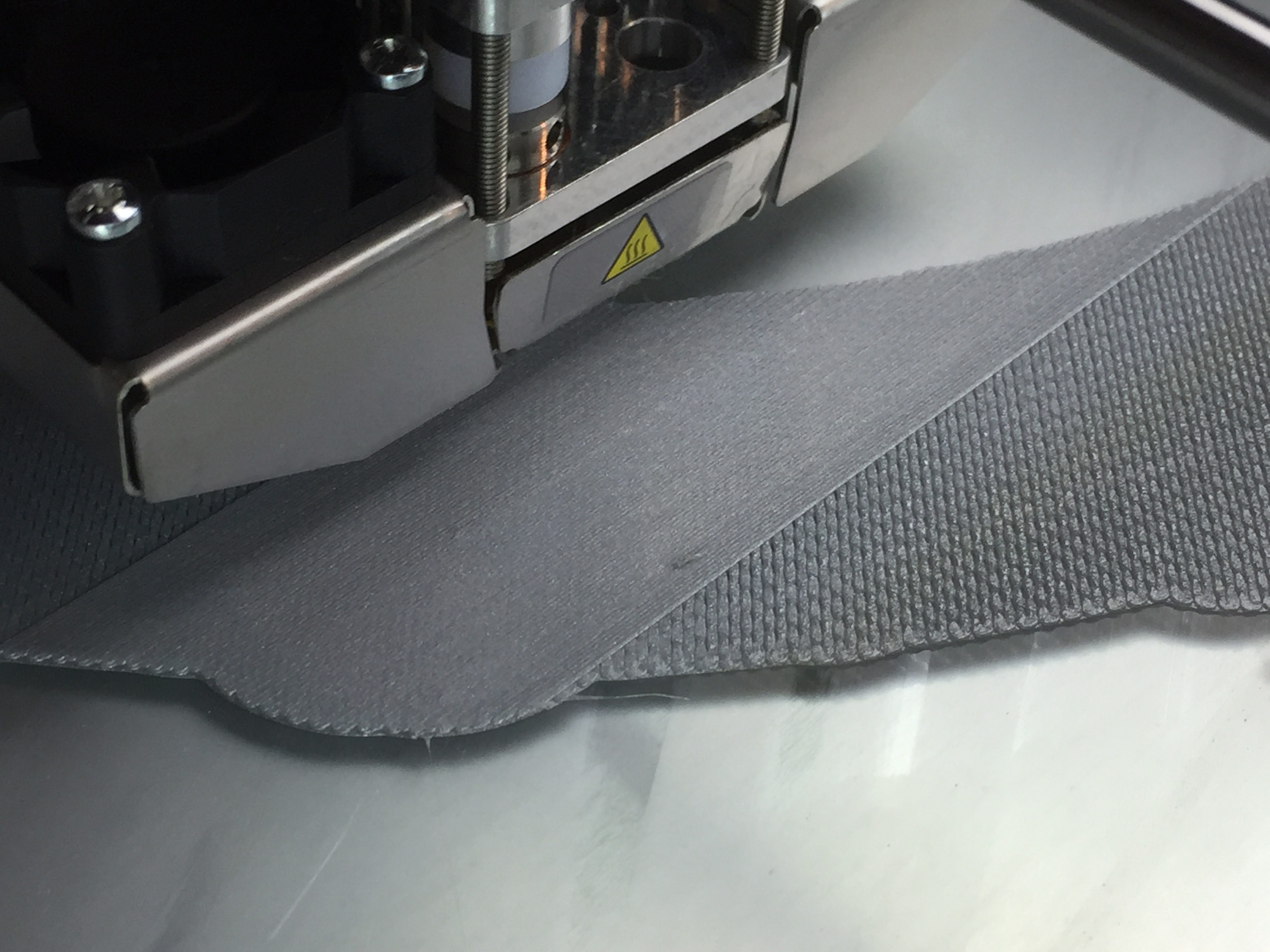

Layer two and three
Yea raft is a click and forget about time. The separation will give you trouble if the bottom touches the print that's why I suggested just raft. The airgap cut yo 0 will work perfect only with full support firat layers, otherwise the print won't separate from print.

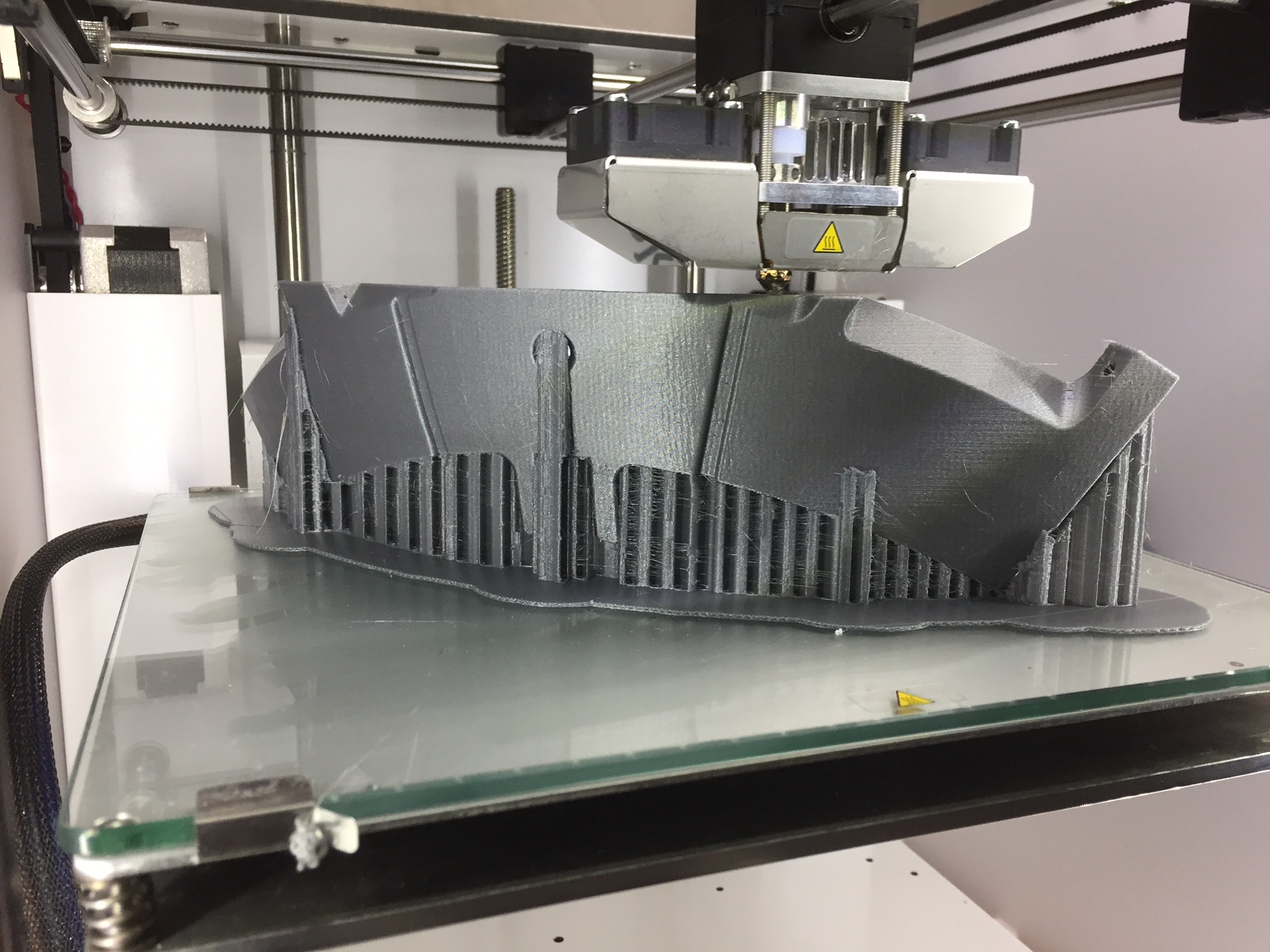

Here's the print as it goes now....2 hours left...so it'll have to finish while I am away at work.
I don't think it'll be too awful to remove once done

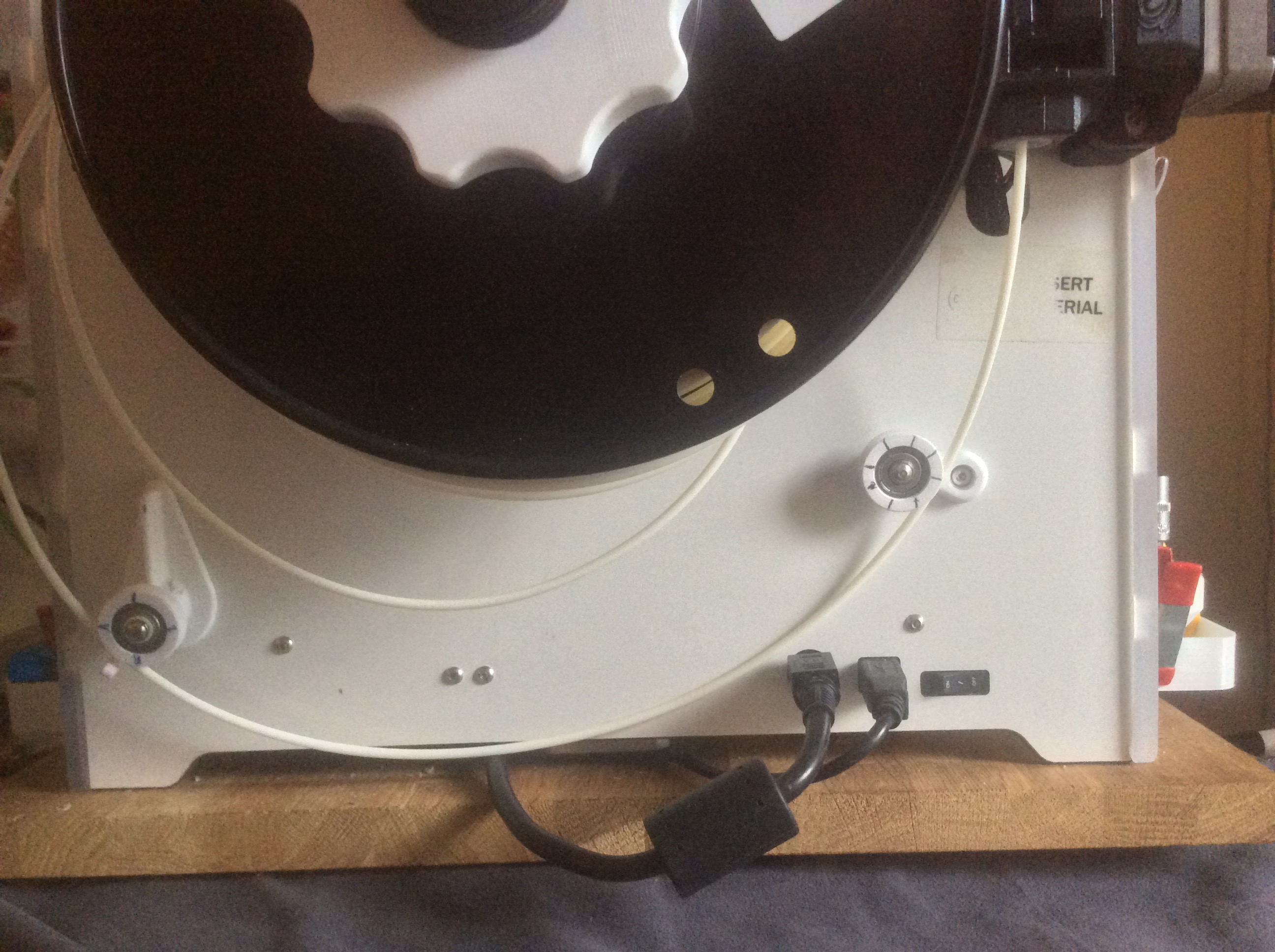

Posts: 4077
The back of my UM2 doesn't have where the old filament spool guide would connect
So...I need to use this one....anyone else use it?
https://www.thingiverse.com/thing:1245216
This was my bearing guide set up before I fitted the Bondtech feeder, I'm about to redesign it to better suit the Bondtech setup.
I will redesign using the screwholes and not the UM2 filament guide mounting hole so that it can be more universal.

LePaul wrote:The back of my UM2 doesn't have where the old filament spool guide would connect
Sounds strange... why would your UM2 not have it? Can you sent a picture of how that area looks like on yours? I wonder if they changed the backplate during production.

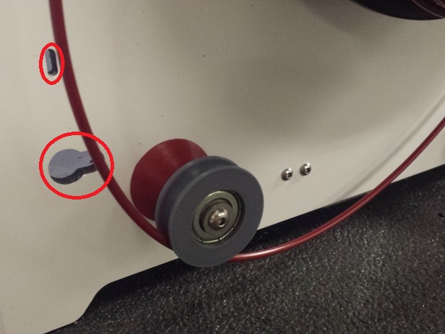

Posts: 510
Location: Stuttgart, Germany
Post by reibuehl »
For the original guide and the one with bearing that I use, only these two wholes as marked on the picture are needed:
