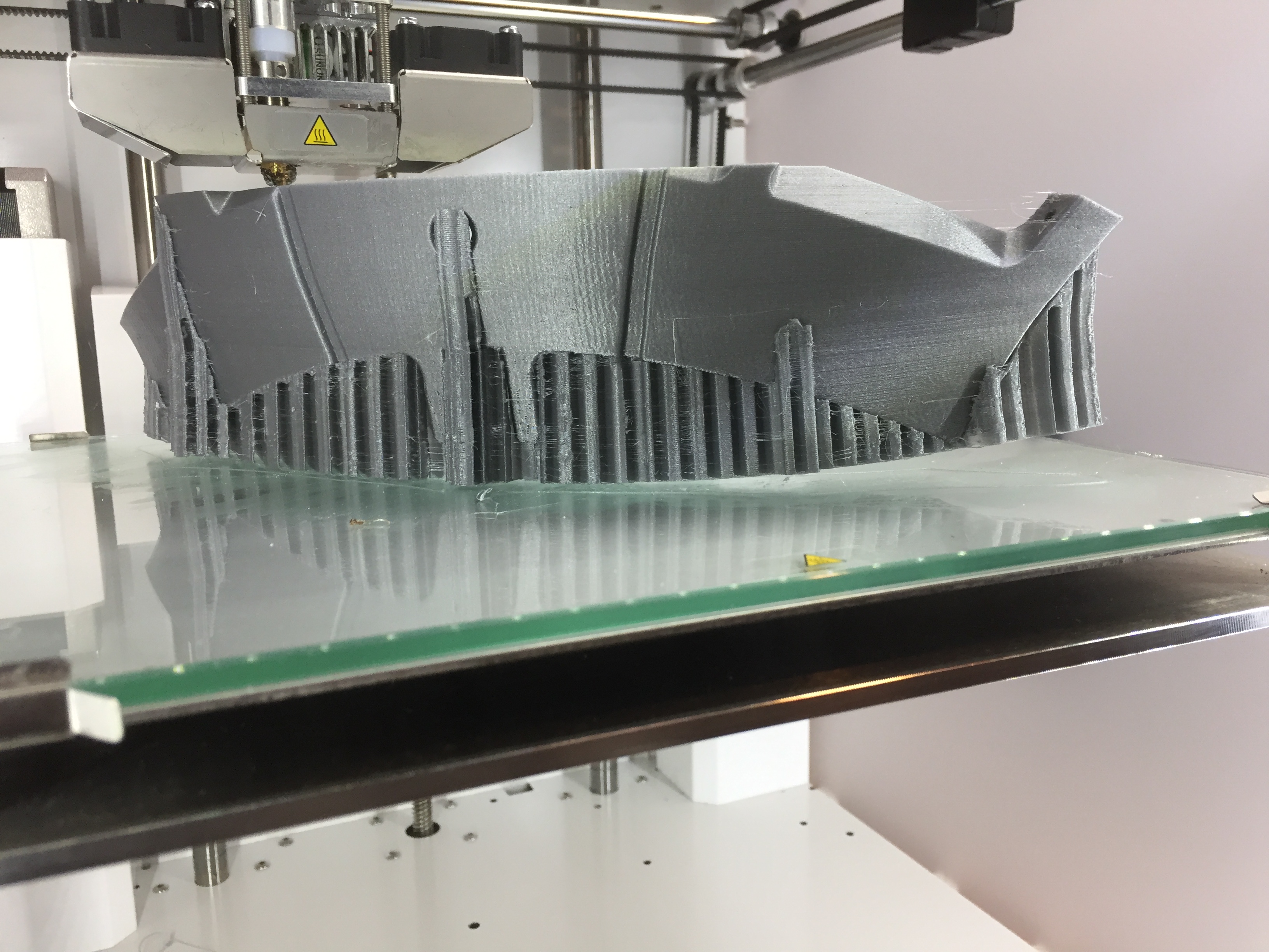

Woke up this morning and look at how awful this print has lifted....
Maybe you just need some brims to keep the supports from compressing. Also, Dunno what filament is that, but I would just trash it =)
Or... Paper tower + windowcleaner + 1 hairspray puff, and clean the bed with that (after having all that glue you have with soap to leave the glass as new)

Well it has happened with two different spools of Ultimaker PLA and this latest is nGenNeotko wrote:Maybe you just need some brims to keep the supports from compressing. Also, Dunno what filament is that, but I would just trash it =)
I'll take the dishwashing soap to the glass and clean it up.
I'll unscrew the bed leveling knobs and check the heated bed connector

I've been doing some research, since this is failing on multiple filaments...
Maybe I just got lucky on the first two prints that worked. The rest have all failed.
zhop helped with the rumbling but I think it boils down to the print is coming off the bed.
Should I be adding brim? The entire base of the print is support material. How much? Distance? Line count?
There's a lot of posts about the first layer being hotter than the rest. I don't see a really good way to control this in Cura 2.3.0 It looks like manually upping your print temp through the printer interface might work best.
This print uses all support material on the bottom, so something is going on down there causing the adhesion to fail.

Remember that bed hotter isn't always the solution. For example my pla-tec untils fast at 60C but at 50C sticks better. Also I think that if you want to be sure, you need a brim to grab that supports. After all supports are 0.4 thin and that's very easy to unstick nomatter what.
Also zhop Ofc should help to avoid hitting the print, but IMO that shouldn't happen... but that's for other day.
If you want to click print and forget, use a old fashioned Raft.

Well I stayed within the temperature range posted for nGen, 85C was the top of that margin
Neo makes a good point, those supports aren't holding onto much. Maybe brim would solve all the problems (yet the first two prints worked!)
I removed the glass plate, the heads look flush and the wires look ok. I could remove the aluminum bed and check the screws are all the way in

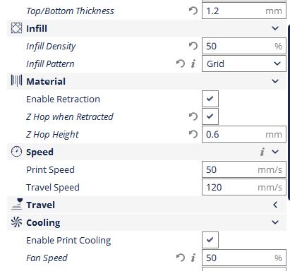

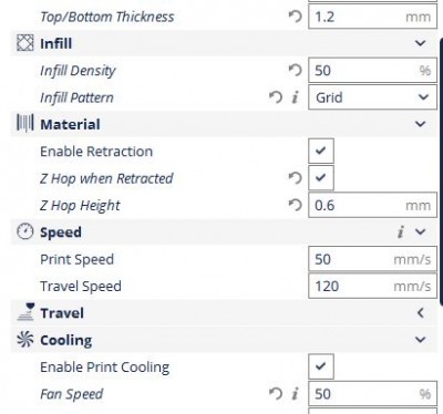

Ok, zhop (despite the noise!) back
0.2 print, 50% infill
75 is what they call for (http://ngen.colorfabb.com/how/)
