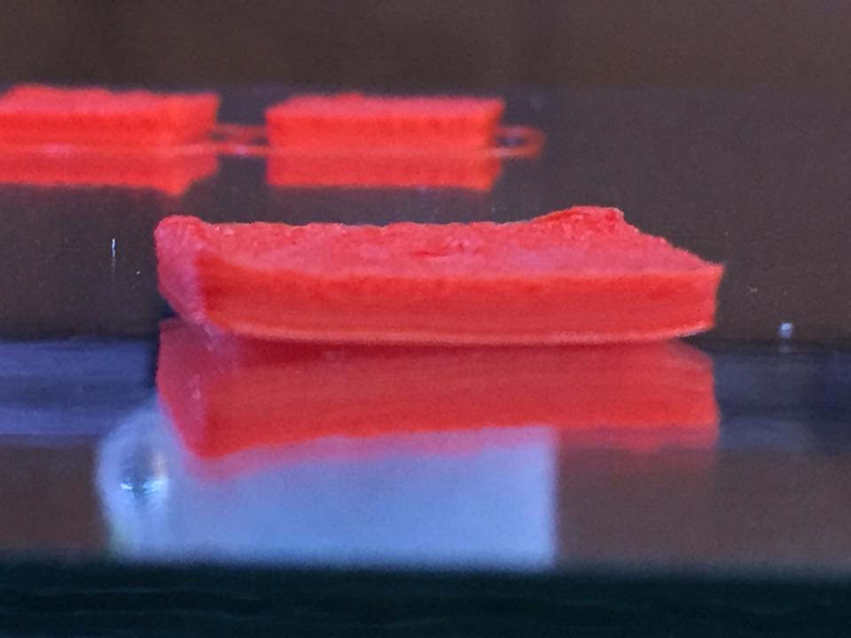

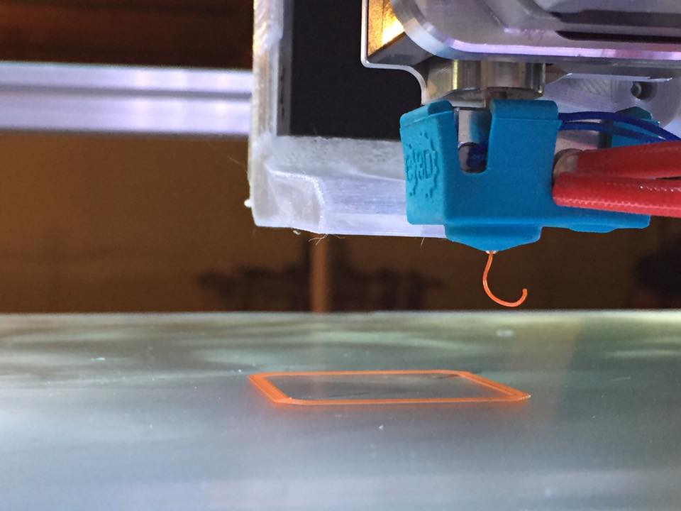

Well I have something very odd going on...despite a good coating of diluted PVA on the bed, I keep having adhesion issues.
I cleaned the mirror off yesterday, scrubbed it good and clean and applied a new coating (10 parts water, 1 part Elmers Wood glue). This same recipe works amazing on the Ultimaker 2+ but we're having challenges on the FT-5
I wish I had a thermal gun to see if the bed is really hitting 60C.
But print after print is coming off the bed. Print temp on the filament is first layer 215, remaining layers 205.

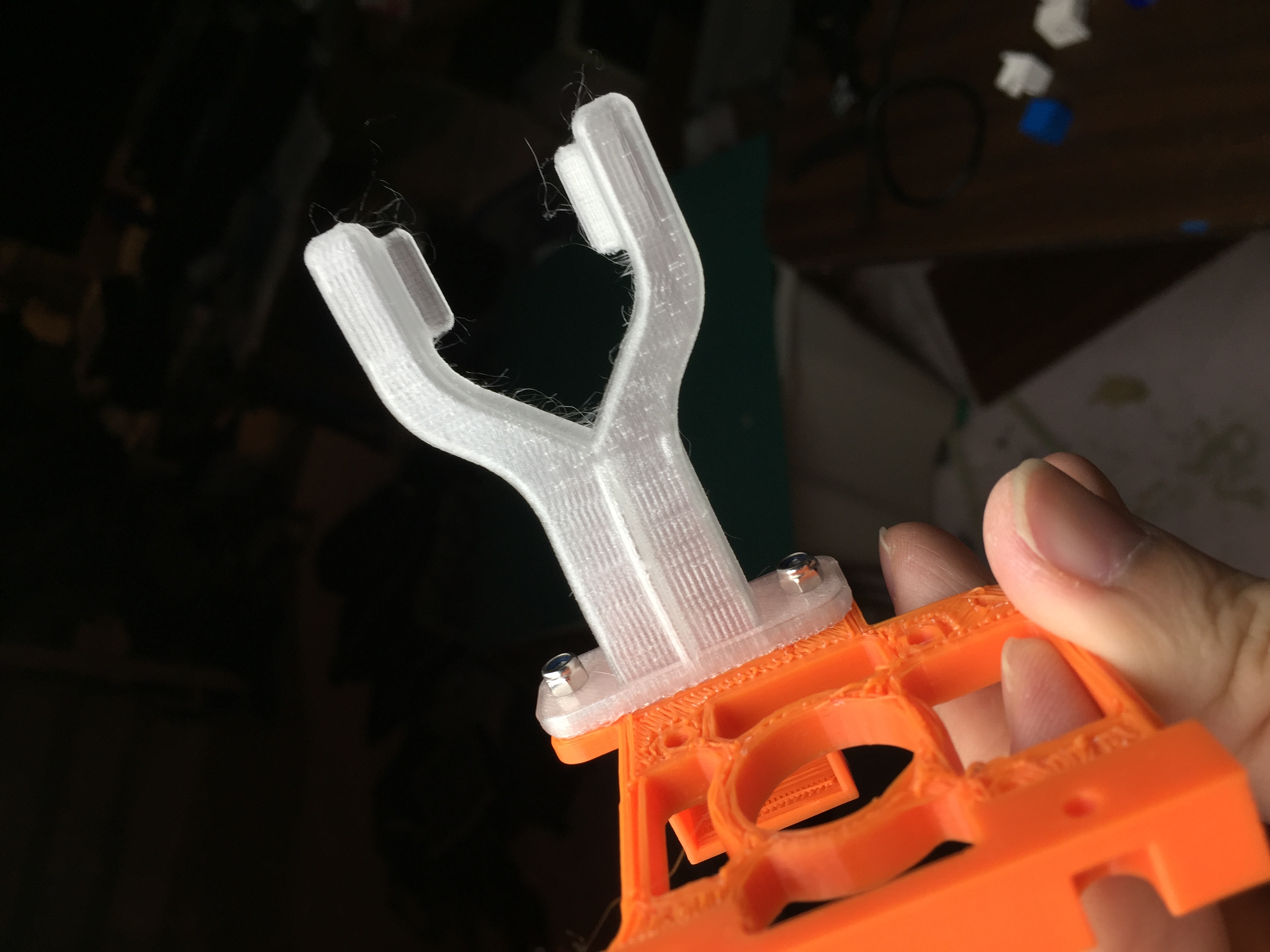

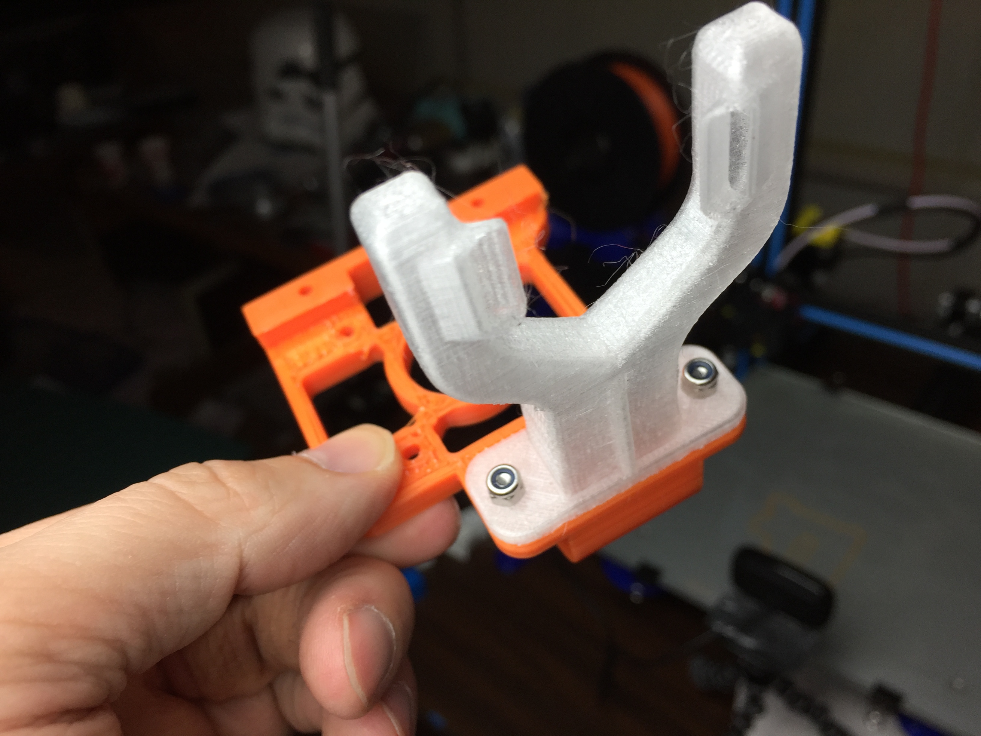

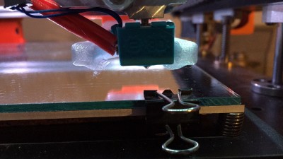

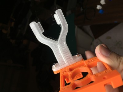

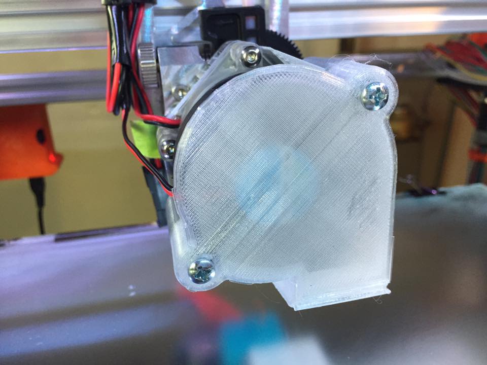

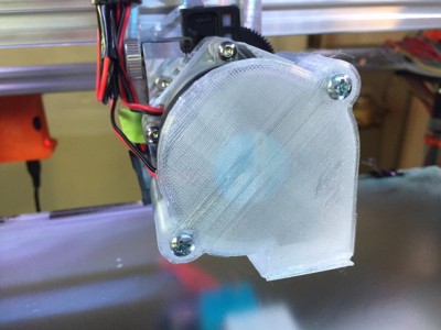

Next up I changed the part cooler again. My friend James and I both have the same setups and we're seeing adhesion issues. We're using hairspray and he runs the bed a bit cooler than me. But both of us would see, like on a thin portion of a part, that would eventually peel up or fly off. I added a slight z hop which helped bit again, the section would let go. We did the same print again but at a much slower speed and the problem ceased. We concluded the slower speed let the part cool down.
To test it out he printed a new part cooler setup and found at 60 mm/s he wasn't peeling up anymore. His duct was moving a lot of air right where it needed to be. And the solution wasn't very invasive to install.
I had to spin my heater block around and opted to use Polycarbonate for the duct portion. It came out pretty nice.

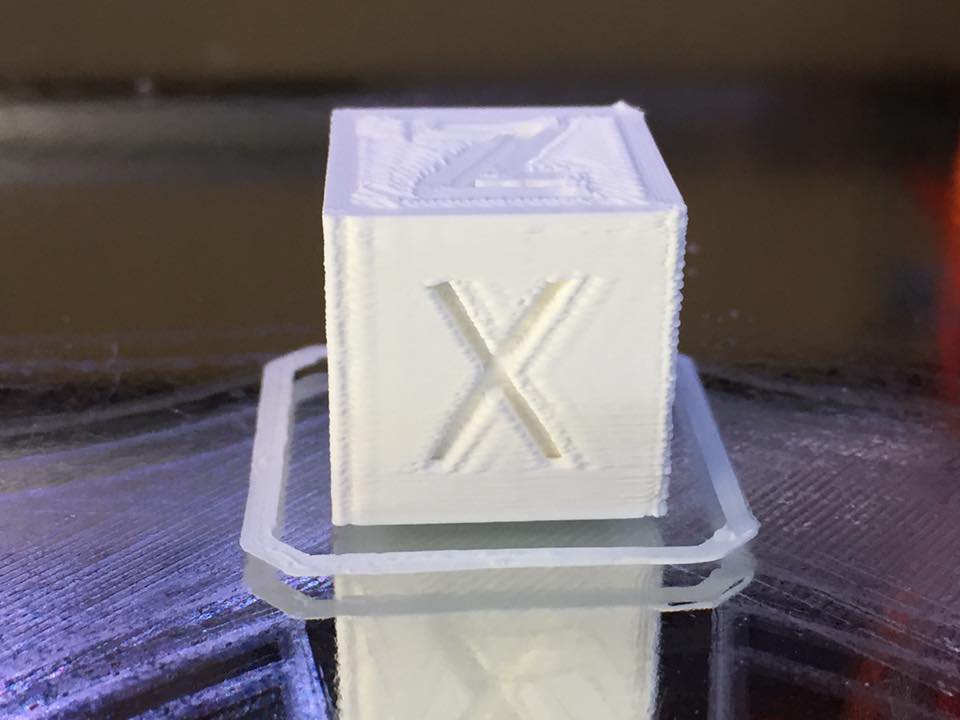

I've still been dealing with problems with prints lifting from the surface, mostly edge curling.
My experiences with the Ultimaker had taught me that this is usually the result of temps. Either the PLA is too hot or bed too hot. However, since this only happened with smaller parts, I was really beginning to suspect my part cooling fan.

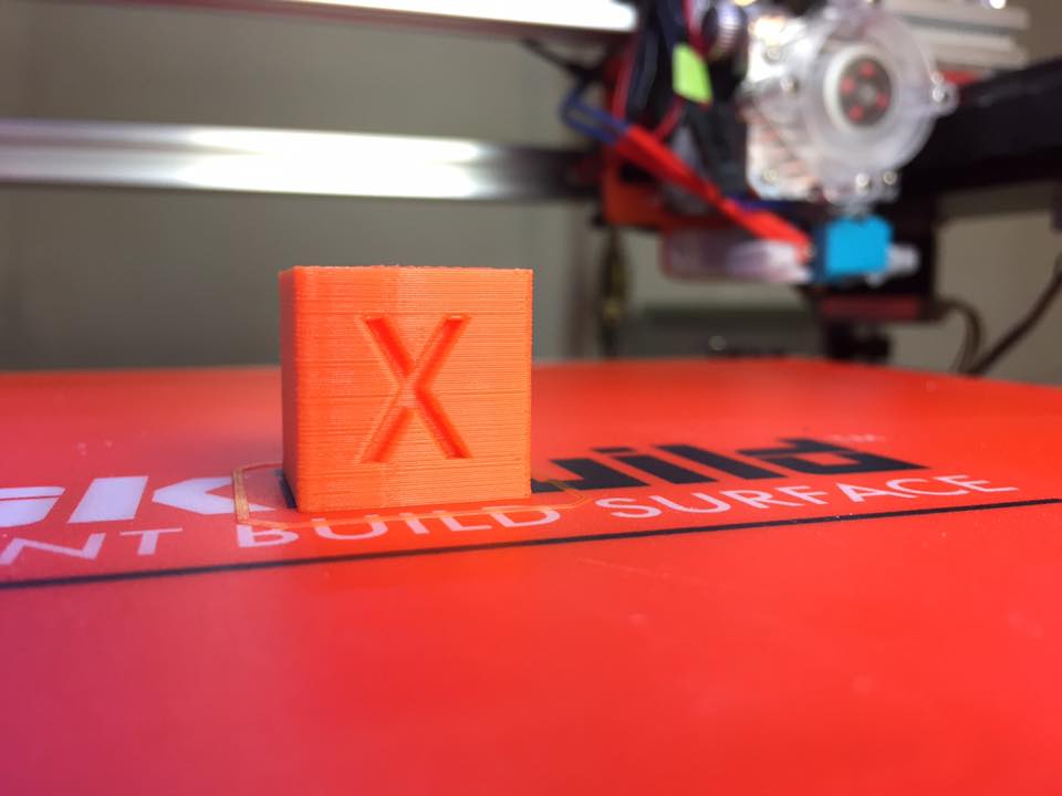

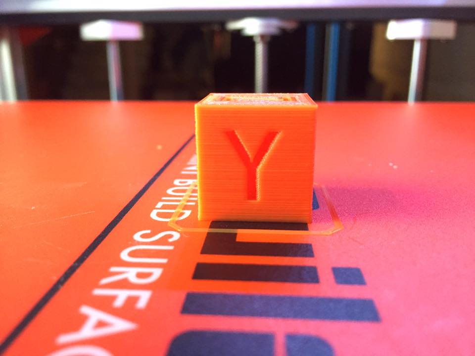

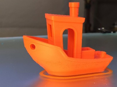

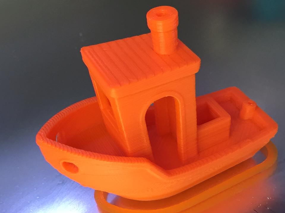

Yesterday I feel like I made enormous headway on print quality. Despite numerous changes to the Acceleration and XY Jerk settings, my prints still had really bad ringing. I posted to the FolgerTech FT-5 group about help refining the FT-5 Simplify3D profile for the Titan Aero. A few people offered some good suggestions. But one member, Derek, made a really outstanding point. He stated Simplify3D v4 really did bad things to old profiles, so make a new one, enter these things back in and try some test prints. The only thing I keyed in were the retraction distance and speed, plus the temps. First layer 215, after that, 210. Bed 60. Fan 100% after layer one.
And, look what I got...
Not quite perfect but the ringing is gone.
While I am hesitant to announce parades for all...he and I are going to see if we can further tweak some more settings and then move on to a few other test prints (different model) and see if we "just might have" this thing on the path or printing good.

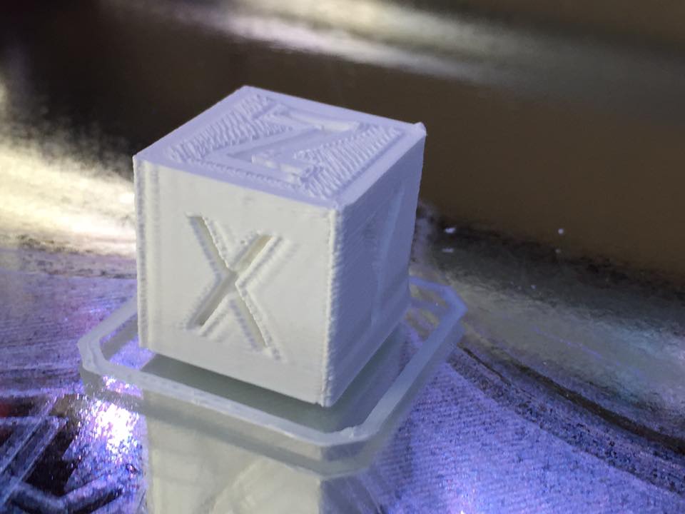

In our last exciting episode, we were delighted the ringing was gone!
But then we noted some under extrusion, or even some missed steps.
I figured it would be a good idea to verify the Extruder stepper driver was at 0.90 as intended. No, it was at 0.662.
Change made, more test prints....and now...shifted layers! A driver swap from the X axis and we're still seeing shifts. What could this be?
Well, rewind to what we're using...a pancake motor. My friend points out we're way too high in voltage and lower it to 0.55.
We get a good print.

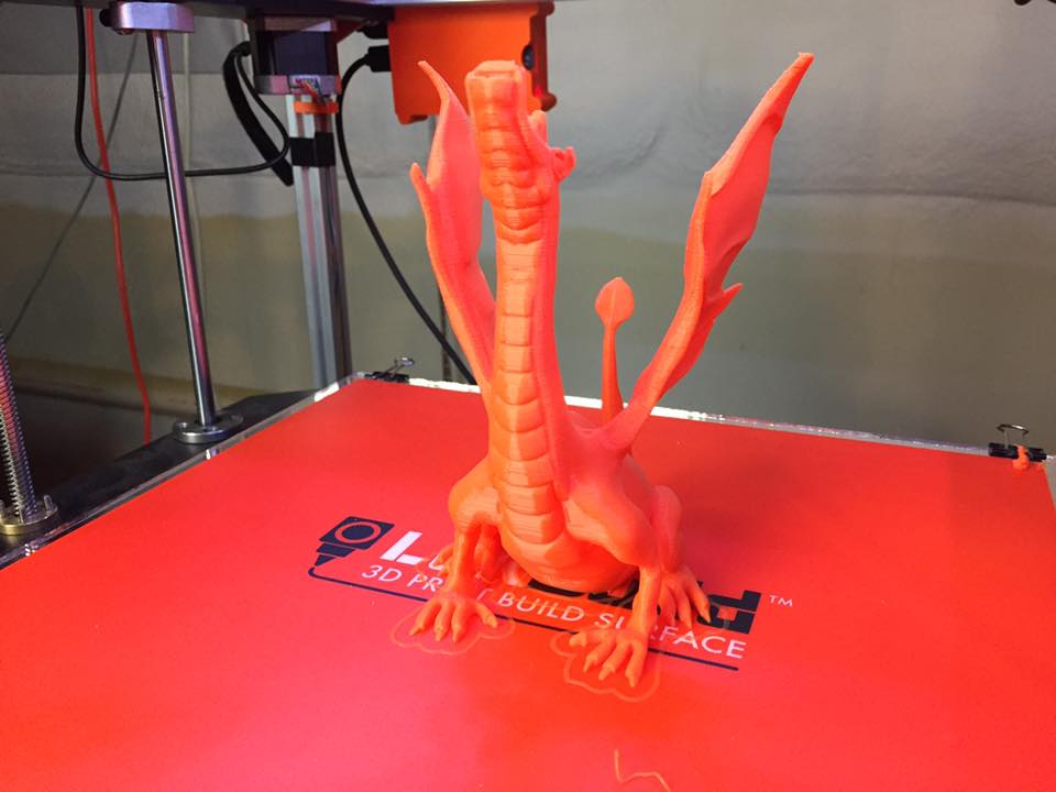

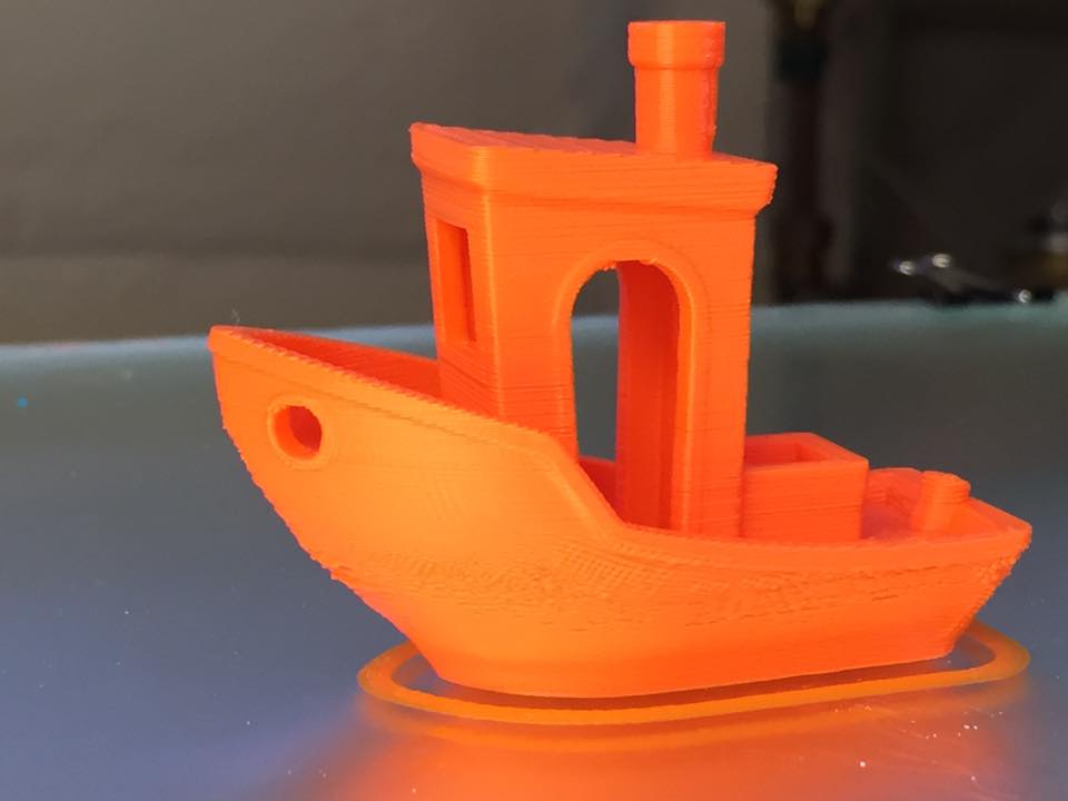

We decide to tempt fate and give the FT-5 a large print...and aside some minor strings here and there from a lousy part cooling duct, it does good!
