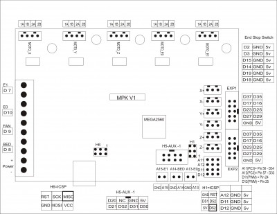

I made this PDF
Hictop Control PCB-2.pdf
(15.05 KiB) Downloaded 903 times
Hope it helps
This was designed for Base 1.3 Board
Some cosmetic differences to the board were made,
This is the closest i have found, Need to create my own board pin-out.
MKS_BASE_PINS.pdf
(141 KiB) Downloaded 827 times
When Board is mounted in 3D Printer
These connectors are the same 5v (Bottom), Gnd (center), Signal (Top)

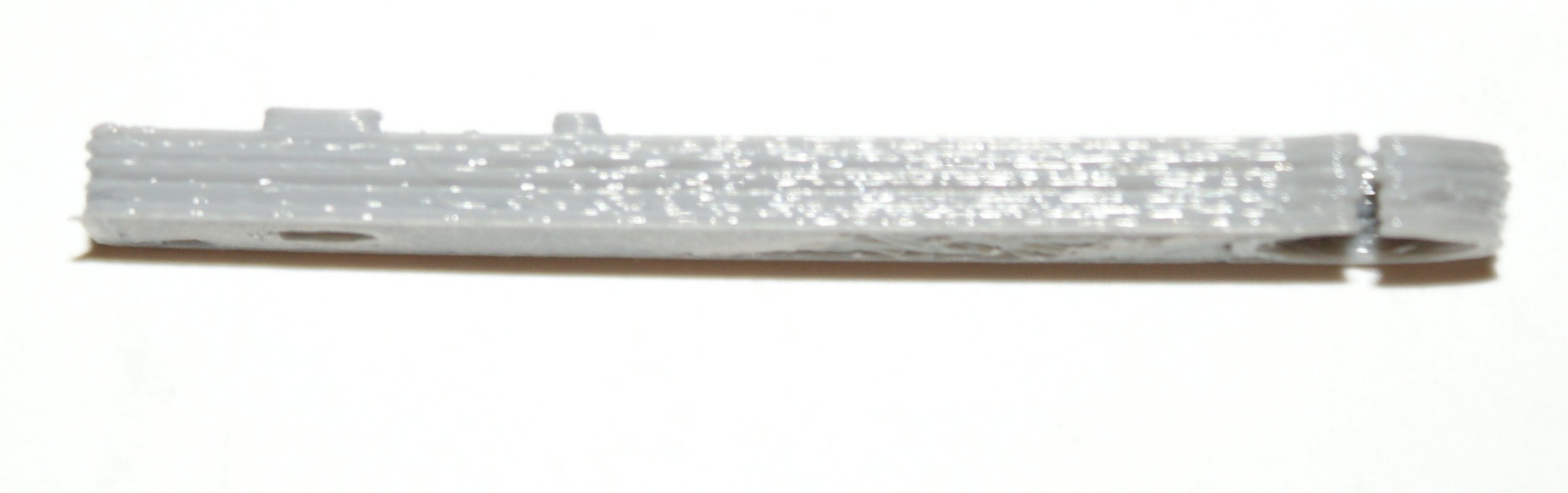

Here is a couple images of the 1st Print and with its lack of quality.
The main reason it is taking so long is because I do not have a decent work place, my workplaces are all full.
I do need to clean up the work space but have so many projects working on at this point...

Though the image show Z+ an Z- that is end-stop pin 19 an end-stop pin 18
Newest Hic-Top Pinout
Last edited by Roberts_Clif on January 20th, 2022, 9:15 am, edited 1 time in total.
Posts: 1494
Re: HicTop 3dp-11 installing a BLTouch as a NewBe
Found the last 6 pins on H6 connector.
H6 is a standard ICSP header, but for programming the ATmega 16U2
Shown in previous post bottom image. Wow One project finished.
This will give the Hictop users a more detailed look at our controllers pin-out.
Older Hictop controllers have basically the same pin-out the connectors have only been re-arranged.

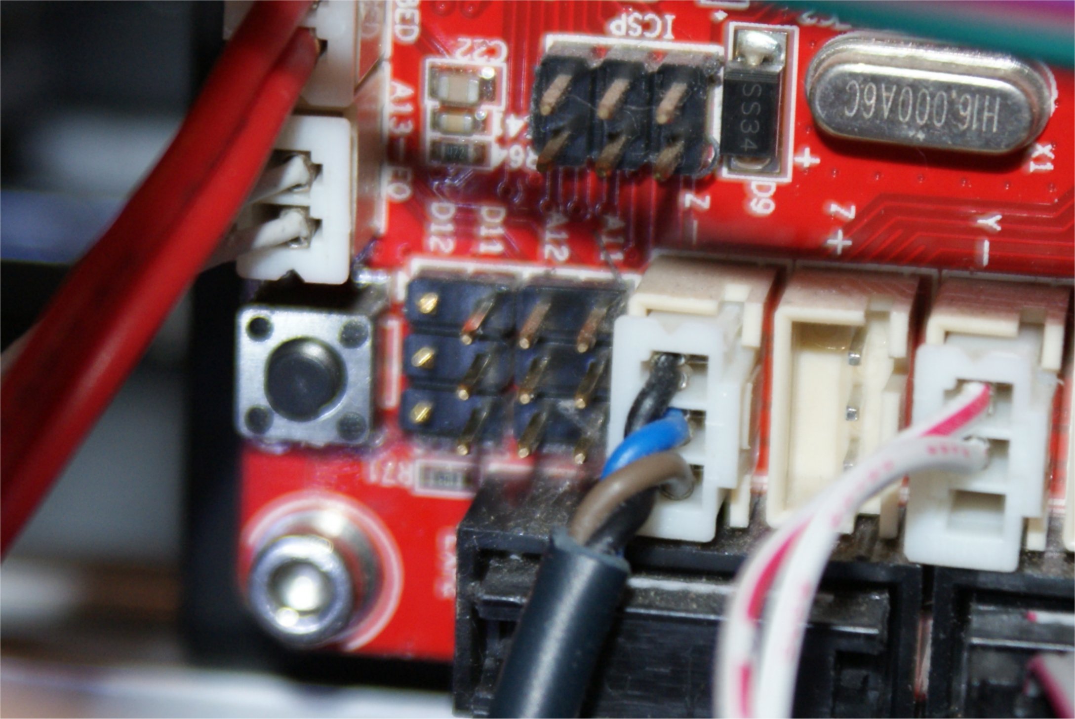

I configured Marlin 1.1.9BF several time today for Bl-Touch with no success.
Could not get the 3D-Touch to connect with D11 Pins so I pulled off the white connector plastic cap.
This exposed all 12 pin headers however 3 pins were cut short seen in image below.
This could also explain why I could never get it to work before, the pins were not long enough.
My 3DTouch has a different wiring needing me to swap my red an Brown wires to correspond with the connections.
When I flashed My Marlin 1.1.9BF-BL an homed it would travel XY then start Z the pin would drop and return to its home position.
Its as if it is already touching the build plates I inverted Z_Min_endstop with no change.
