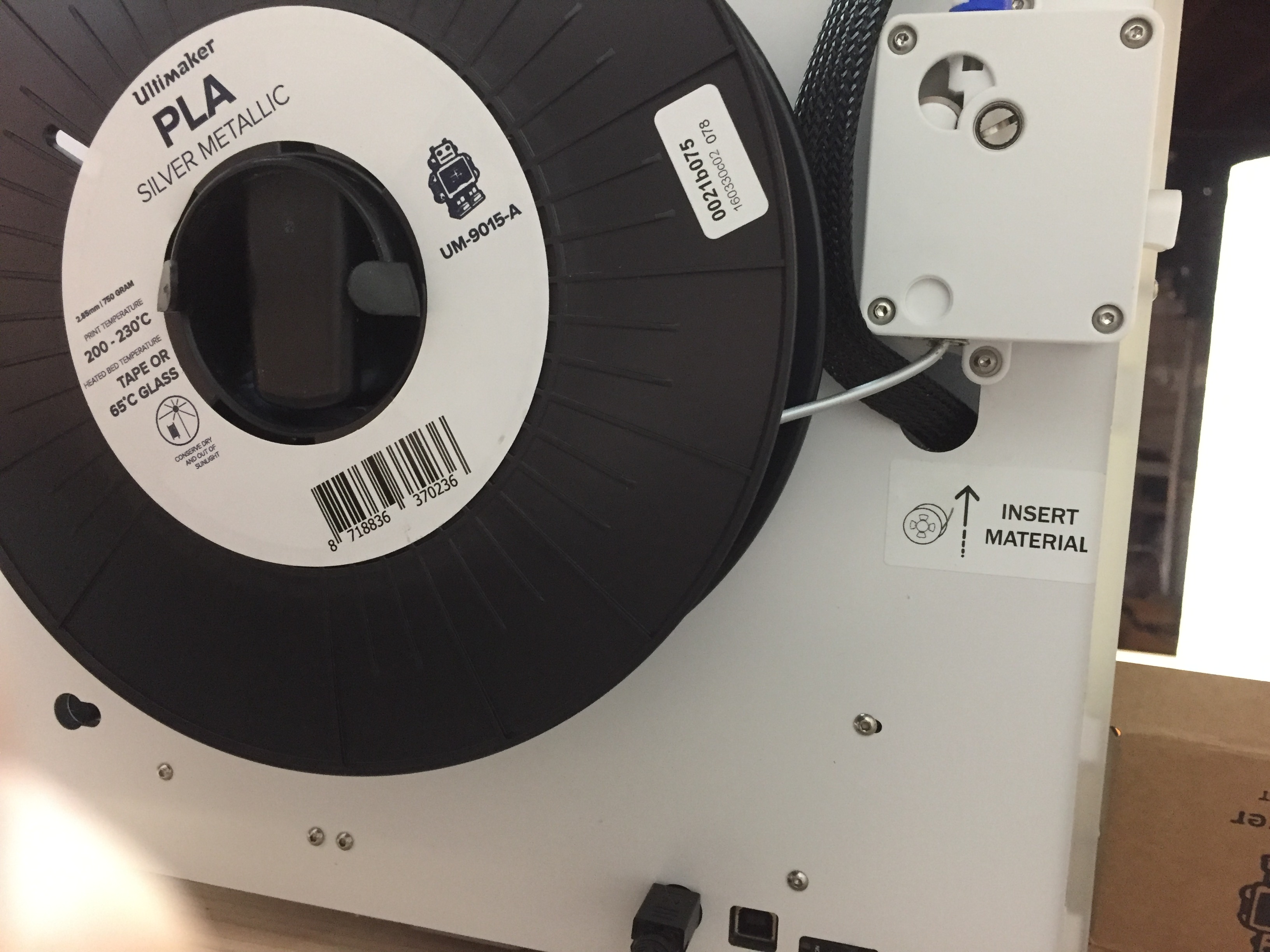

Speaking of the feeder, how do you get into that? And adjust the settings? Press in? Up? Down?
LePaul wrote:Speaking of the feeder, how do you get into that? And adjust the settings? Press in? Up? Down?
This is how it looks inside (don't open it is just to explain)
The screw moves the nut thatmakes the spring be more or less tight. (The indicator on the bottom is maximum pressure and on the top less pressure, don't overdoit on any direction or the small plastic indicator can snap)

Thanks for illustrating that.
I didn't know the screw up top was the adjustment, I thought the knob was

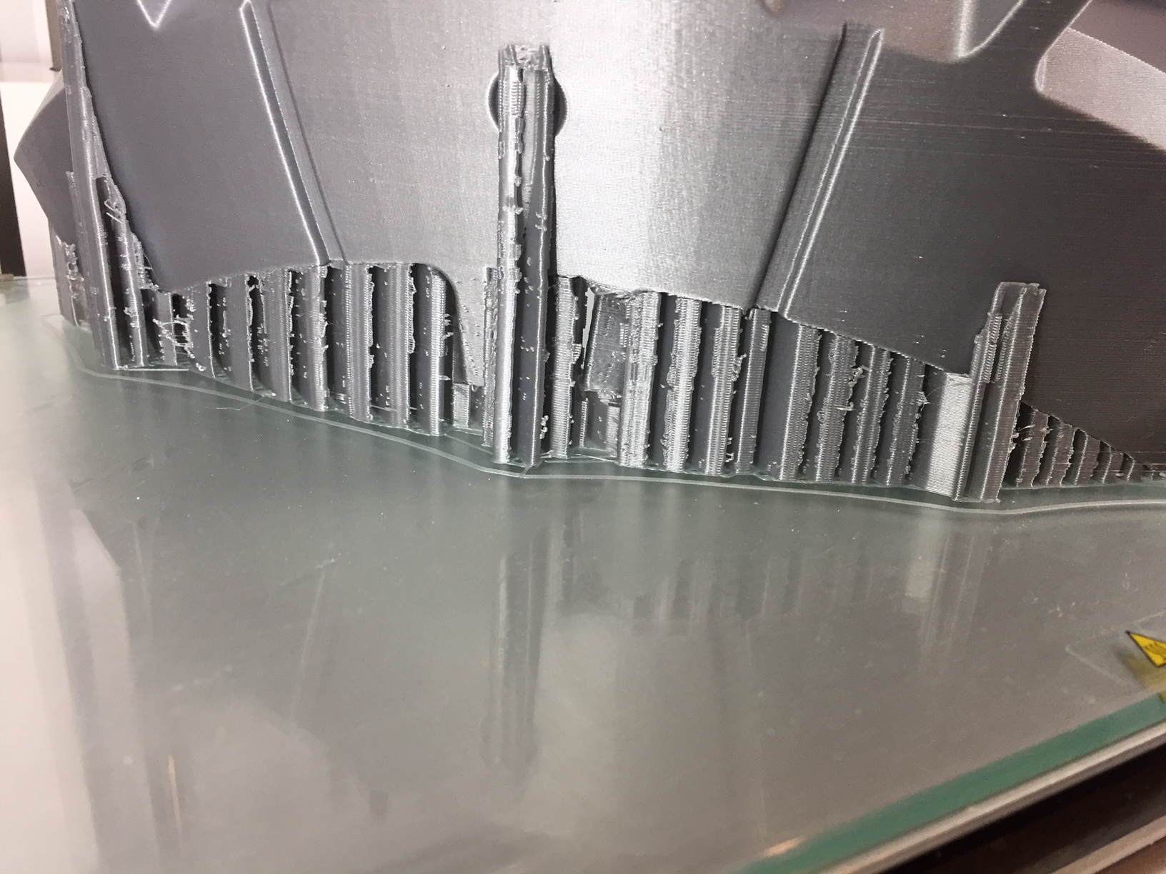

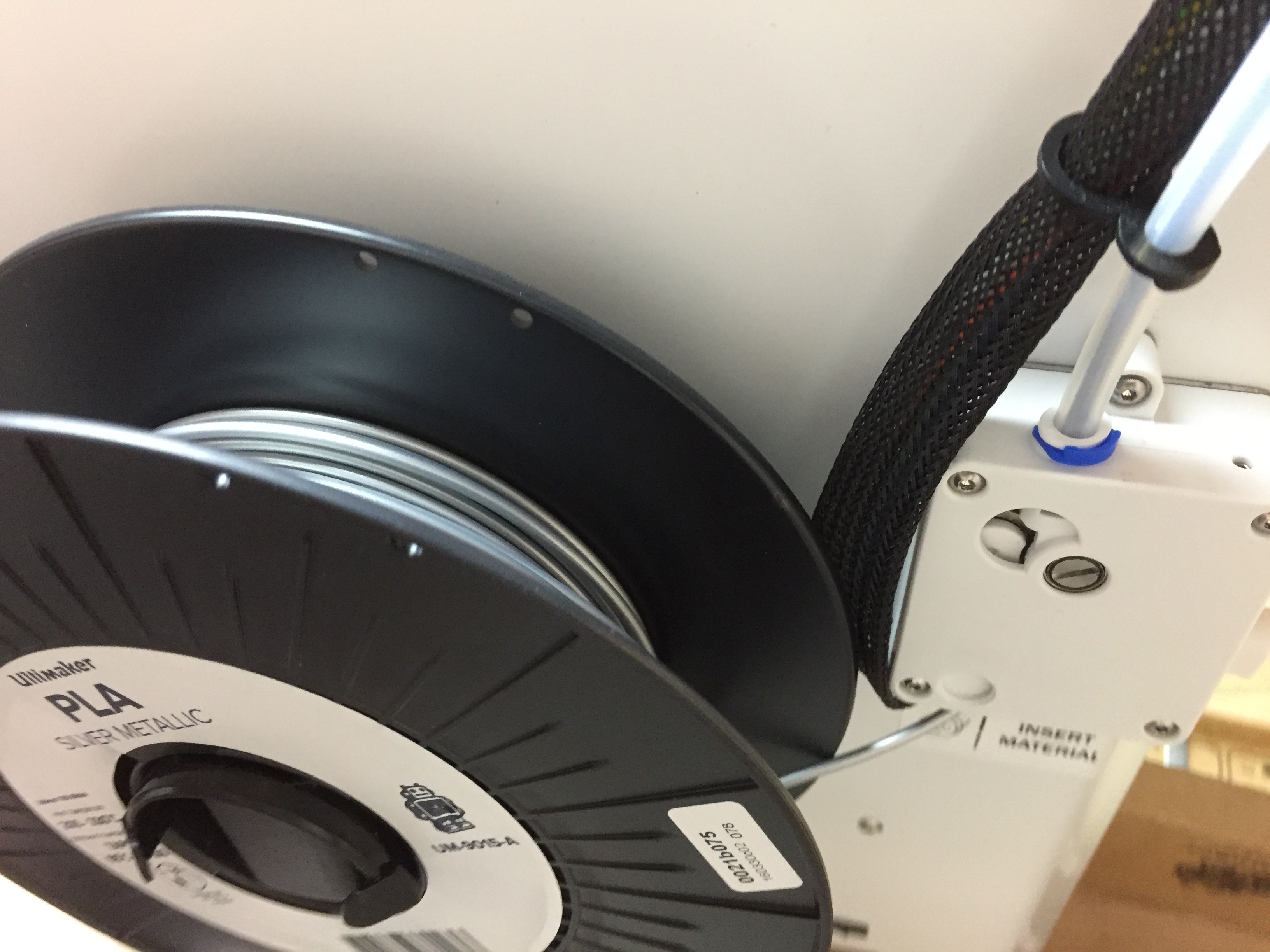

Another evening, another failed print.
The machine failed on the support material. Then the filament in the spool jammed itself up, causing the feeder to strip the filament and jam
- Posts: 510
Sorry, but why don't you at least print a simple pure plastic filament guide like the one that was shipped with the UM2 before you start more of these large prints?

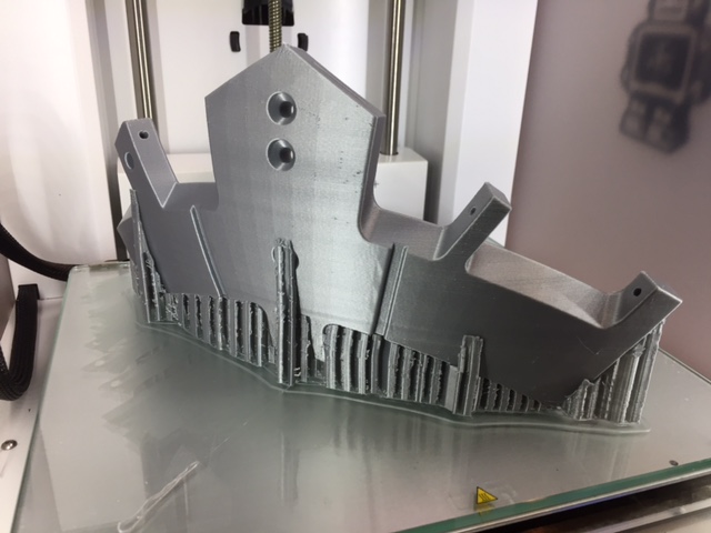

Here's what a successful version looks like
I'd use a lower filament guide, Roy are adding friction and therefore requiring more force from the feeder to pull the filament in.
Also print off Roberts bearing filament spool, print off the longer spindle to take fatter spools.

Well UMO extruder is powerful but so it is the um2+. But ofc UM2+ hotend need's more force than umo (smaller hot area vs bigger hotzone). Anyhow I never got that problems with my spools because I spool them myself. You could just cut the metters needed and leave them on the ground or on a lazysusan, a piece like the one you print must be around 10-15m?

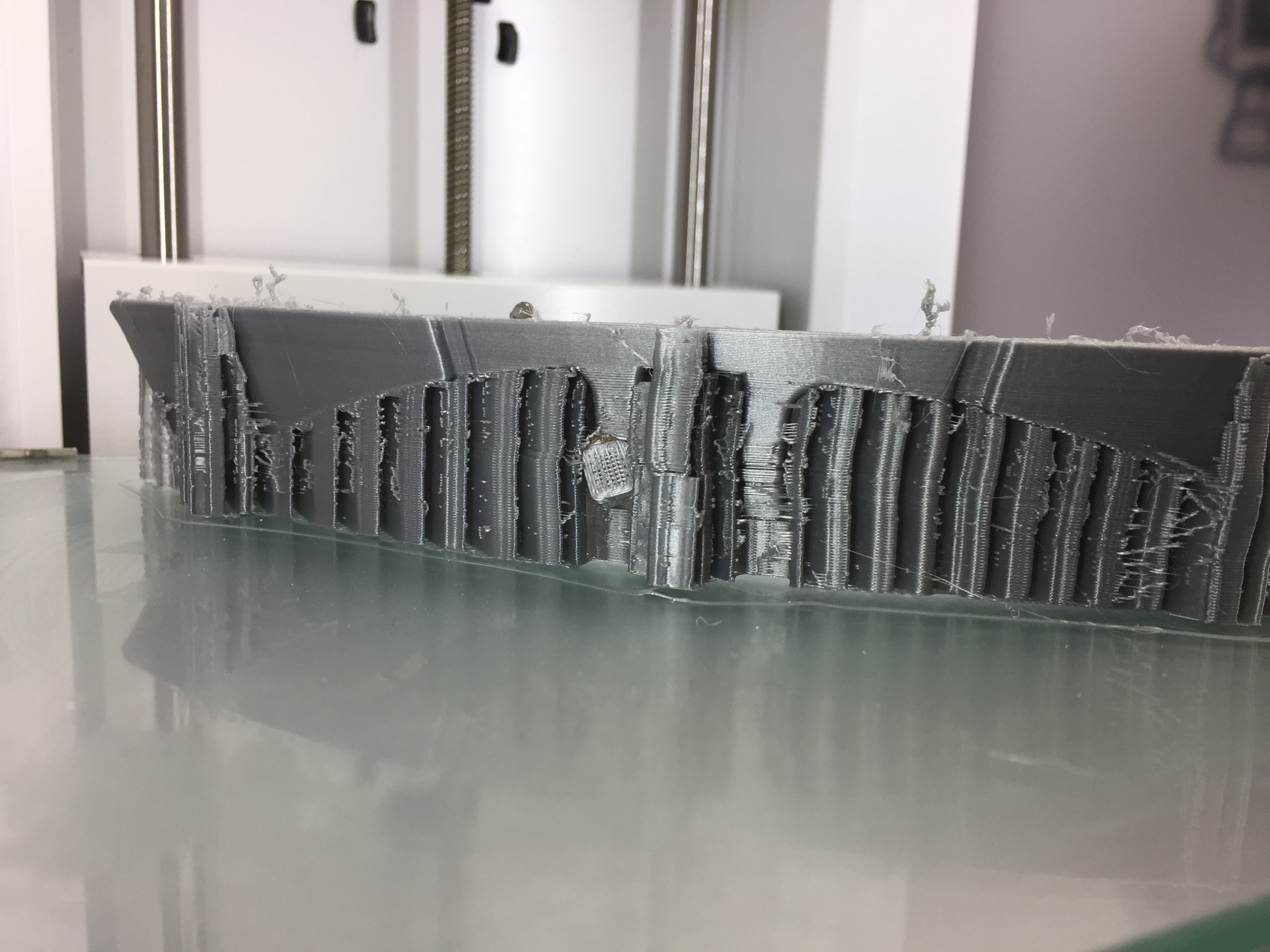

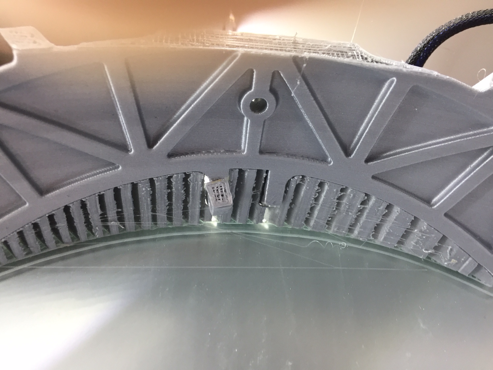

I did up the temp as you suggested by a few degrees (3C) but the support looks very stringy

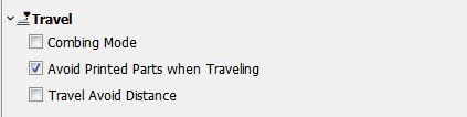

I took a suggestion from the UM board, about the "bumping" i was hearing during the previous print and checked this on...
