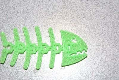

- Posts: 1387
I have from time to time when using multiple Slicers mess up My 3D Printer Marlin Firmware (I know most are using Teacup).shurik
Just Yesterday I Was Testing to see which of the Slicers would Allow me to send G-Code to the Printer.
When I started printing a Model it looked like Swish Cheese See Image.
Some how just by connecting and sending a couple of G-codes (for testing purposes) I mess up the Printer Filament Size.
And until I had sent a M502 and M500 every print looked the swish cheese.
Maybe something like this could have happened.
