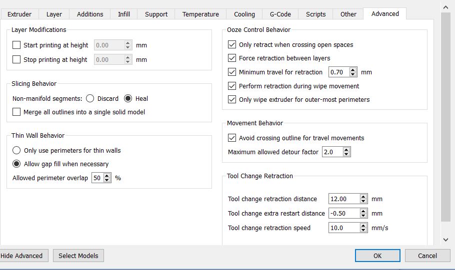

Okay, here's what my settings are...let me know what you think?
One thing I spotted was the retraction distance was 0.70 Perhaps up that to 1.0 ?
And you suggested unchecking the "Only retract when crossing open spaces", correct?
Re: Coast at End
The more you raise that, less retractions will occur.
Yea, disable that, but mind that will increase the retraction amount (bad feeders can grind).

I'll leave the distance alone
I will do a test print with the 'Only retract when crossing open spaces' disabled

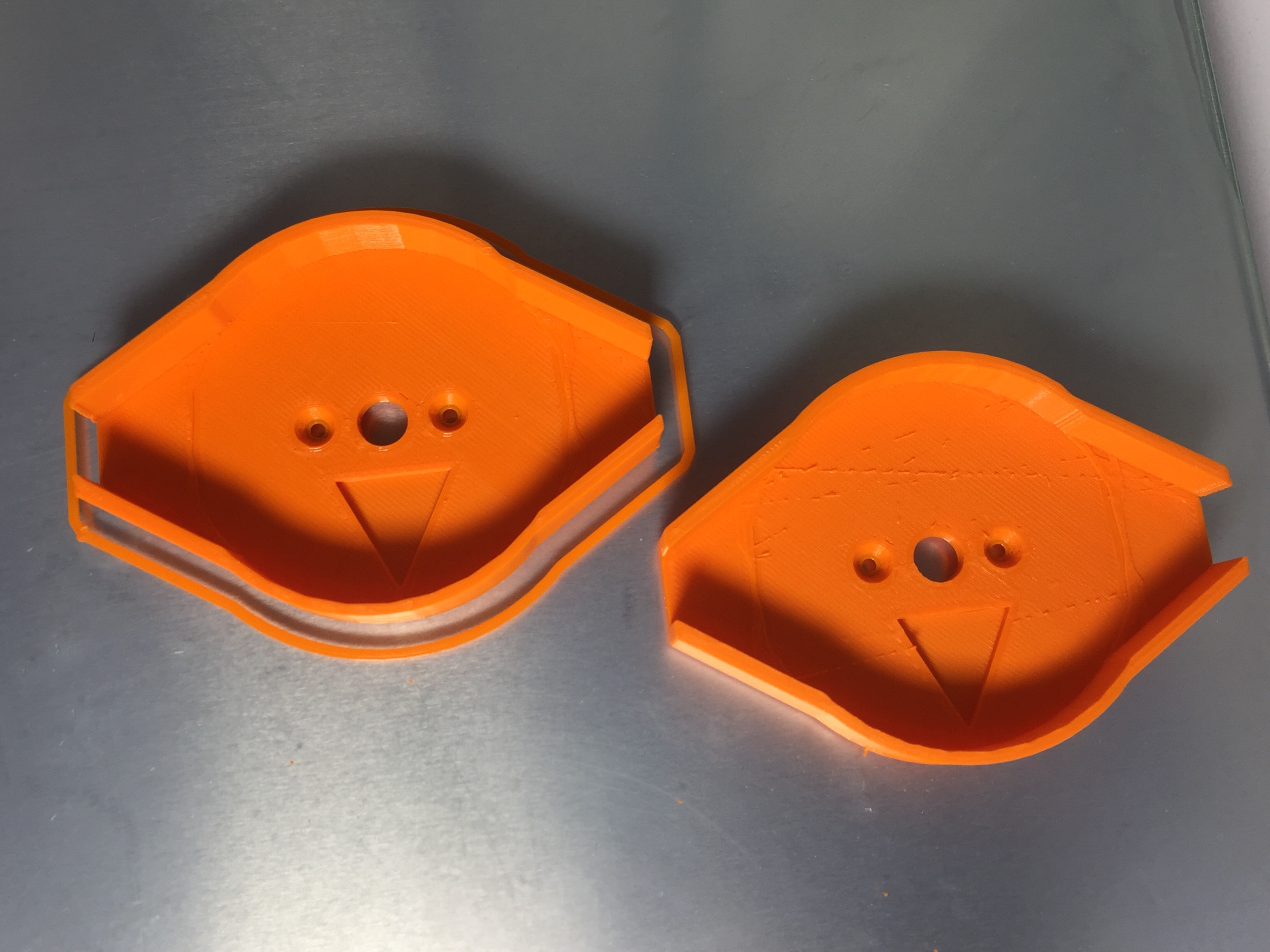

Re: Coast at End
That being unchecked made a difference
New print on left
New print on left
