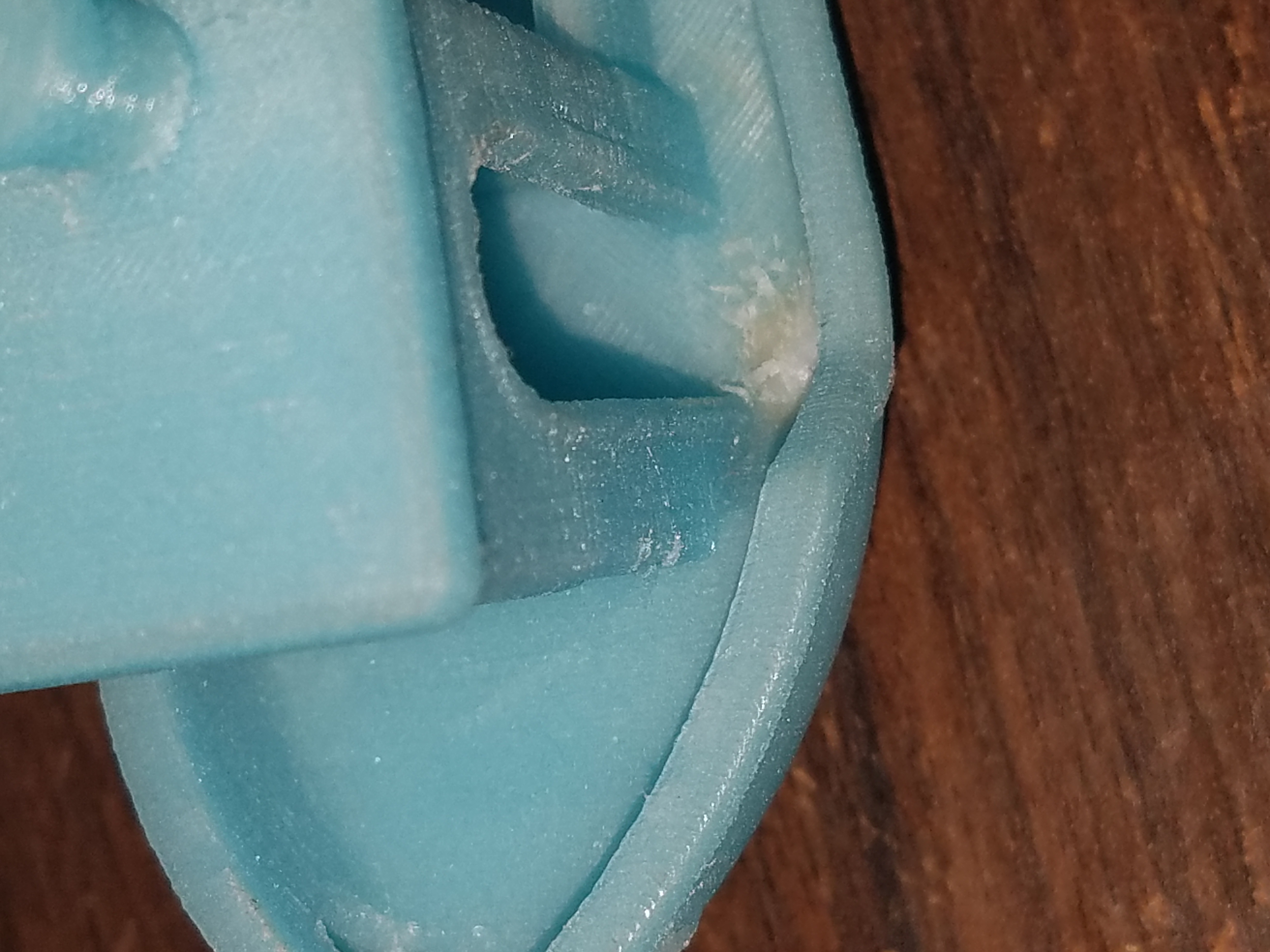

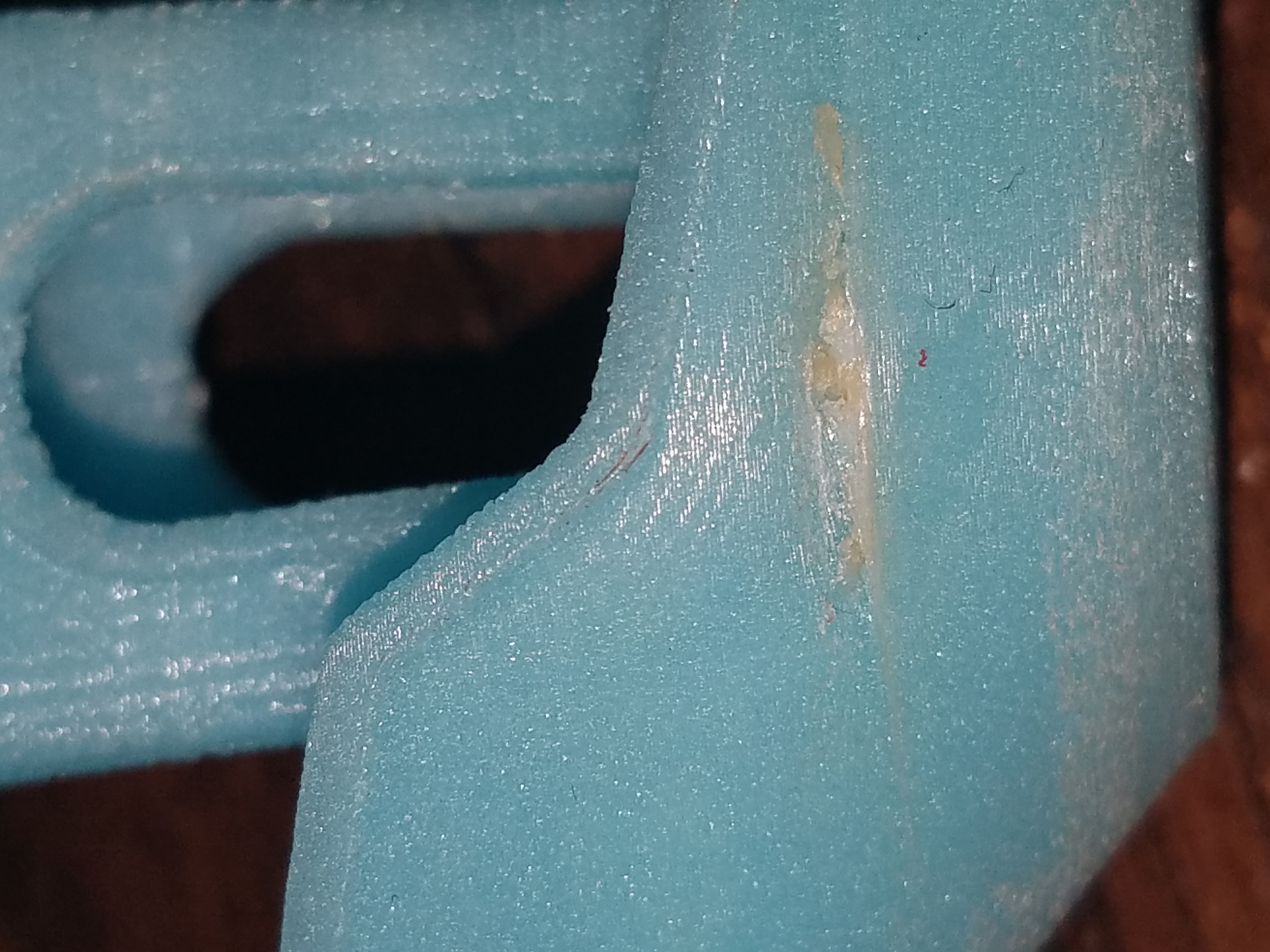

My first 'fun' issue with white pla was after printing spool holders for all of my spools, I switched to Meltink Glow Aqua Blue. As a fun test, I printed 3D Benchy, after manually purging the white until only the new filament came out. Mid print (port main deck near the cabin door), the printer dumped a blob of white that immediately hardened in place before I could yank it with tweezers. The printer kept going, jumping over that section (actually forcing the bed down on the springs) until it was blended in. Now, the deck looks like a seagull flew overhead. It also bled through the side.
