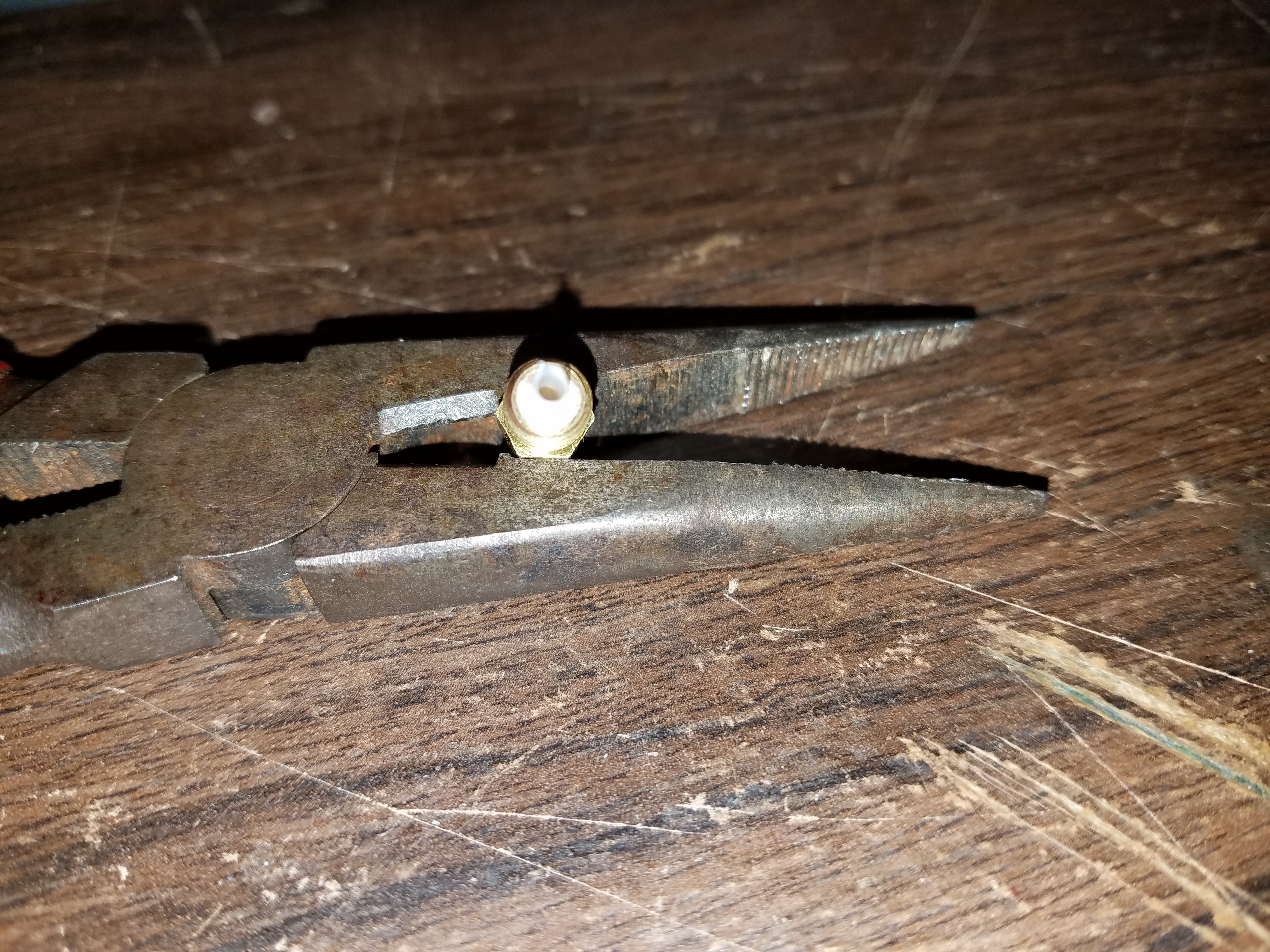

Replaced the extruder assembly, now I am getting filament jams. Weird ones. Had to throw one throat away because the Teflon sleeve actually melted to the PLA. Now I have another that is doing something similar after heating up and extruding some material. This is the brass tip after cooling down and removing. The filament broke trying to pull it out (used the stepper to reverse it out first, then released tension and pulled).
Not sure what is going on here. Been down all week trying to get it back online.

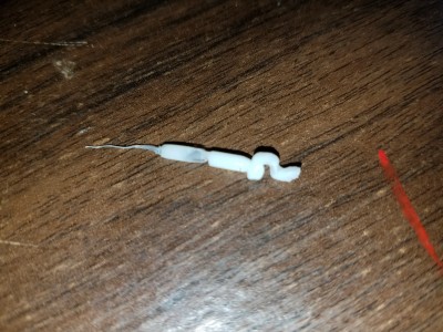

Update: Here is what the filament looks like after disassembling the throat. This was pushed hard against the Teflon sleeve.

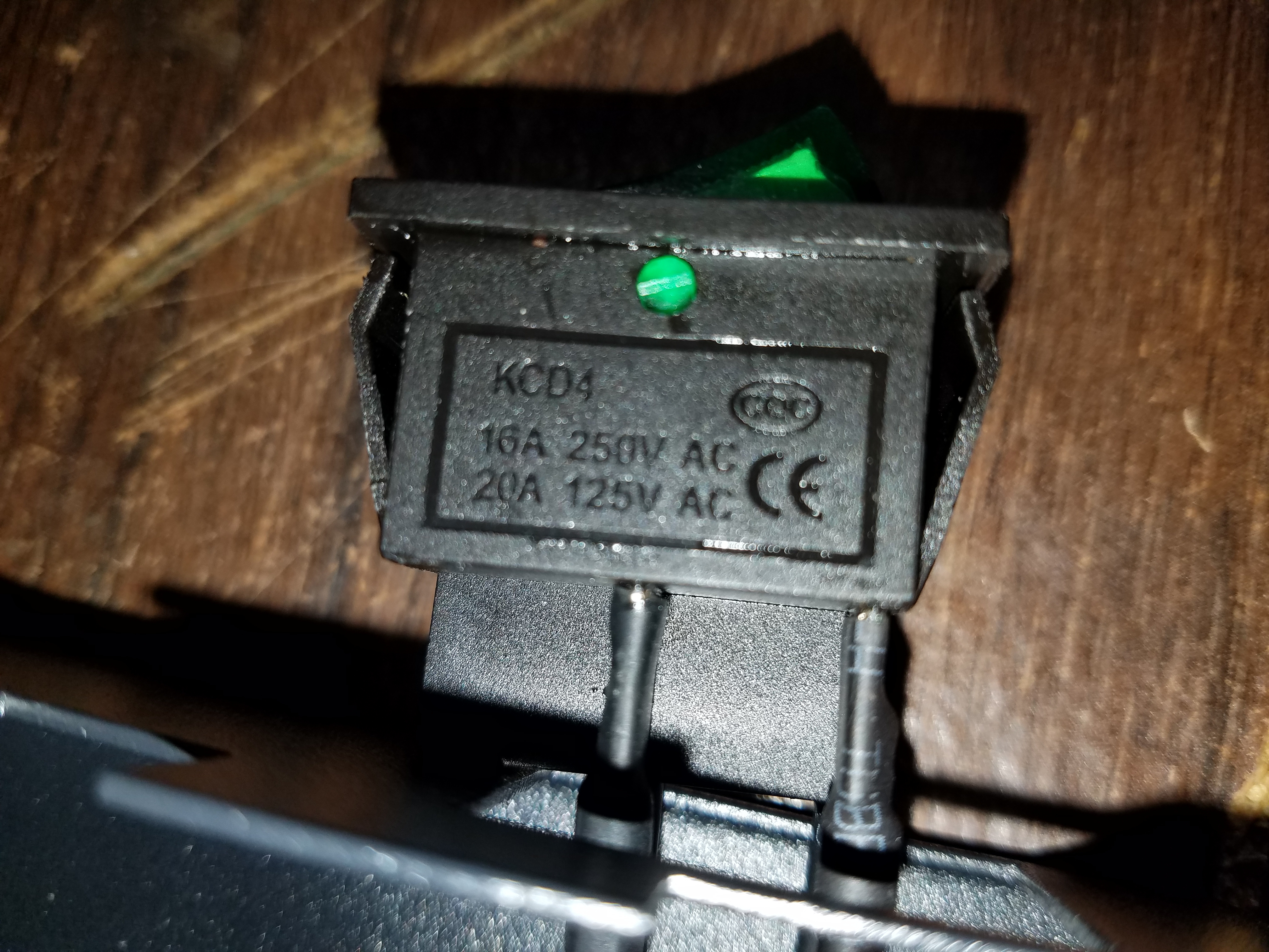

So, replacement board and switch finally arrived. The board is identical to the board I bought last week off Amazon, but different than the original. Either I was given a replacement from old stock, or this is a new rev. The key difference is the SD card slot on the bottom of the control board next to the USB port. It is marked MPK V1. The original is MPX .3. People with systems over a year old may know the difference. I'm guessing that it is from old stock.
The replacement switch is much bigger and beefier. Still an AC switch, but now rated 16A 250v or 20A 125V. Will look up the specs online shortly. I am concerned that they are using an AC switch for DC application. My Principle Engineer said that isn't good (at least on the original switch).
