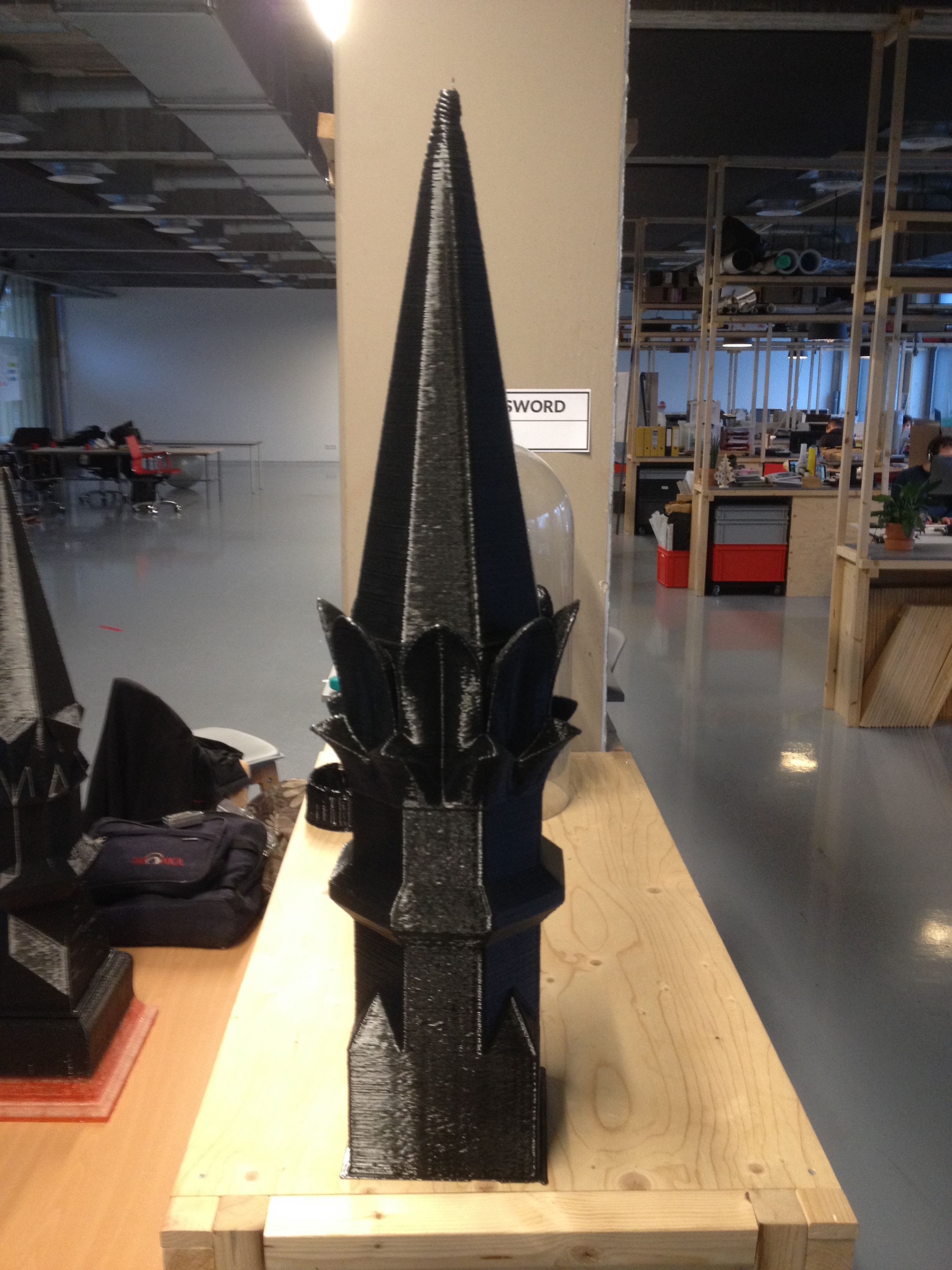

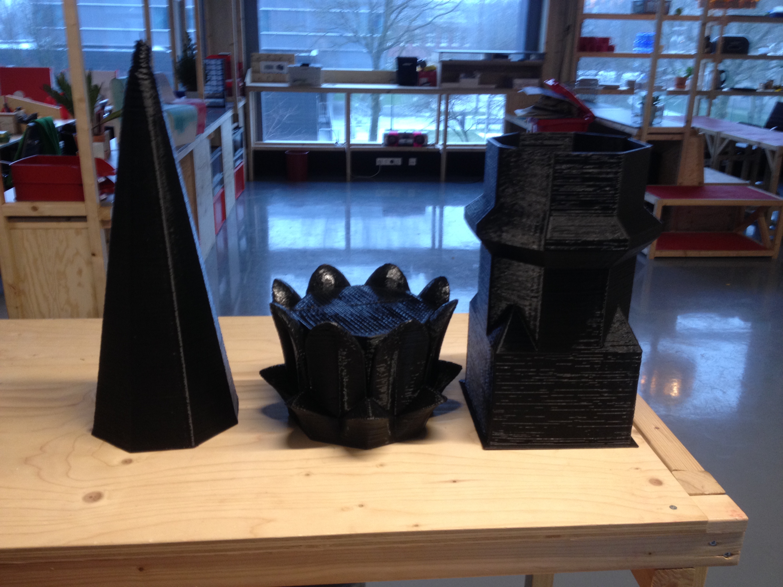

Playing with a 3mtr high WASP delta printer, nozzle dia. 3mm with up cycled PLA pellets. Printsize is 100cm. diameter and 110cm high as max.

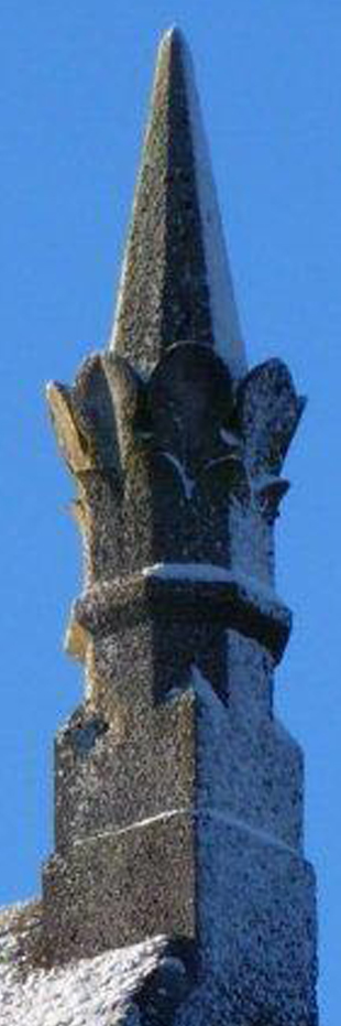

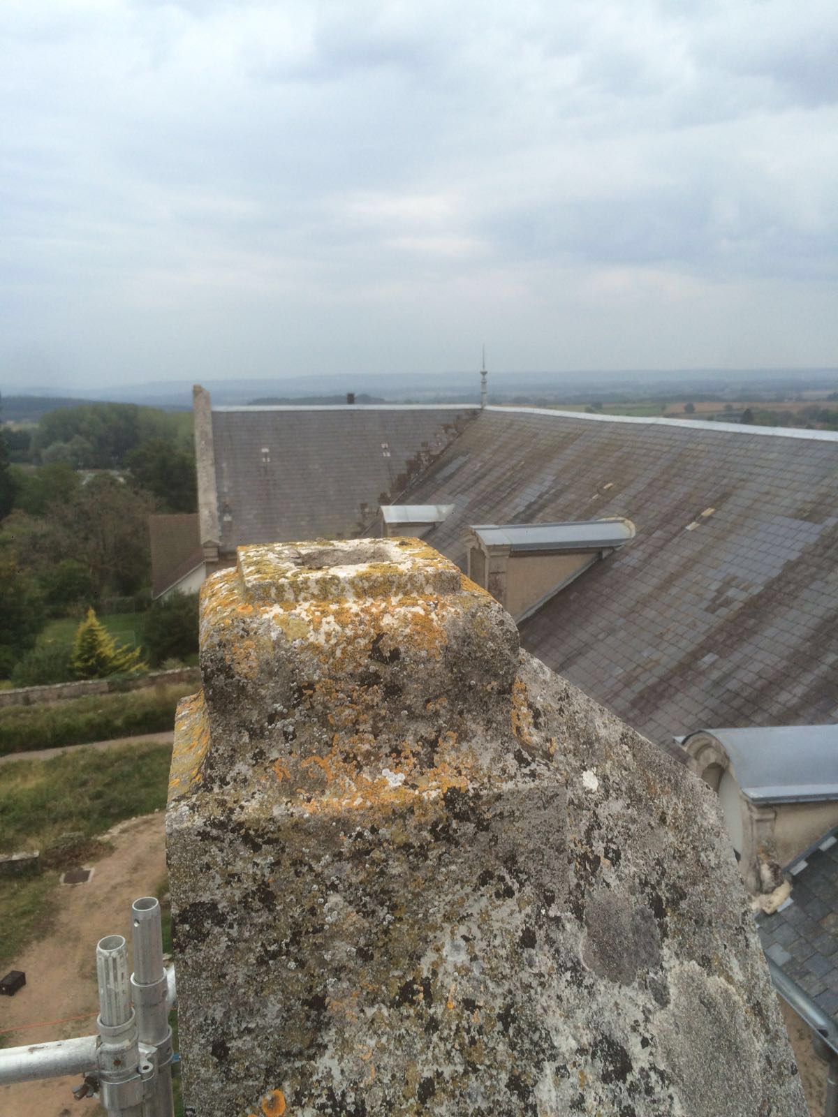

Did a renovation model for a few missing roof towers of an old monastery in France for a friend who is a ceramist and is going to live and work there.
The information I got was the size of the empty spot and photographs of the existing towers, and modeled from there, just guessing the shape/size from the photo.

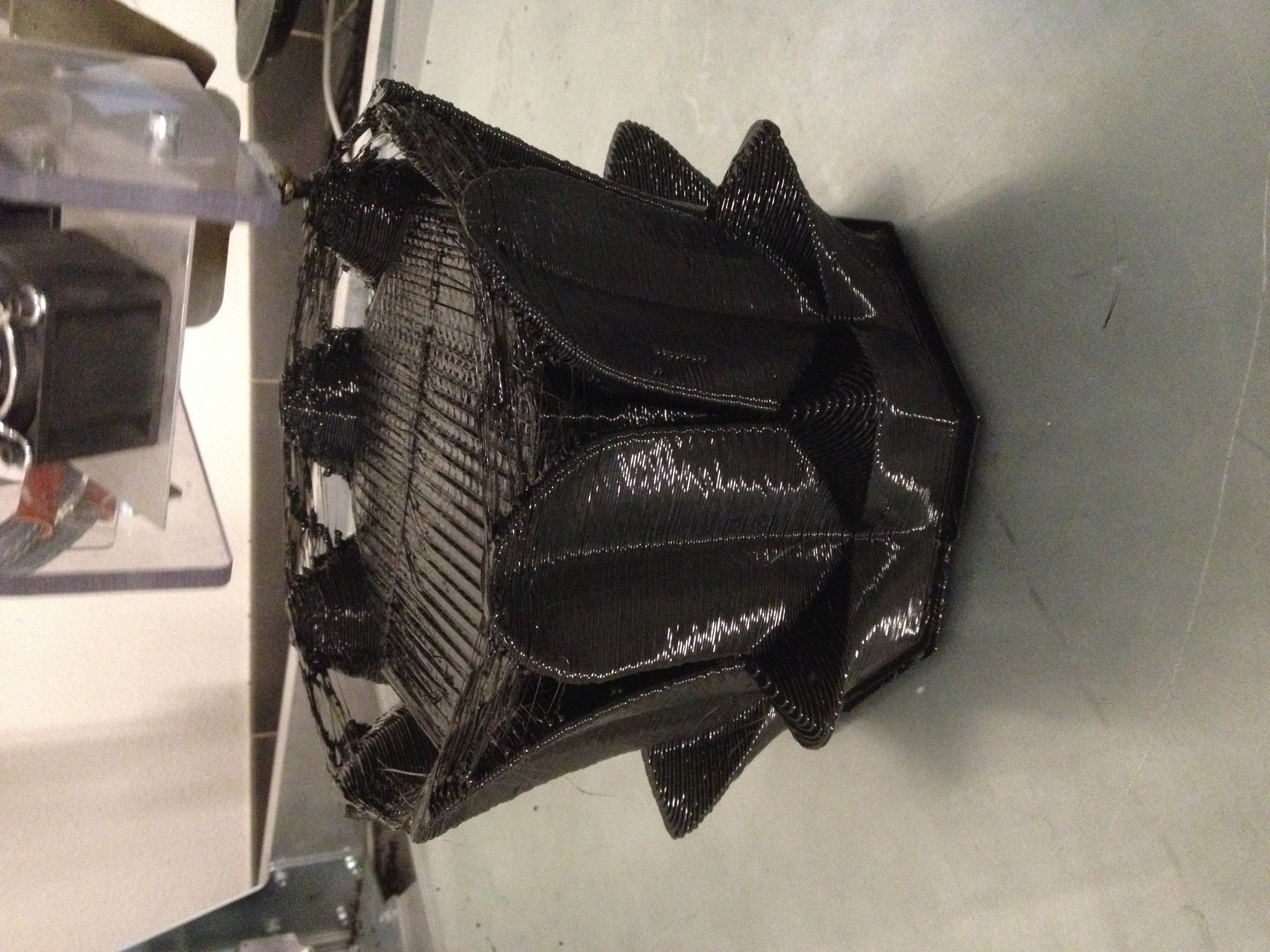

Doing some fun tests as well, not very useful, other then decorative..
It looks a bit like those christmas tree prints. Half the UM office was printing those 2 months ago

@Meduza, yes, it is working well, though you have to take care that there are no big lumps of plastic between the pellets otherwise the extruder skips and you get immediate under extrusion. We did not try to recycle the failed prints (and there are a lot of them) only the pellets that we got. This beast has a heated bed of 100cm diameter, 70 degrees, otherwise the longer prints start shifting, although the print itself is pretty heavy. We spent a lot of time calibrating the thing because the settings they delivered it with did not work. Prints came out too big and when the nozzle was on the glass in the middle, it was 1cm above on the outer circle. But this we got sorted out and now the prints start ok.
Another thing is that retraction is not there, there is no wire to pull, it is a constant flow of plastic. When it is traveling the nozzle oozes and there is no way to stop a 3mm nozzle to do this. So you see a lot of spiralize shapes coming out of the printer or you have to do a lot of cleanup.
