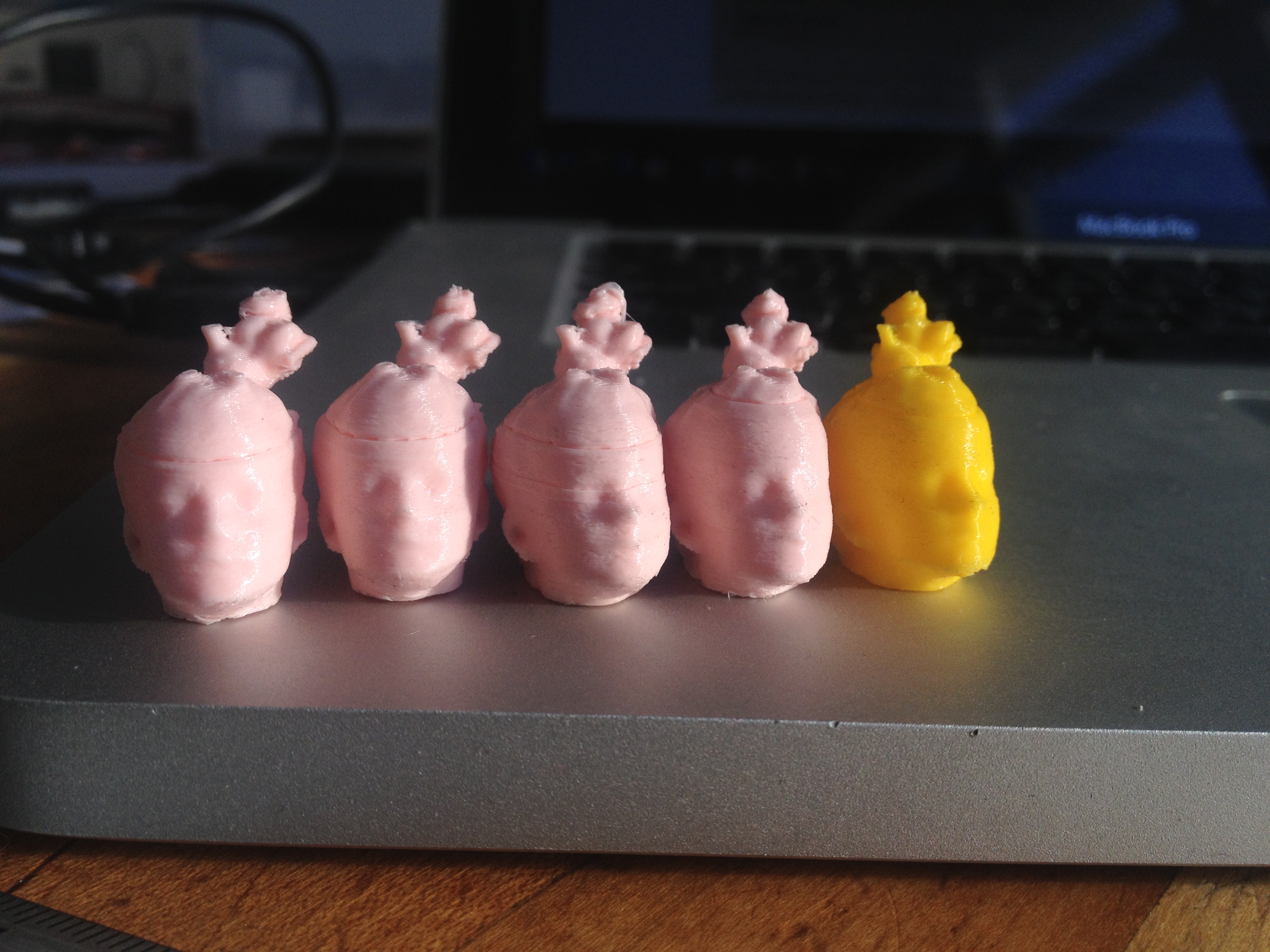

I found it difficult to diagnose the bearings by printing on this machine, surprisingly.
Somehow it appears that all the shaking when printing makes the bearings less likely to stick, I think that 90% of the prints still came out fine with those bearings in the video (!).
