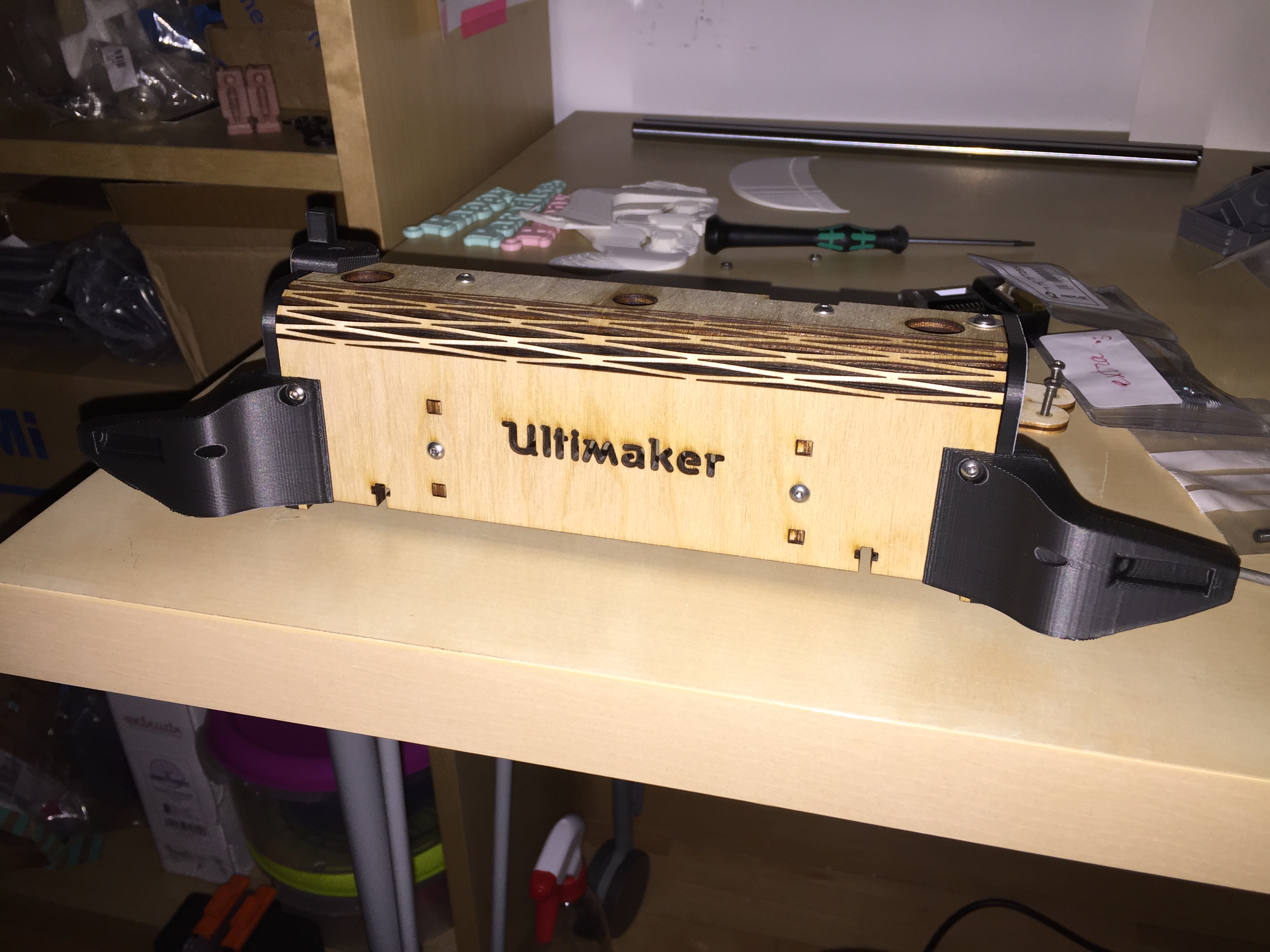

This is what I made for umo+ for Gudo mod
I'm very busy this week specially with a cold and being half time on bed, so I will probably upload it this weekend.

Re: Z-axix linear bearings
This looks interesting Neotko, I also saw in another post (the one about removing pla prints with window cleaner) that you printed a replacement part in PLA for the remaining wooden part of the Z cover. Do you have a link to that design too?Neotko wrote:This is what I made for umo+ for Gudo mod
As I made my own HBK (but it's basically the same as the UMO+ just with chinese parts) I don't have the wooden pieces and would need to print it all.
