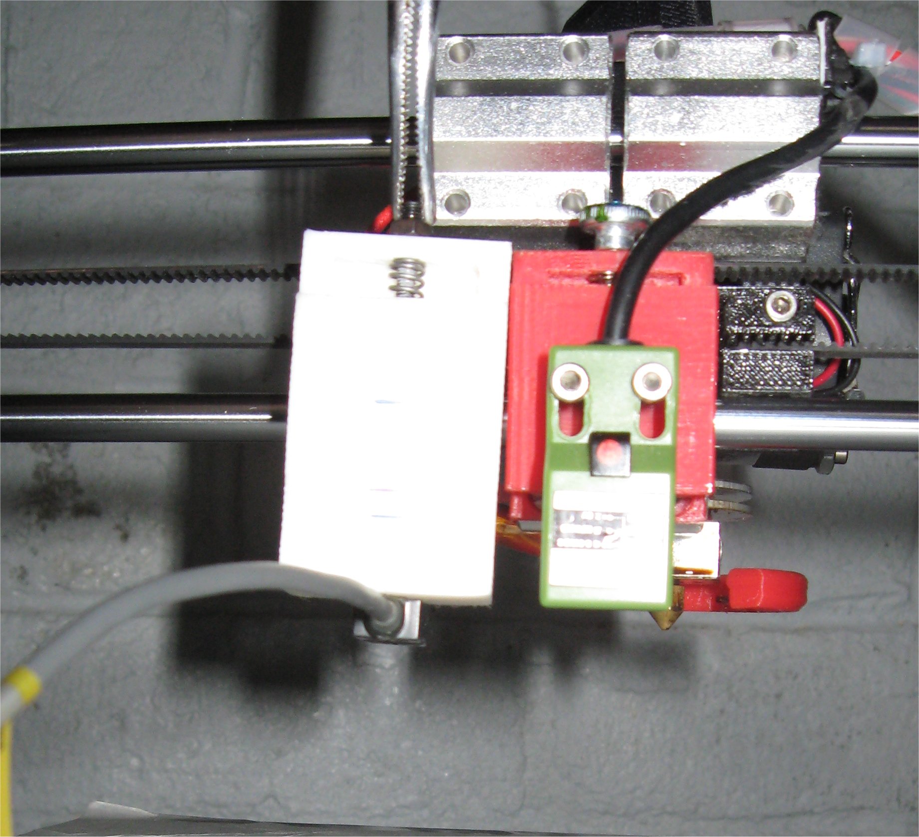

Re: [SOLVED] - HICTOP I3 CALIBRATION ISSUE
Can you post pictures of your new mount in action? I downloaded the STL files and want to compare them with two I found on Thingiverse.
- Posts: 1481
Have not mounted it yet, but I took a Picture Of what I have (New Mount is White).GrueMaster wrote:Can you post pictures of your new mount in action? I downloaded the STL files and want to compare them with two I found on Thingiverse.
You can see that the New sensor will have a closer proximity to the nozzle.
Please Note: that the signal for the TL-W3M (NC Contacts) needs to not be inverted (false) in the software.
Where the software for the SN-04N (NO Contacts) is inverted (true).
Have tested the sensor having a 3mm detection should work after calibrating the sensor height.
After Adjustments and calculating center of the sensor will be behind 15mm.
NOTE: This is a thingiverse Mount I modified by henryarnold
