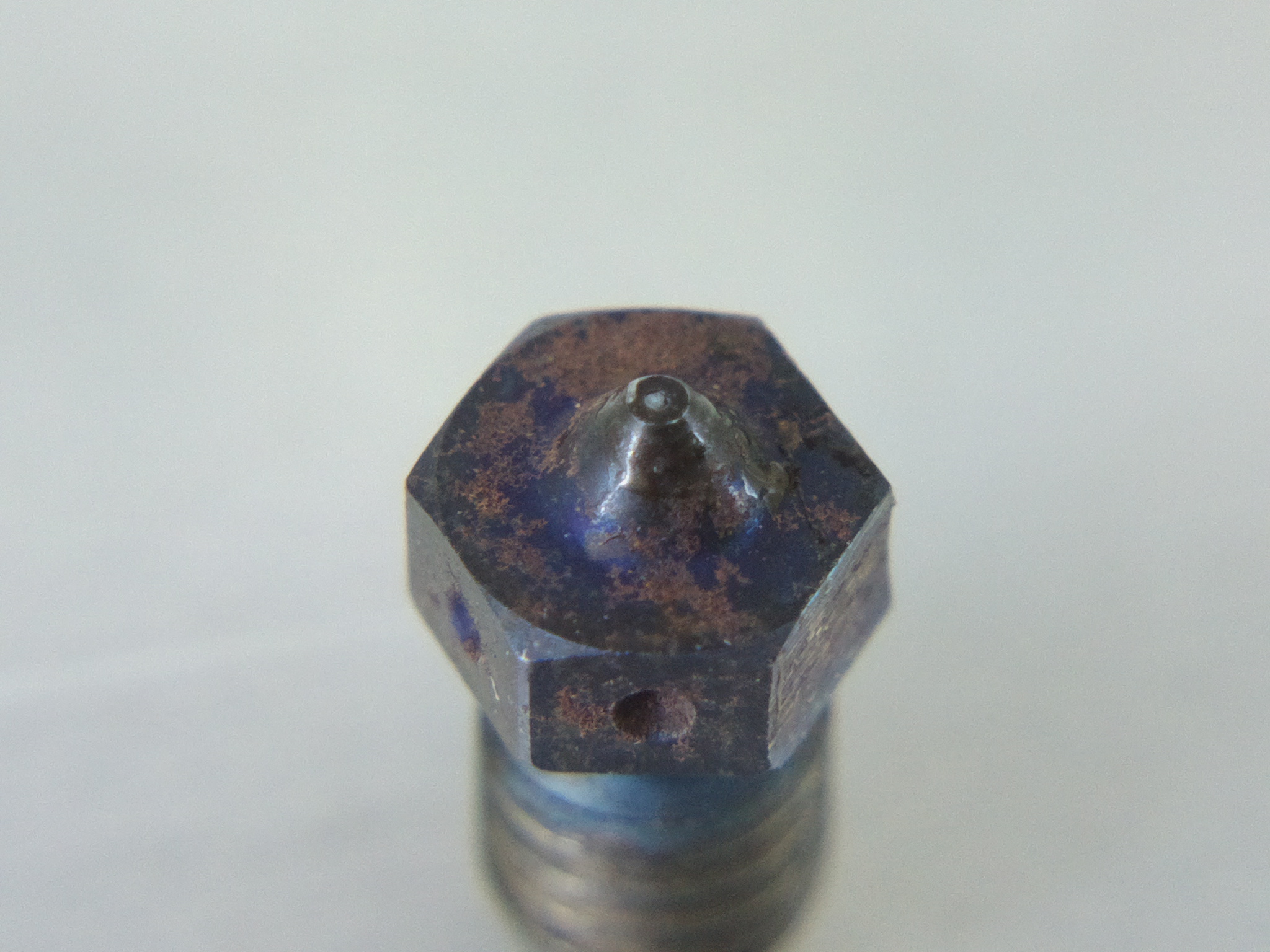

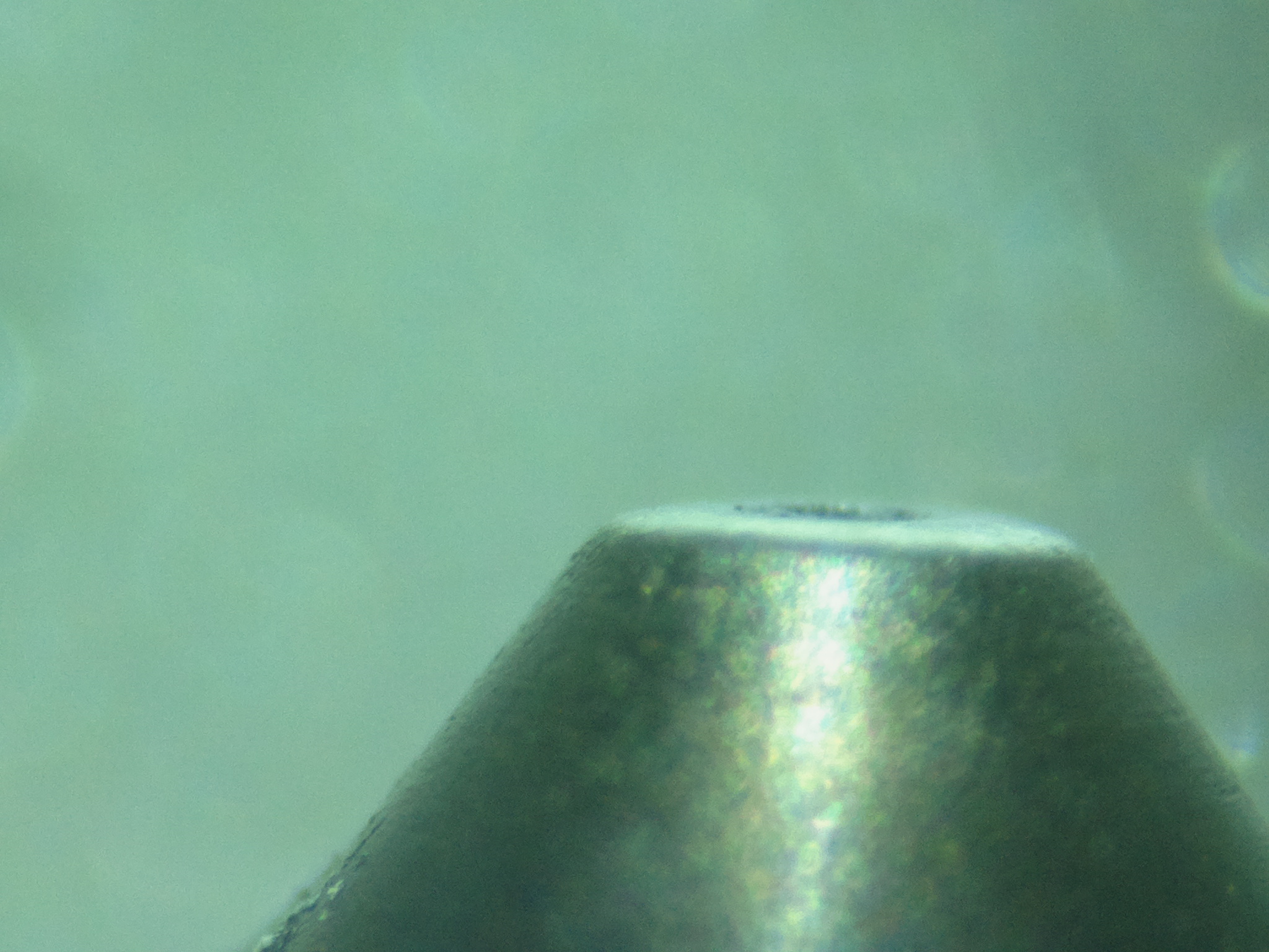

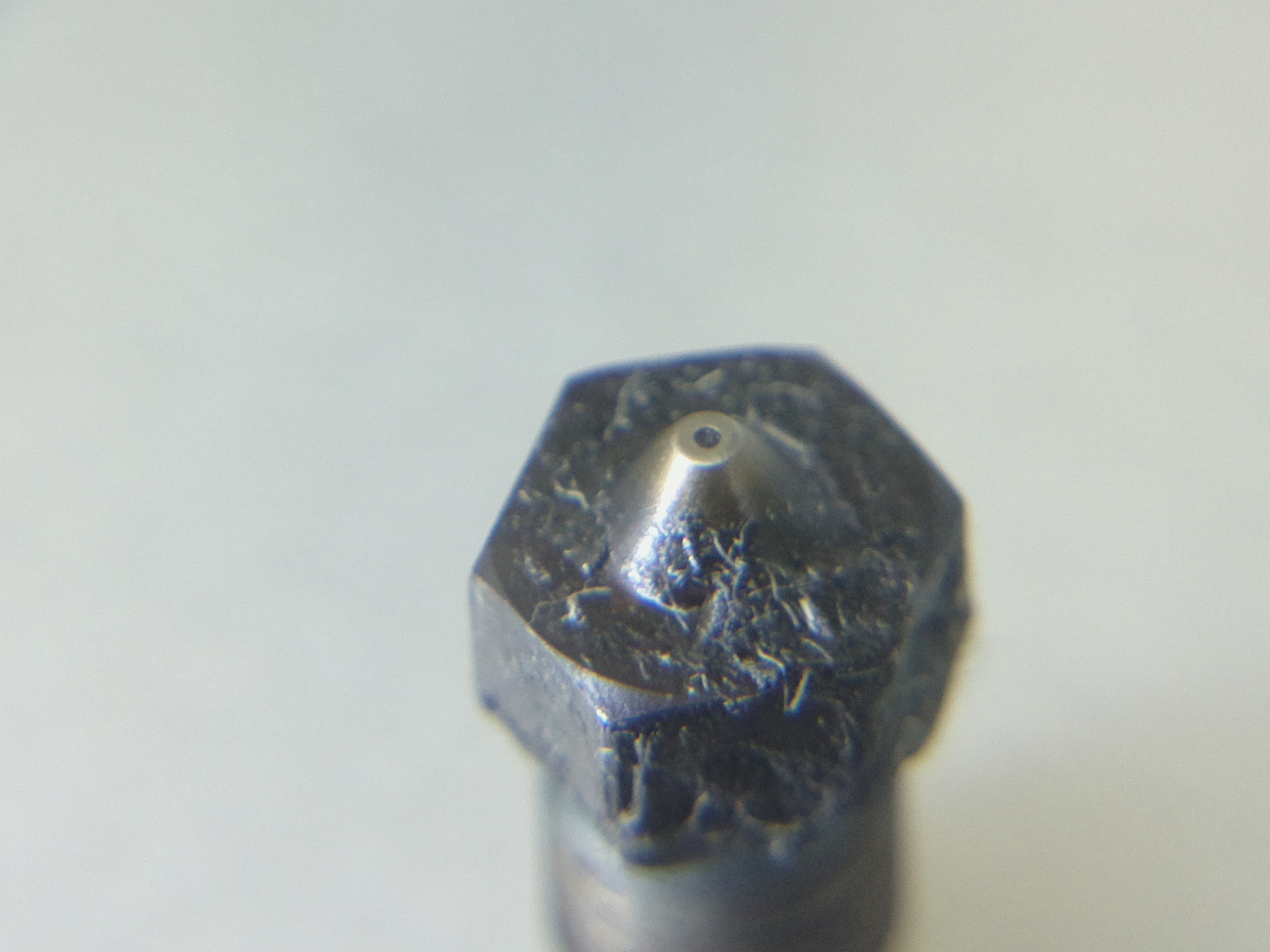

As and example, E3D claims that their hardened nozzles will basically not wear with XT-CF20, showing no observable wear after printing 250 grams, or even after 2,5 kg of various carbon filled filaments: http://e3d-online.com/is-carbon-killing-your-nozzle
Users tells me the opposite though, like roboduck who says he sees signs of wear already after 1-1.5 spools of XT-CF20: http://3dprintingforum.us/viewtopic.php ... 1630#p1630
I tested it myself the other day.
From basic testing, (which I assume that E3D has done) I know that wear from carbon filled filament depends a lot on what you print, so I selected one of the most downloaded models at thingiverse (a Millenium Falcon) and used normal quality settings in Cura.
After 24 hours and just 70 grams of XT-CF20 it is already obvious that the tip of the nozzle is getting rounder (!).
Before: (Yes, the hardened nozzle rusts if stored in humid environments)
After: I find this to be a big challenge, how are we going to open up new markets and attract new groups of customers who has money but demands properly working technology when there is this mix of products and when even the large players sells things based on claims that are questionable?
