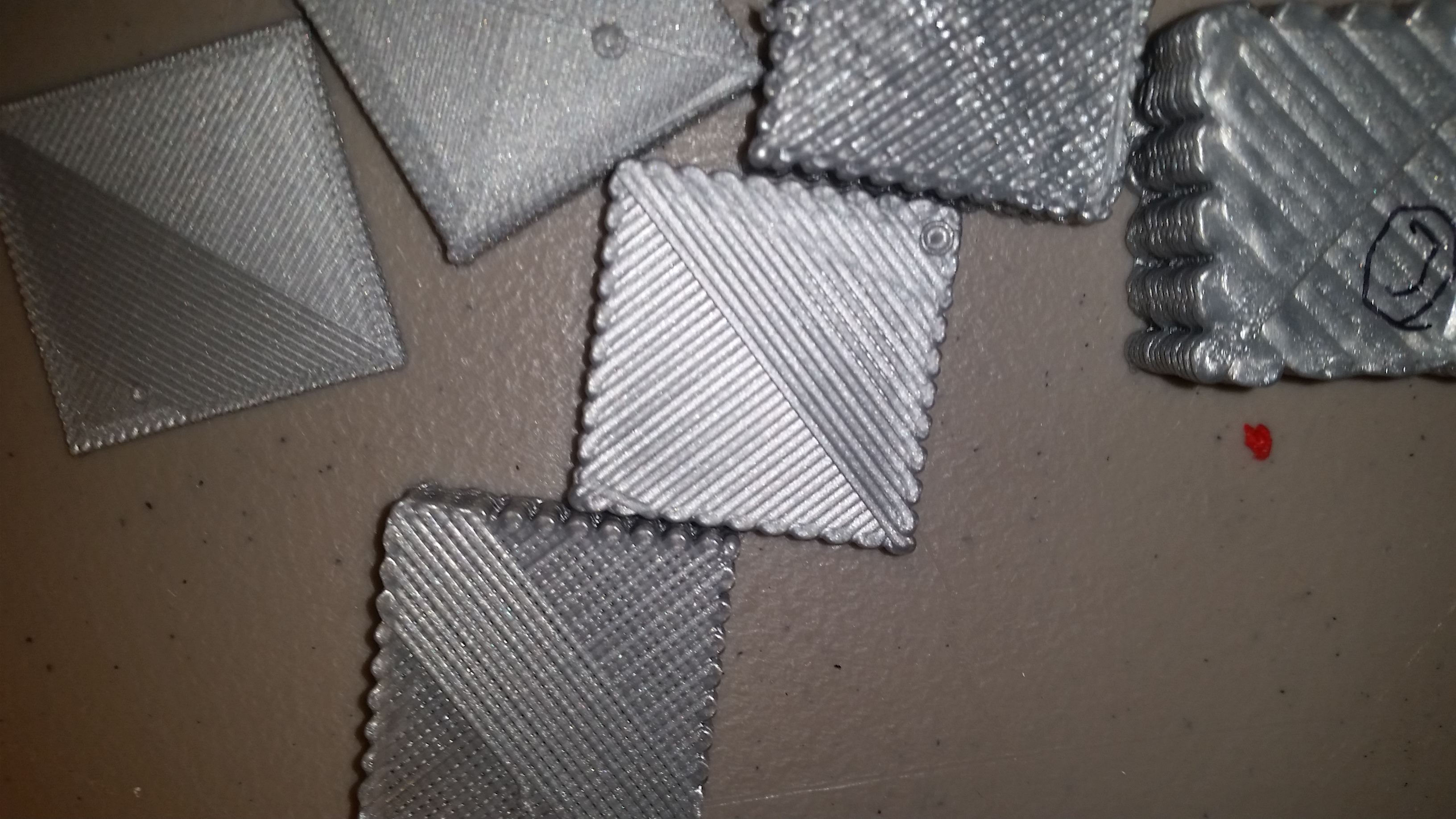

Here's an old example. I have dozens of these cubes. This one was for the old black feeder that skips. But for the new feeder it's trickier - you have to look very carefully at gaps between the lines as it doesn't do sudden major skips but instead does underextrusion (filament slipping 10% or so in feeder)
I have newer photos if you want to see. I also have a bunch of these "cubes" sitting around.

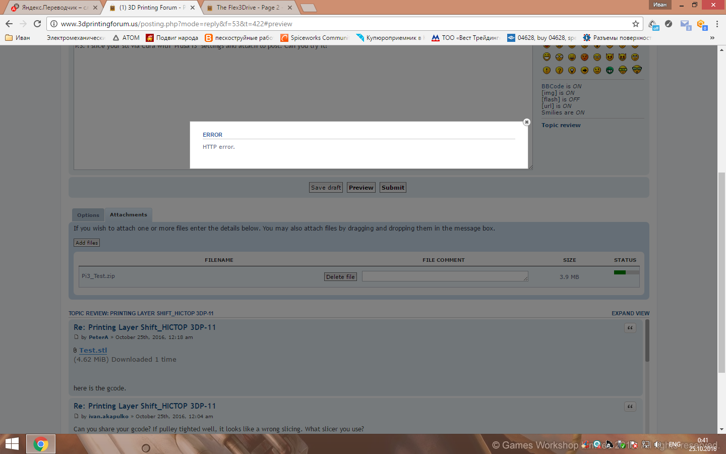

LePaul wrote:Side note...added ability to attach .gcode and .stl
But still forum engine cannot upload large stl and gcode files. Can you remove this limitations?
Posts: 4077
Re: The Flex3Drive
How large do we need?
I set it at 25mb
ivan.akapulko
Posts: 390
Re: The Flex3Drive
Post by ivan.akapulko »
Just about couple minutes before was trying to upload 14 mb gcode file, and forum engine told that is too big. Then i zipped it, and 4.35 mb upload smootly. 25 is enough, i think. In any case, for extraordinary situations we can use some cloud like Dropbox.

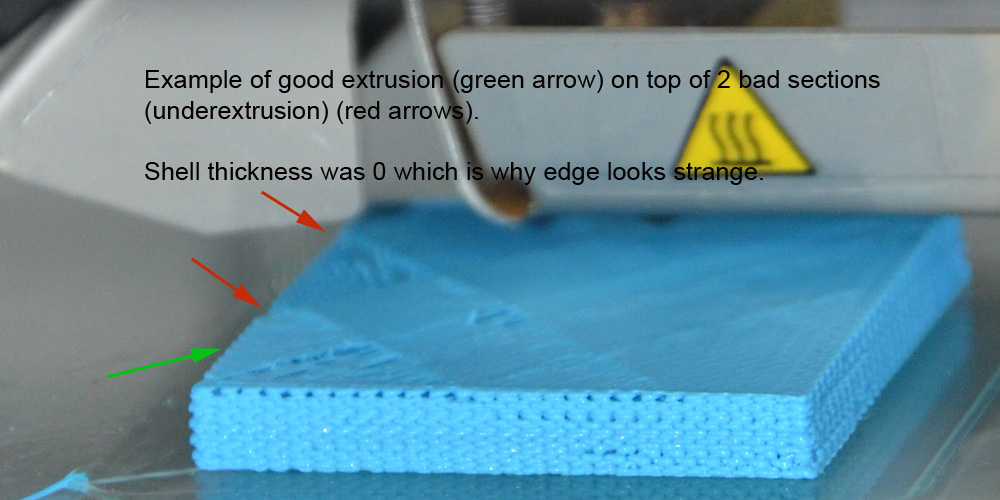

Here are a few test "cubes". On the top row 2nd from left is .4mm nozzle. Also here are .8 1mm 1.5mm and 2mm nozzles I believe. The center most square you can see about 20% underextrusion on the upper right corner/half. But the layer below is pretty good. The bottom most square has pretty severe underextrusion but still good enough to look great on a test cylinder - maybe around 30% underextrusion (30% gap, 70% fill).
When actually testing it takes seconds to change the speed and examine the print. Within a few minutes you know EXACTLY where underextrusion starts, and how much flow rate to add to fix it. Then you can test at a second and third temperature. So you get several results in the same time it takes to make one cylinder. You just have to take good notes.
