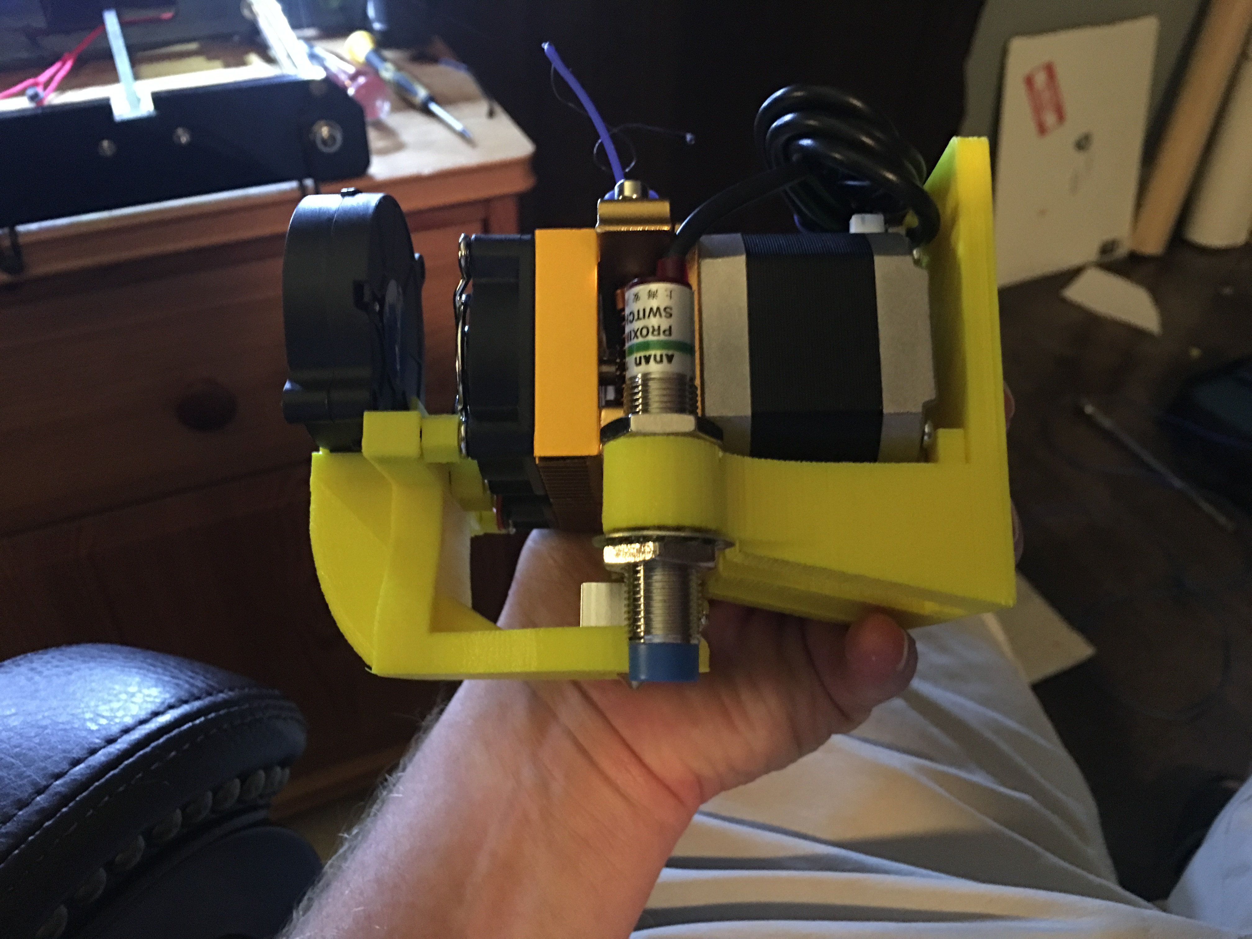

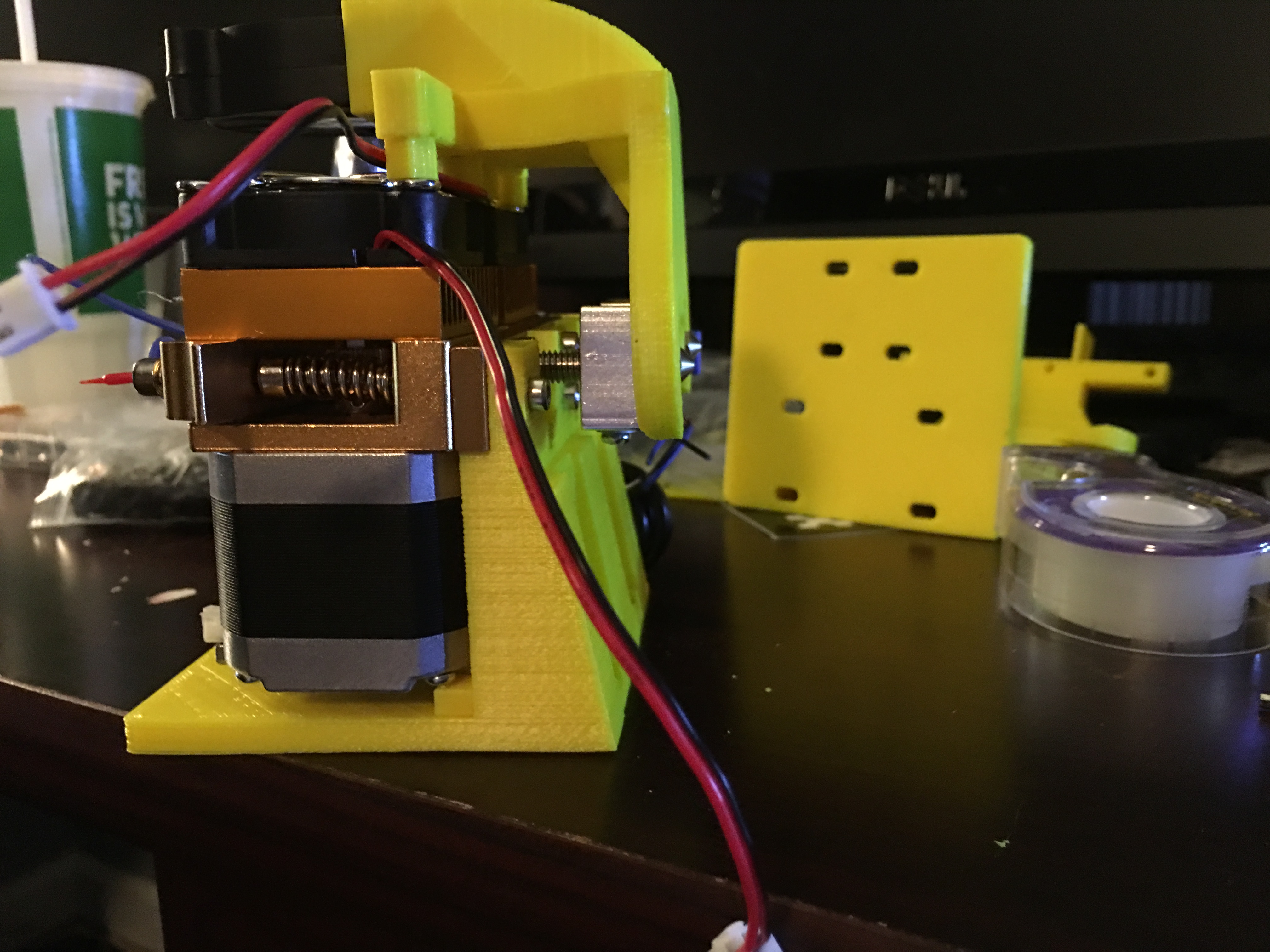

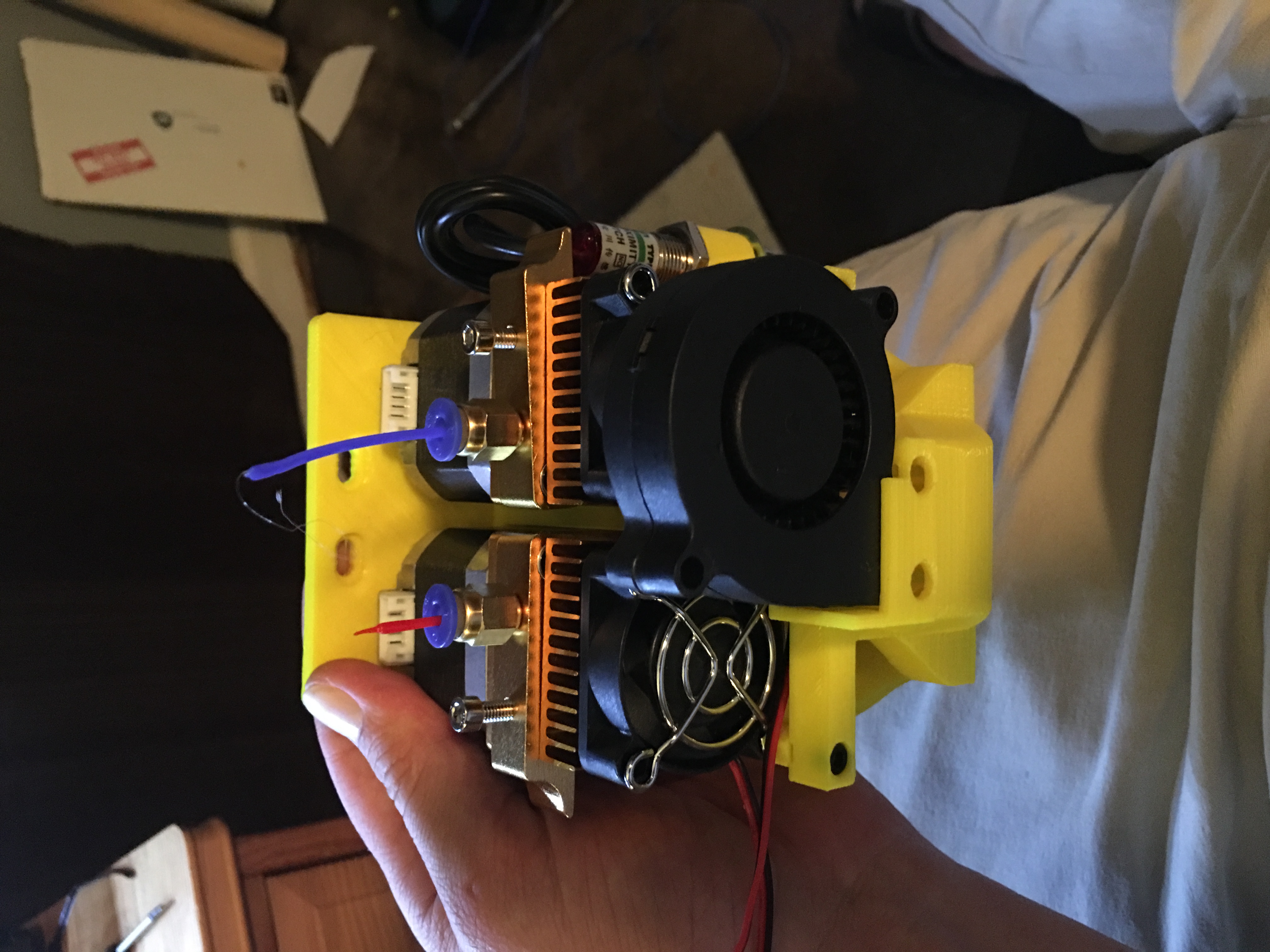

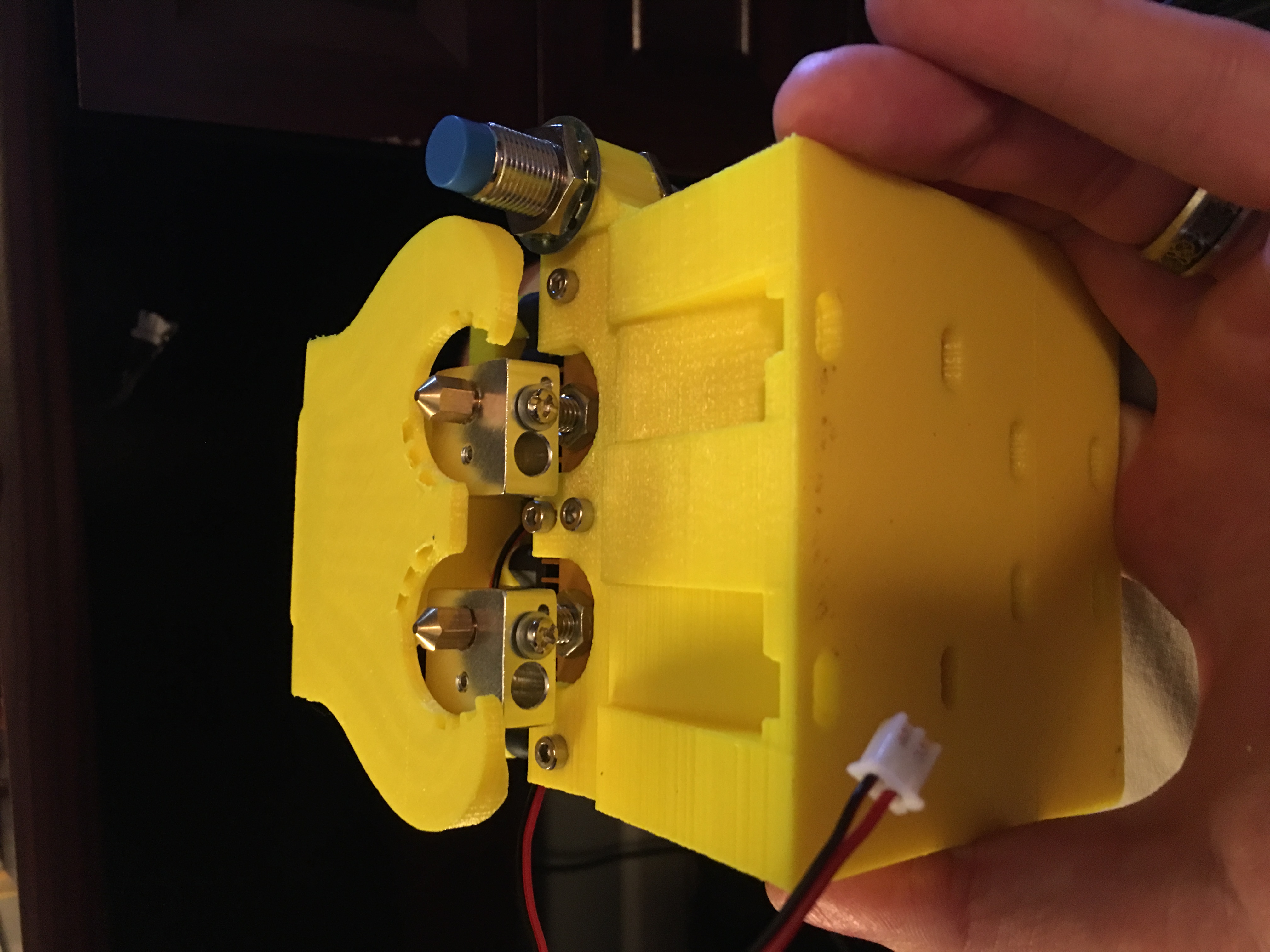

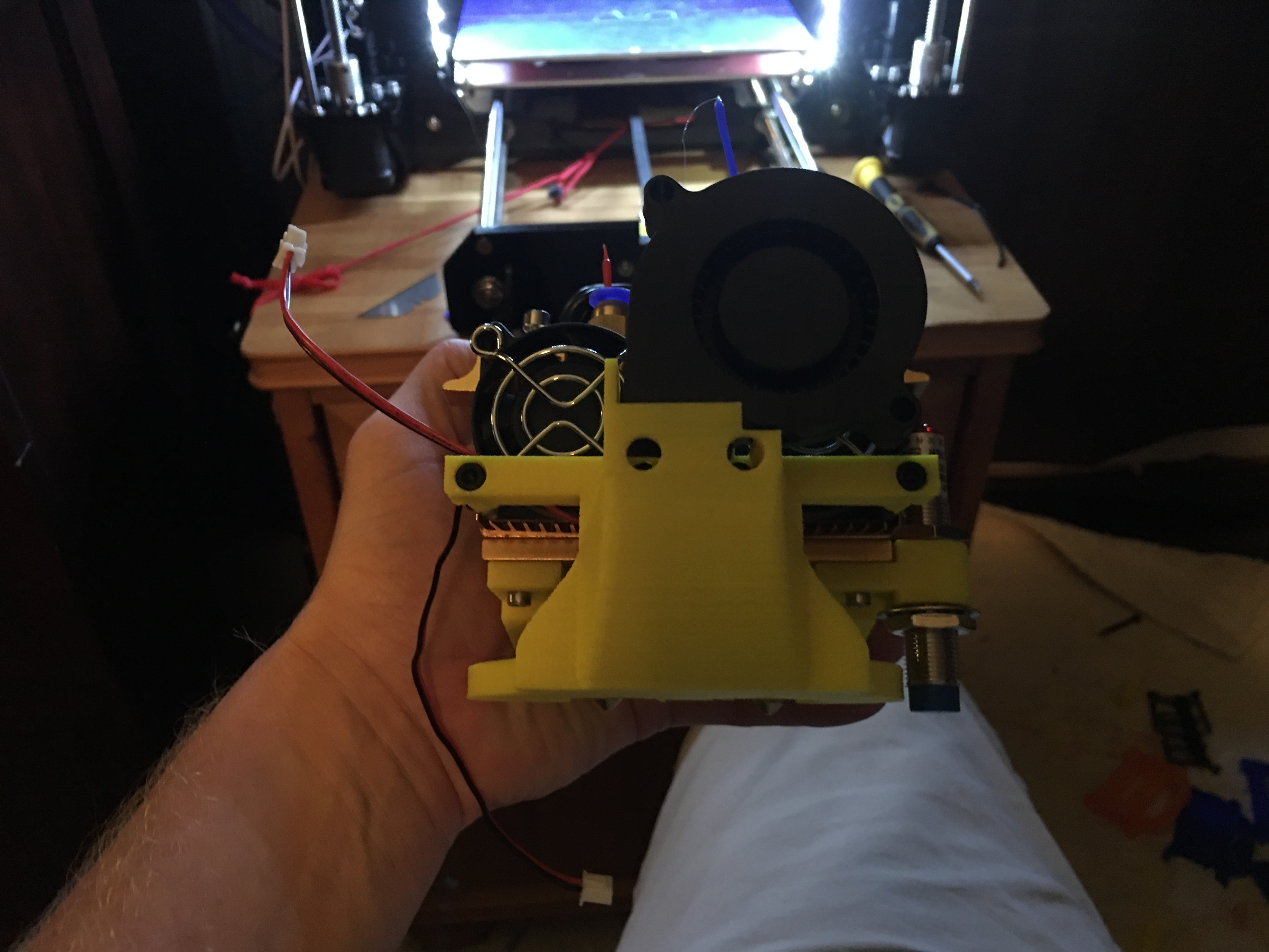

Hello Everyone,
I am currently working on a dual extruder setup for my Hictop Migbot Prusa i3 Plexiglas running Marlin 1.1 RC6.
Have any of you done this or know of someone who has and can point me to them?
I have questions on the firmware setup and what is needed. Cannot find clear information on how to set EXTRUDER_OFFSET_X and EXTRUDER_OFFSET_Y with this setup and how to add PID settings for second extruder.
Thank you in advance for your help!
