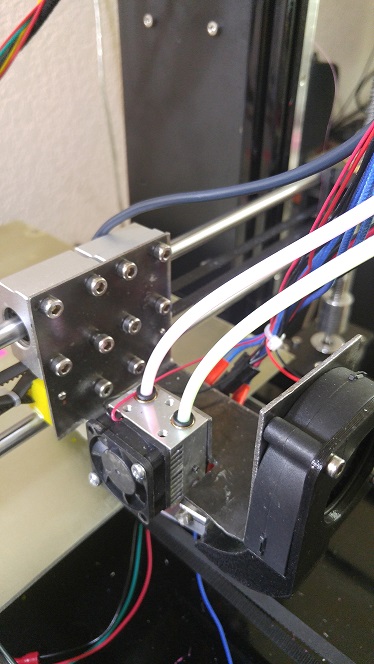

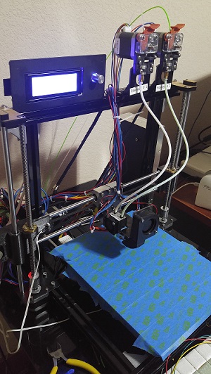

After getting the shipped HICTOP printer working well, with much thanks to Chip, I worked on getting dual extrusion using the Chimera from E3D Online. Many attempts at a 3D Printed Mount to adjust my design (have a colleague who also has a 3D printer, so I didn't have to keep taking apart mine), I got a good design only to find it warped when I heated up the extruders. After 5 weeks of waiting on the fab shop, I got a metal x-carriage, and now have the dual extrusion working. I still need to tweak a bunch of settings (using Marlin 1.1.0-RC6), but the dual extruder test cross shows the head alignment is good. Found a nice picture showing the pin designations for the MKS v1.4 so I could power both hot ends and the cooling fan. Changed to Bowden extruders to make the implementation easier.

Update. Got the heads as close to level as I can get. Printing good quality. New PID settings for new hot ends and new temp settings for hot ends for the thermistors that come with the chimera. Here's a closer picture of the x-carriage mount.

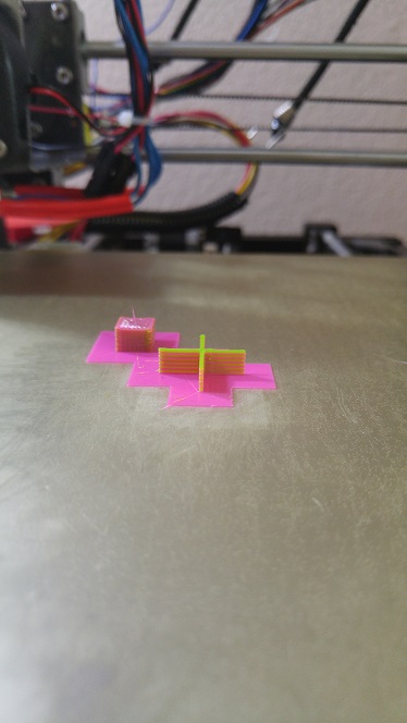

Recommend the Dual Extruder Calibration Cross .4 mm nozzle if going to Dual Extrusion with 0.4 mm nozzle.
http://www.thingiverse.com/thing:1023194
Here's a picture after a few changes to the X offset in the firmware. Apparently my x-carriage puts the nozzles about 0.3 mm of in the x direction. Still using 18 mm on the y.
